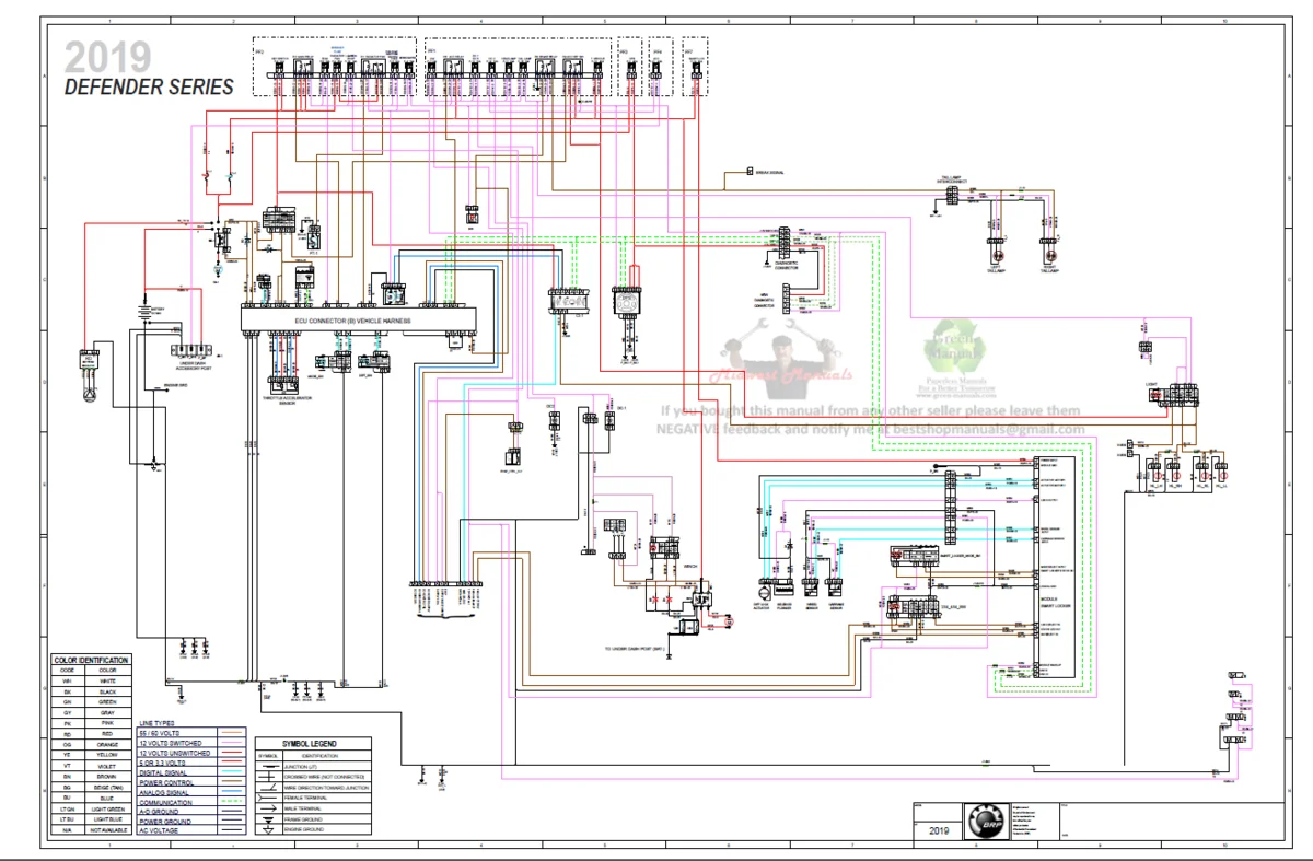

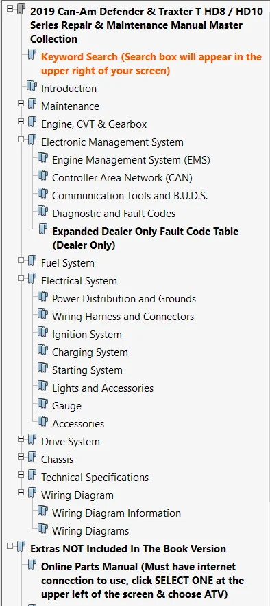

From what I can gather so far we as owners can only pull active codes, not inactive codes - those have to be done at the dealer, I had a check engine light flash for half a second this winter and could not get a code, when I brought it to the dealer they plugged it in and pulled the code for me. On another note SilverPeakAdventure, does this electronic service manual have electrical wiring diagrams?
YES! Here is a snip of the Table of contents. and one of the diagrams so you can see how they come up!
