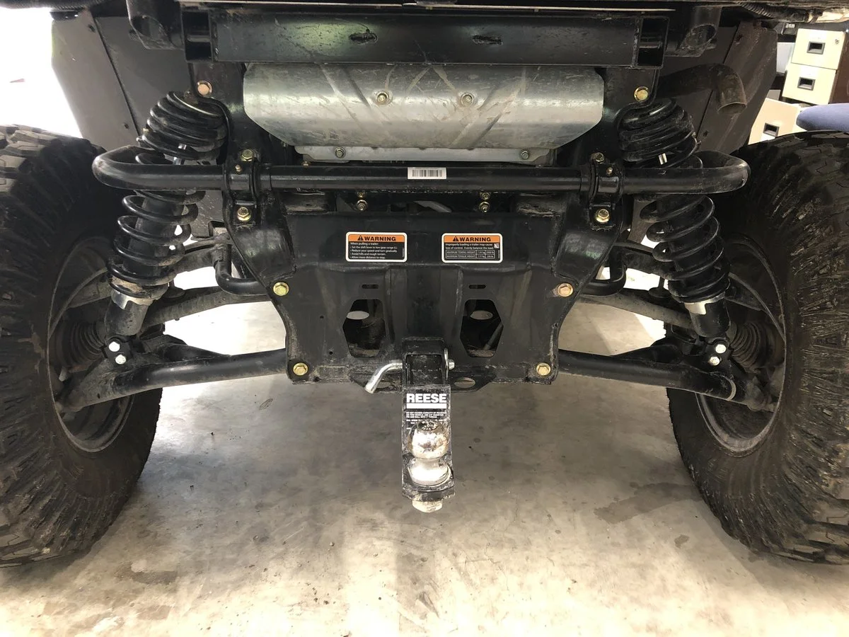

Forward arms gives you more clearance to fit larger tire and does not add more stress to CV angle ....just another option for you
DefenderXMR is right with the forward arms itll clear 30s and a few brands are priced pretty good ... if u want to go to 30s its definitely the best route ... but if cheapest route is what ur looking for 28s bone stock is great... and ur not adding much weight per tire and will work perfect with stock clutching.. 30s puts u in an area of possibly needing clutching some get away with it but others dont like the touch of power loss from the added tire weight and rotation and seek clutching to get the bikes stock or touch over stock power back

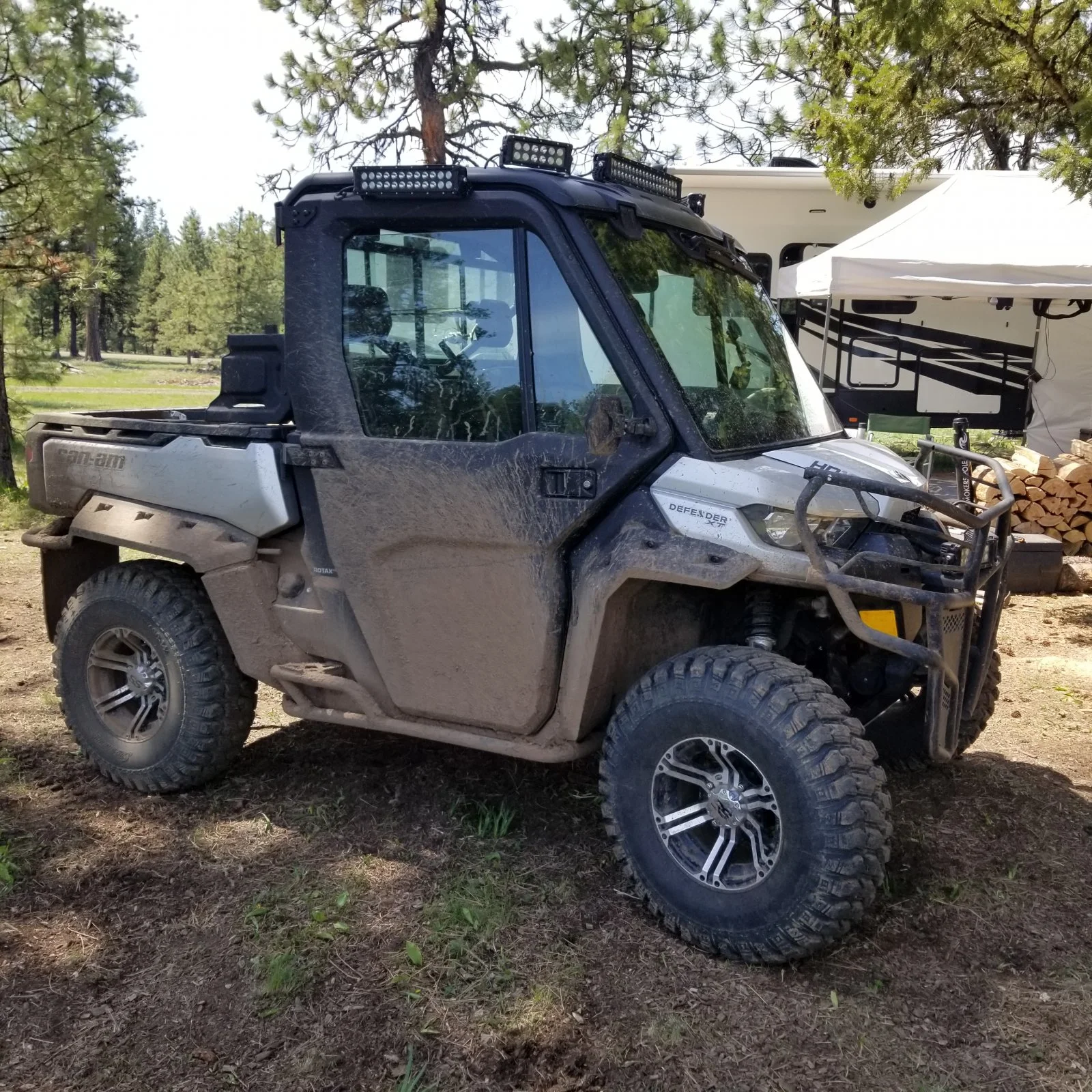

I put the battle armor 2" lift on mine with no issues. Pump up you preloads all the way and you'll get 3 inches of lift. I also installed 2" spacers on all four corners to bring the wheels out past the stock stance. Took it trail riding in northern Michigan and it handled great. Went almost 100 miles that day and had no issues. Looking at 30" maxxis carnivores on beadlocks for my next upgrade.

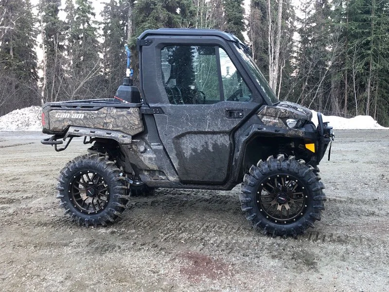

Hello,Im new to this forum. This is Brutus. 2019 defender xmr. I put a 3 inch lift via shock pucks and added 33 inch system 3 tires on 18 inch wheels. I haven't tested the rig yet, but will tomorrow. The pucks made the preload stronger for the lift and has a notable stiffer ride, but I'm a creeper kinda guy anyway. Im wondering if anyone else has made  lift mods and what issues may arise. I am concerned about clutching but these tires are 20 plus lbs each lighter than my stock 30's  and hope the weight difference will offset the torque difference. I do plan to switch tires back and forth depending on trail needs. I also run tracks in the winter up here in Alaska. The full cab and a great heater makes this possible.

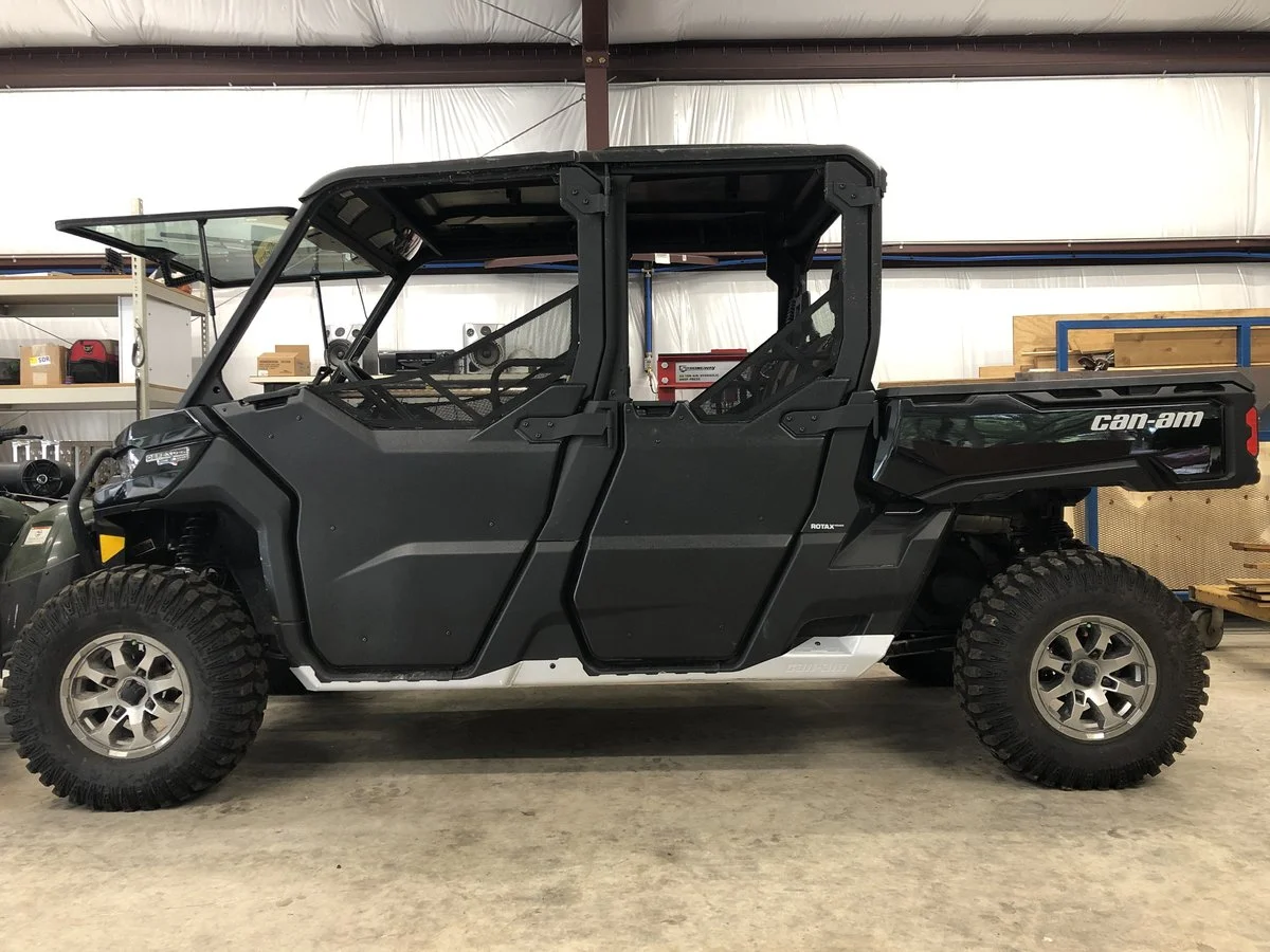

I  have a 2020 can am defender Max xt hd10 and I put 30" rock a Billy tires on it stock with plenty of room to spare

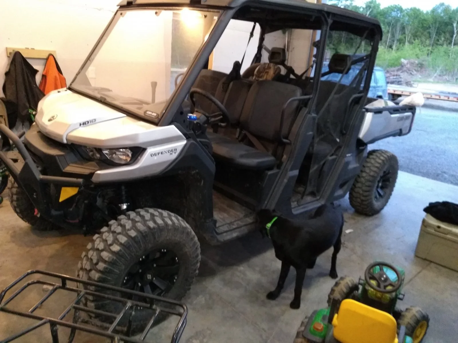

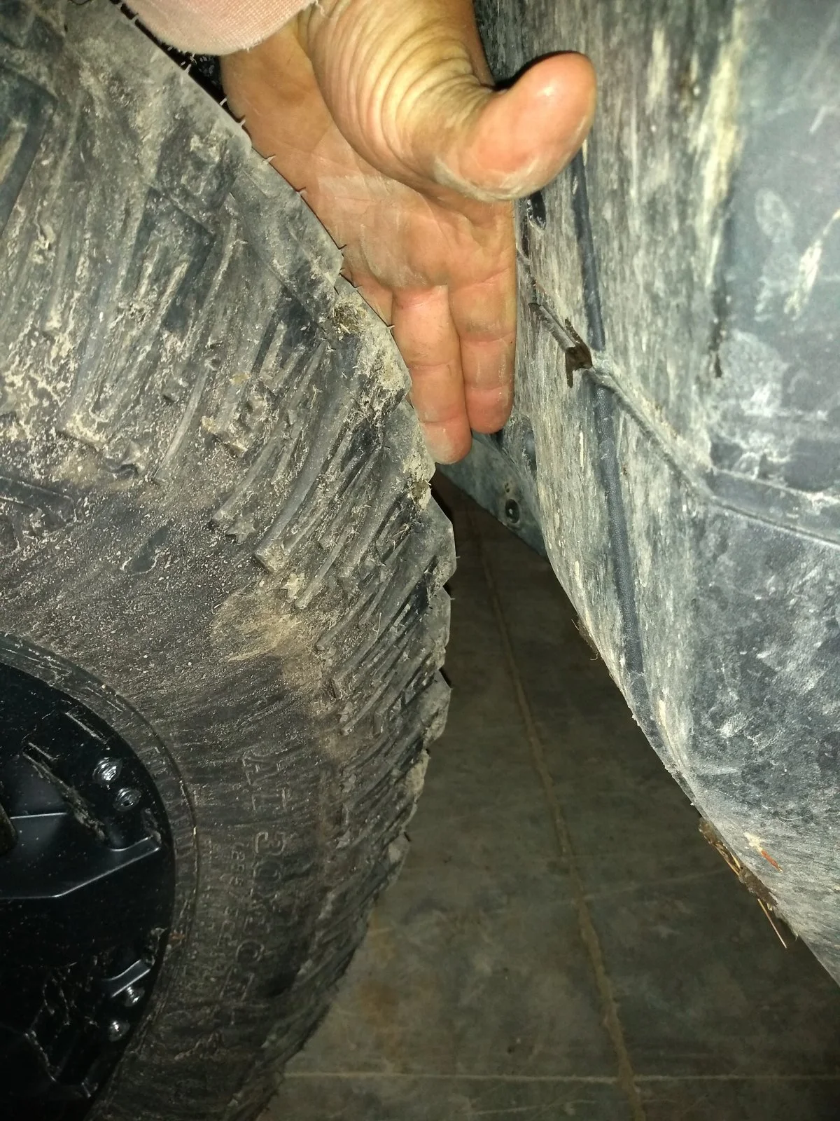

Well, I installed a 2" battle armor and with stock A-arms my 32" warriors only rubbed on hard downhills cornering... even with the shocks jacked... with 2" forward A-arms (which the 20's already have stock) They fit NO PROBLEM!!! The rubbing that occurred was not really that bad.... So would think anything under a 32" would fit nicely... but these 32"×10"×14"s are LOOK and RUN AWESOME... DOT TOO....
