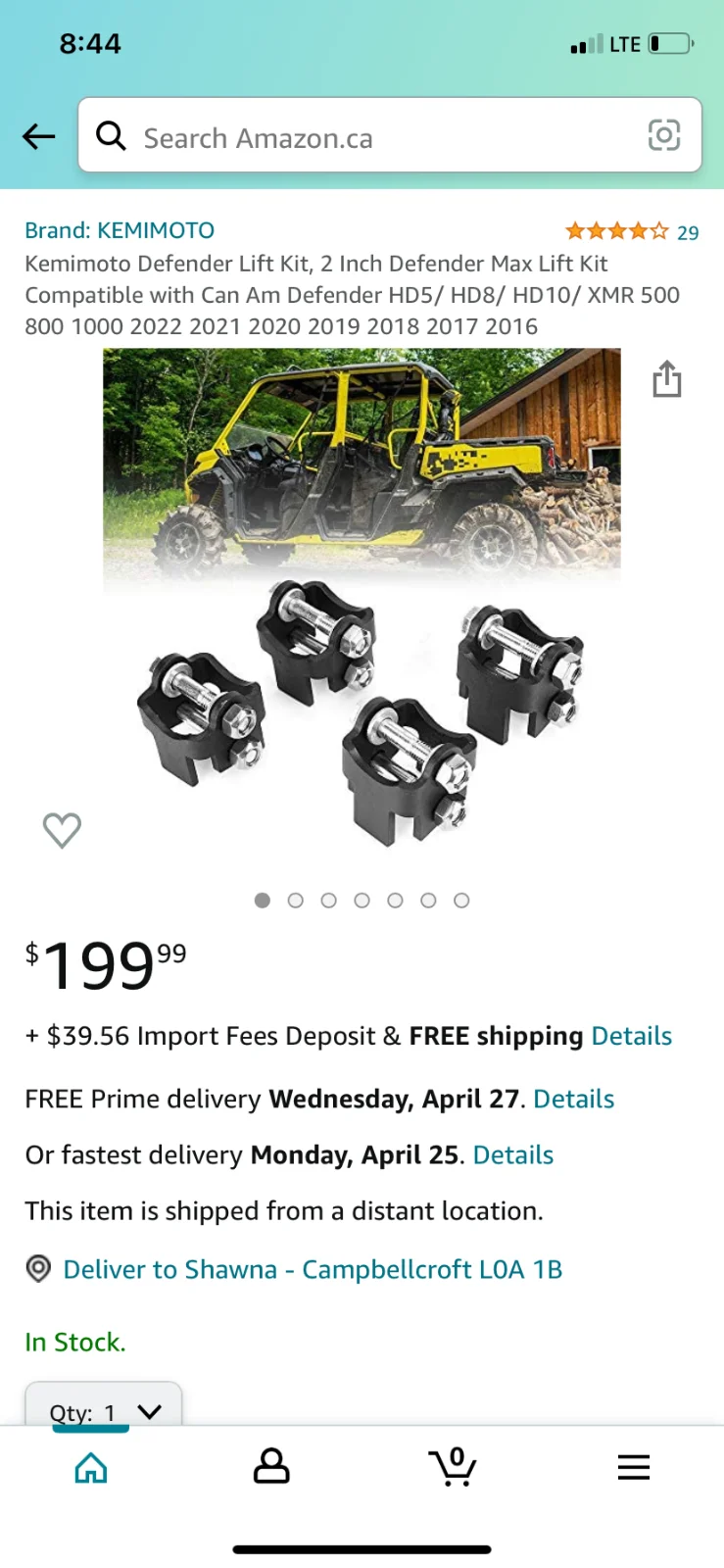

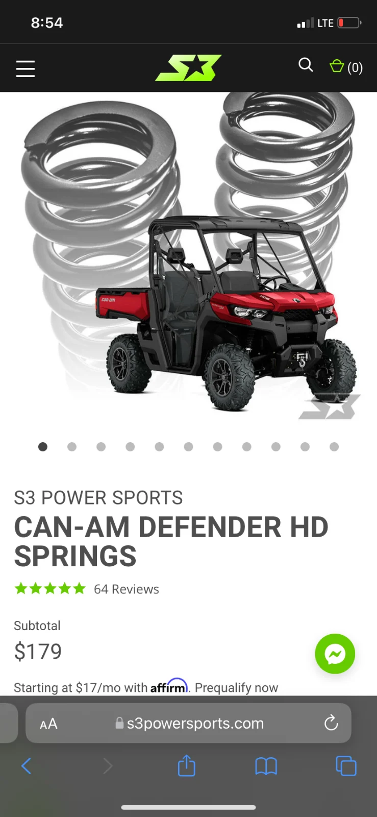

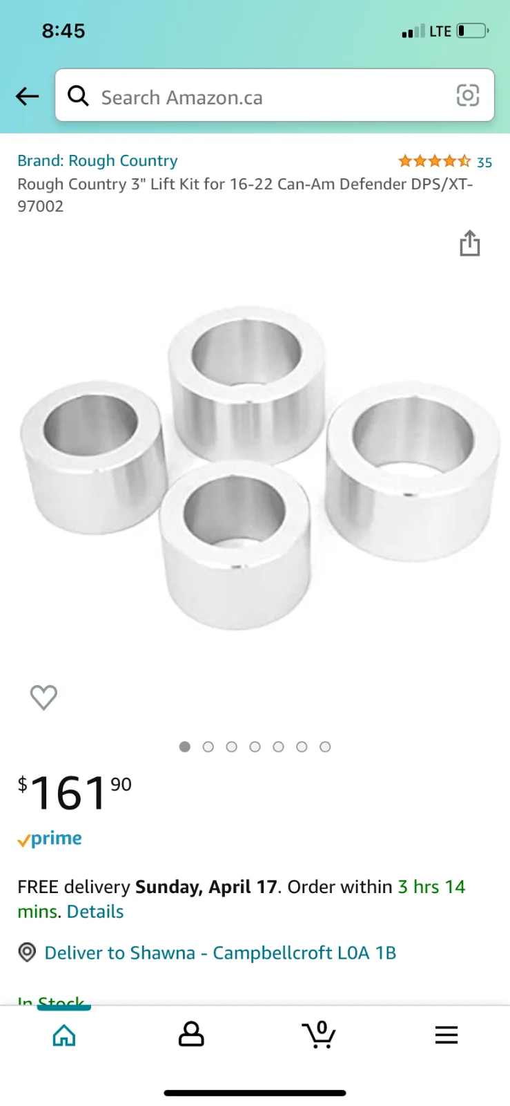

Hey there,
I am going to be purchasing the s3 springs, and I was going to get the 2” bracket lift to add with the springs. In theory I should gain around 4 inches.
I wanted to go up to 30 or 32” tires…. If I added the 2” rough country spring spacers on top of the other 2, would that completely pitch the tires inward and loose my width? Or would the 3 even go together? Or should I just purchase a full 6” lift package

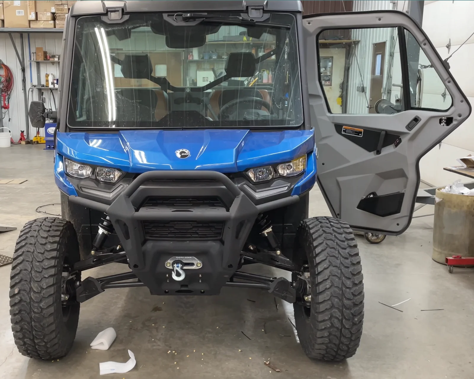

My honest opinion would be to get the 6” lift if you’re looking for a lot of lift because your axles are probably going to either be too short once you go that high or the angles of your cv joints are going to be too much, but if you’re just trying to fit 30-32” tires you won’t need much lift if any. All I did was the spring spacer and I clear 31” tires with more than enough space.
Oh thanks, I thought I was reading people were struggling with 30” tires with stock suspension. Maybe I’ll get the s3s and the rough country spacers and see where I land.
30’s will definitely clear with just one of those lift options. I’m pretty sure people on this forum have ran 30’s with stock suspension
Check out the builds section, you may find some more useful information. As stated above too much lift will cause the front axles to bind when the machine is going through some rough side to side stuff.🙂 ,
