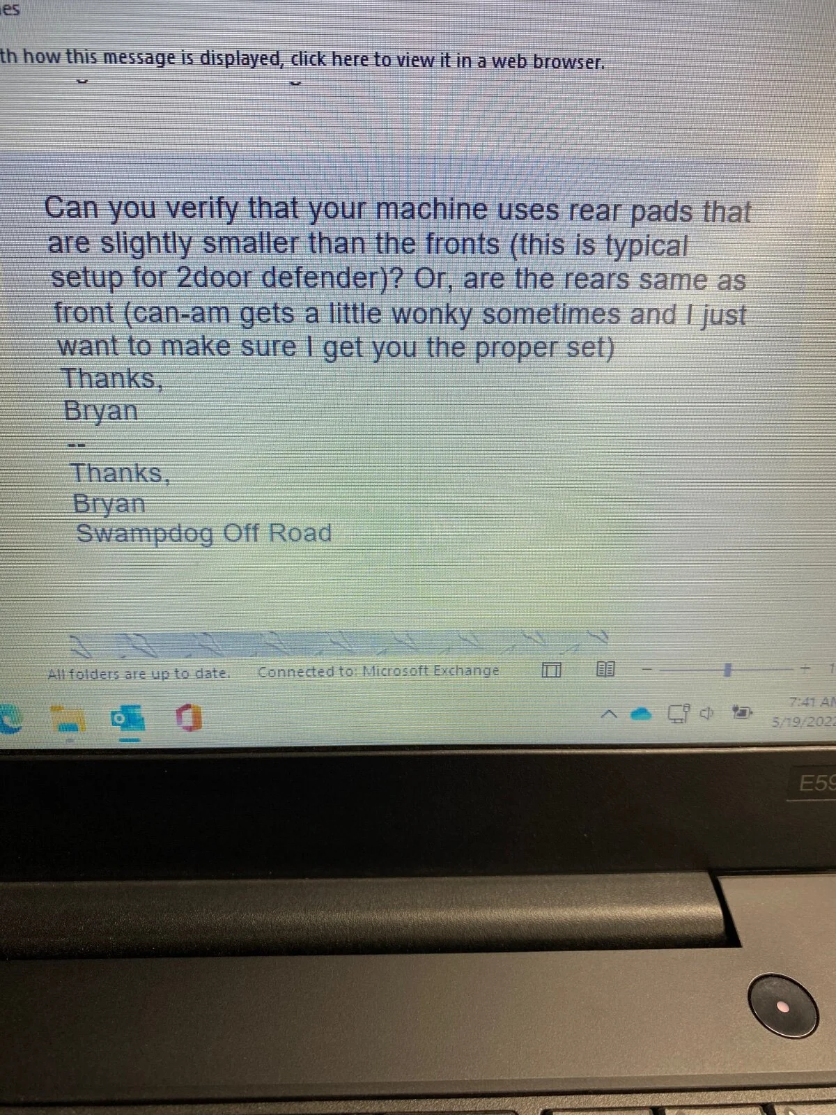

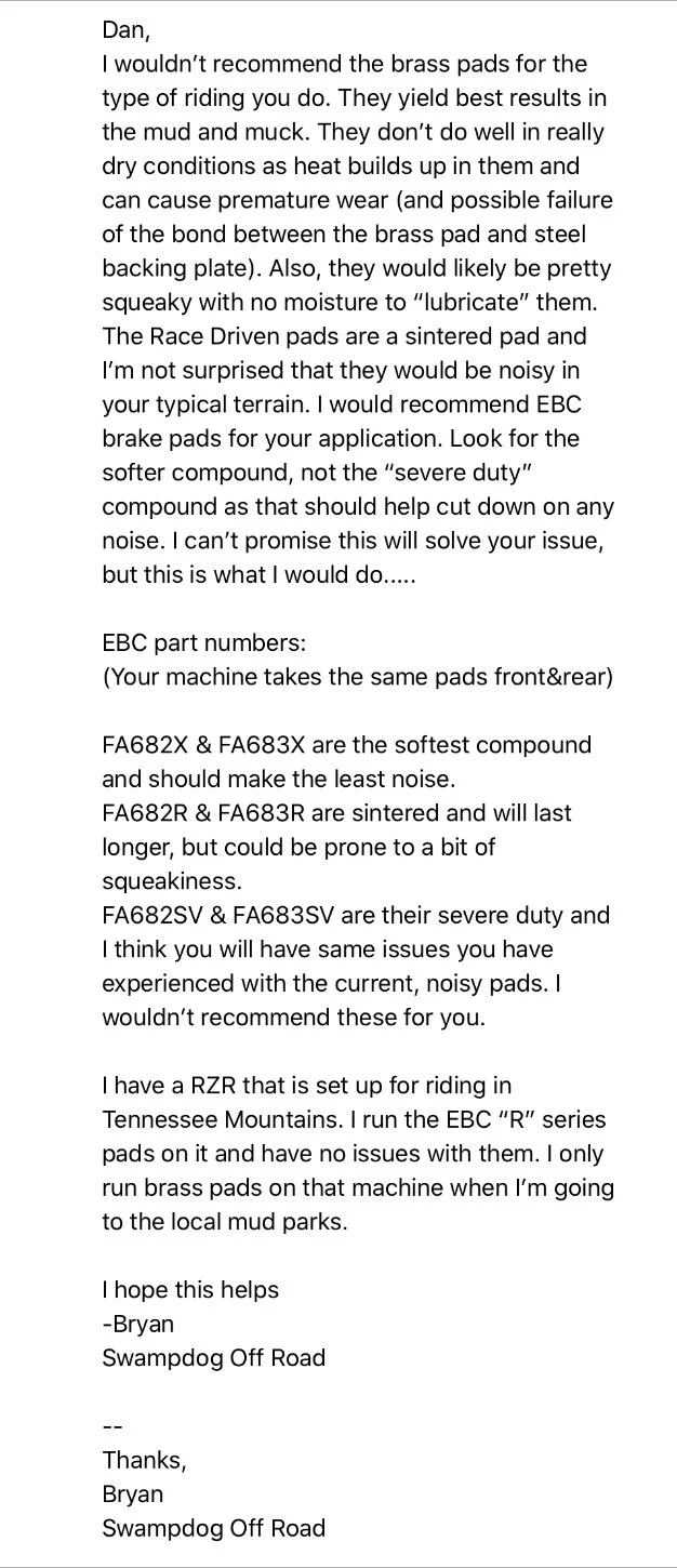

Has anyone tried the EBC brakes? I emailed the guy that owns Swampdog Offroad. He makes all brass pads and here was his response. Super good guy by the way, he was extremely helpful. For any of you guys that are mud riders, check him out.
Decided to give the EBC carbon X brakes a shot. I couldn’t take the squeak anymore. I’ll be the first to admit, I thought the race driven pads were the answer. After the first ride, I was wrong. They were almost as bad as the factory pads. I know the riding conditions with the fine dust out here in Arizona don’t do brakes any favors in the “quiet” department, but damn. These things are awful. When the machine is washed and clean the race driven ones were at least tolerable. Keeping my fingers crossed that these EBC pads are the answer. I have a nice dusty trip planned over 4th of July weekend coming up and I’ll report back! After the initial test drive after install they seem to be super quiet!

Happy to report back that this is an official fix! For me at least. Riding conditions couldn’t have been any dustier than they were this past weekend in the white mountains here in Arizona. We are getting a late start to monsoon rains this year in the desert. The old brakes would have been screeching and screaming within a few minutes of riding. An entire weekend of riding passed and I only heard them a few times (very brief) when applying the brakes. We will see how the longevity is over time. Hopefully they hold up well. Anyway, I know a few of you were interested to see how these pads worked out, we have a winner!! Hope you all have the same results!! Happy riding and stay safe out there.

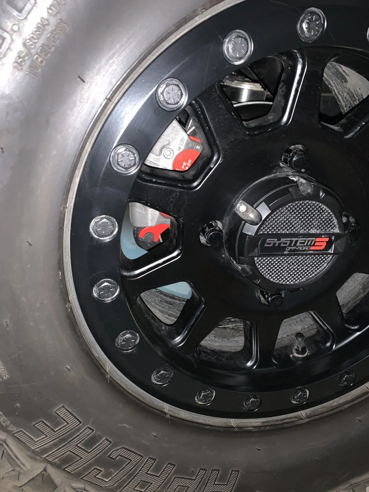

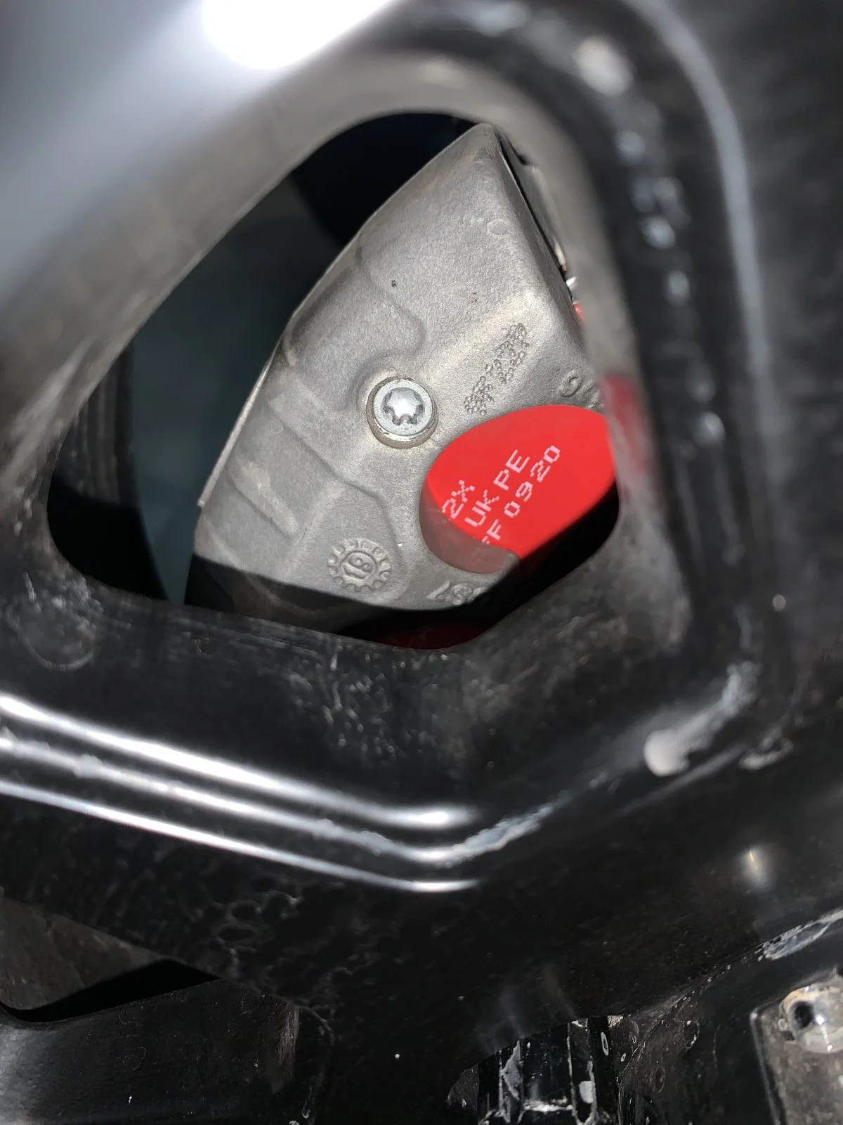

Anybody have a answer to this question? Getting ready to change mine out. I could take it apart and put it back together to find out but hey figured I’d ask.
