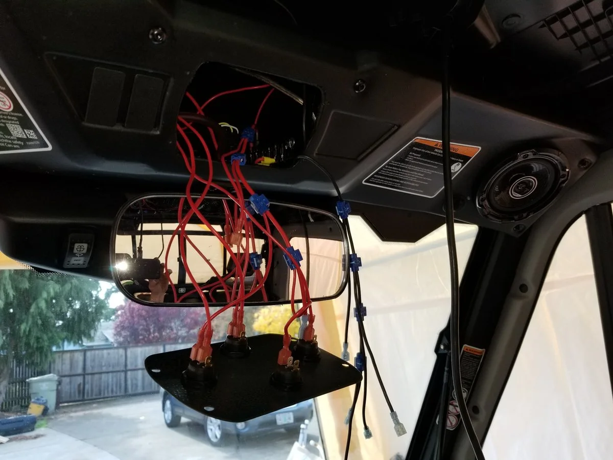

Here is just some of the wiring I've done. I took the area where they had originally planned the stereo to go into my lighting panel. I've made an access panel that allows me into the power area without pulling the entire piece. I've done some EXTENSIVE changes to the original setup. Dome light comes on when doors open as well as when closed, made made 12v sockets full time hot, and many other things...

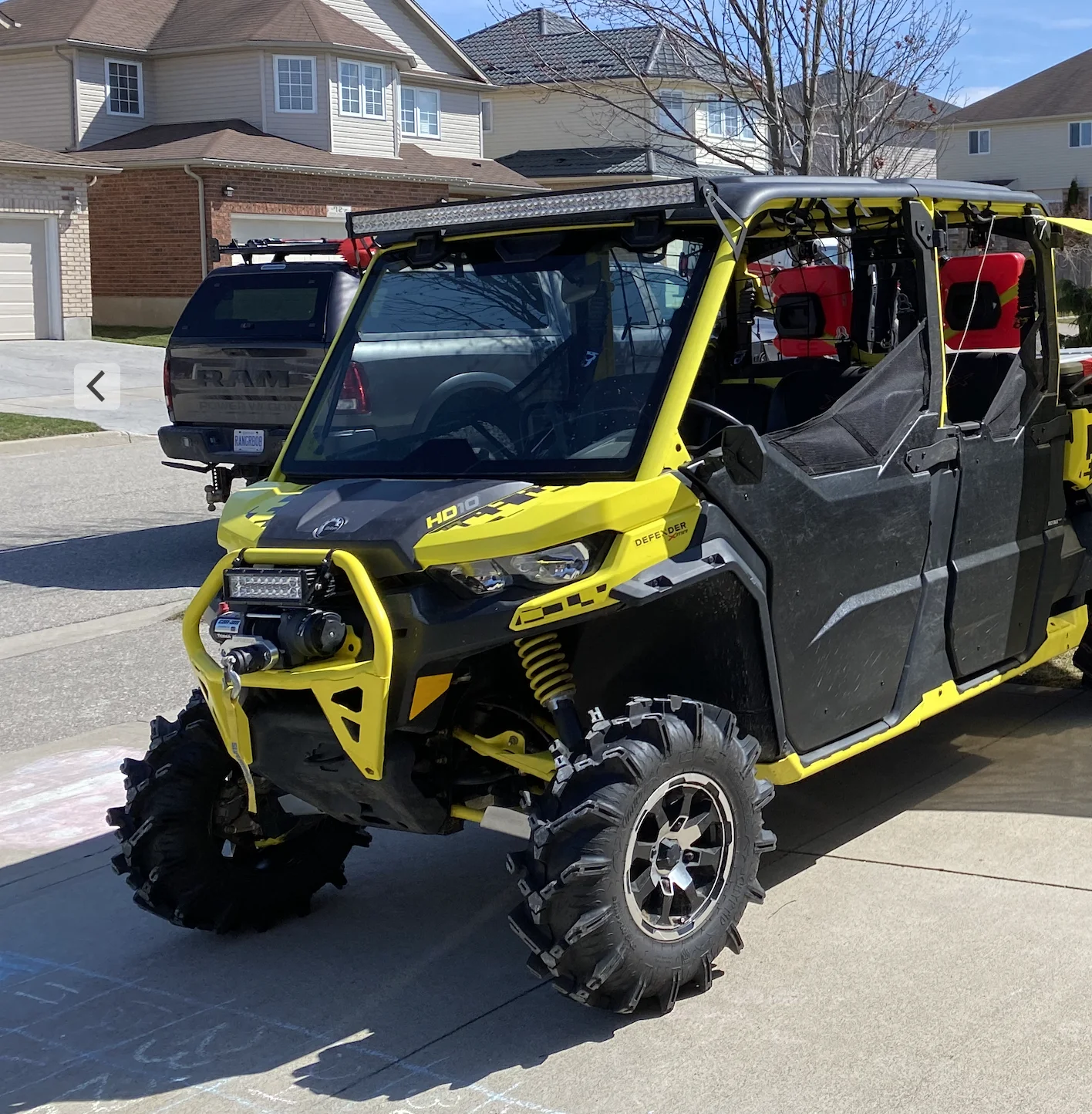

I'm in the same boat as "A Hunt 2 Remember". Having a Defender is new to me. I'm use to quads and Mavericks. My Maverick I could throw as many electrical components at it and it never gave me an issue.
Issue #1:
On my Defender, I have an overhead light bar, a light bar at the front winch, the Can-Am overhead audio package.
I've found that I cannot run them all at once with the stock headlights.
How do I make them all work together? Or is this impossible at this time?
Issue #2
My other issue is I have the Can-Am dual battery setup that I swear is messed up. With the Defender running, the secondary battery reads 12.X volts - you'd expect to see it jump to 14.x volts.
I had the dealer put that kit in for the very reason knowing I was going to want multiple lights running at night, with the stereo.
Any ideas how I can test the kit?

Nice rig!! But if you find the answer? Let me know... while your bumper does not block out your lights. My rancher bumper blocks better than 50% of the OEM lighting. GREAT DESIGN CANAM!! So what i have found is by not using my OEM lights other than in town on road driving where i can easily swap hi/lo beams but ither than that? USELESS!!! I found that ALL my forward facing leds...(54" in total, 4x8" 1x22") use 2 amps more than the OEMs and a WAY BRIGHTER AND CRISPER!!!
