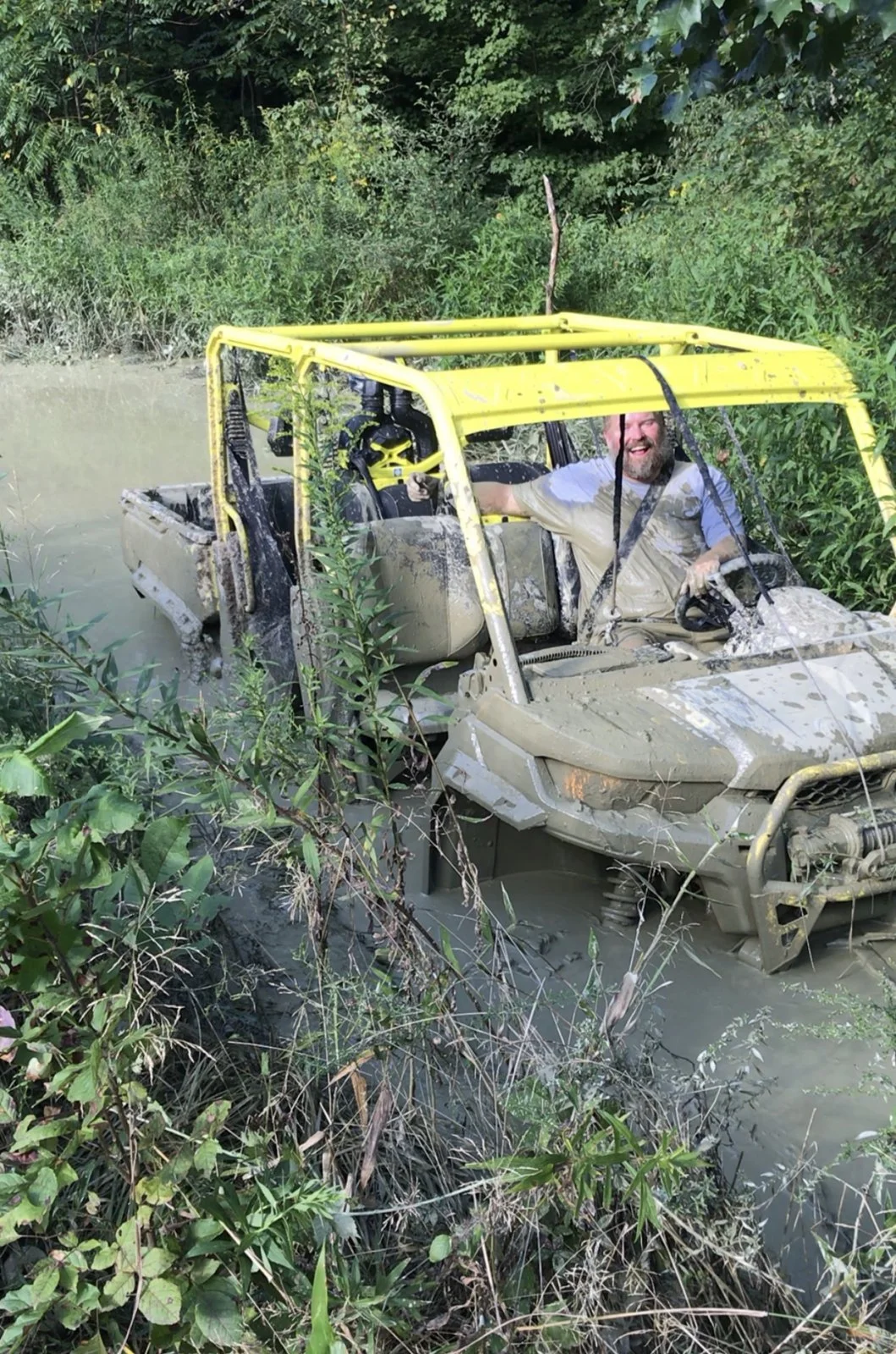

Welcome Jay from PA!  Looks like you were in some heavy soup!  Glad to hear you're back up and running!
Thanks CG. Everything seems to working just fine. However I won’t be trying that hole again. The mid was over my lap in the middle, and the ramp out was more of a wall that stopped me dead.  Sad to say that it took a ranger north star  tied to a ranger crew while I winched a tree to get out.
