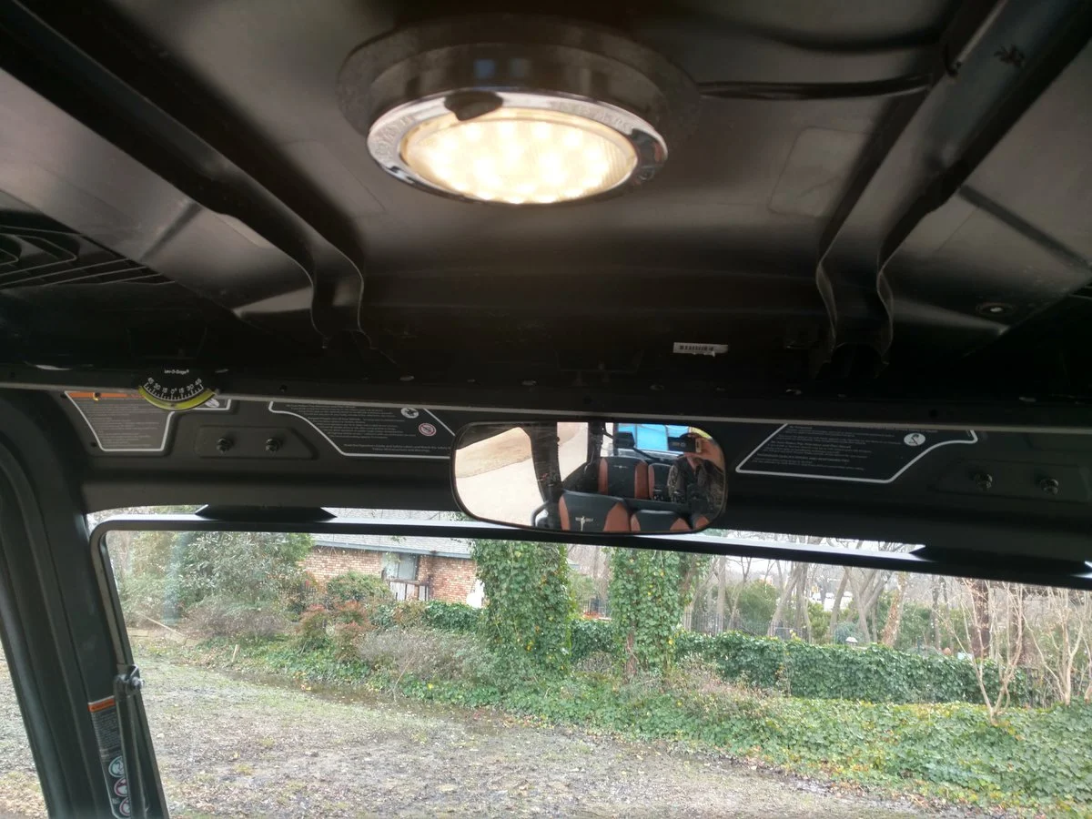

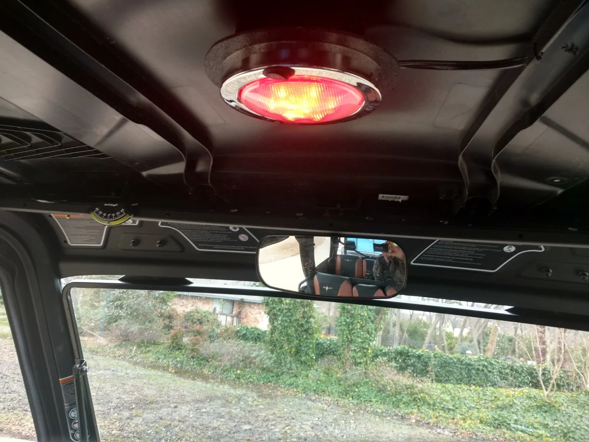

I don't have any under dash lighting, but I put in a dome light.  I wanted something that had red and white option.  There wasn't a lot to choose from.  The one I got from amazon didn't come with a backing plate of any kind so I had to get a sheet of ABS plastic and make a round plate that would mount to the can am roof.  In the end it worked out pretty good.  The white will light up both the front and back seat pretty good.  The red light just lights the front area but it does preserve my night vision when I need it.  It's the only thing that I wired up that doesn't go through the accessory switch, so it will work even if the key isn't on.

Hey Mark what is the dial in the top left of your roof? Looks like an integrated slope angle measuring device...? If yes, where did you pick this up from? Keen to get one for myself.

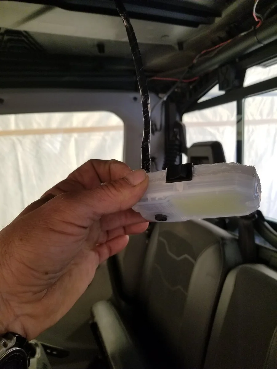

I've actually wired my original dome light to door switches. That way when the doors open the light comes on. Problem at first was there was no power when doors were closed. Added a mini switch and another lead. PROBLEM SOLVED....
