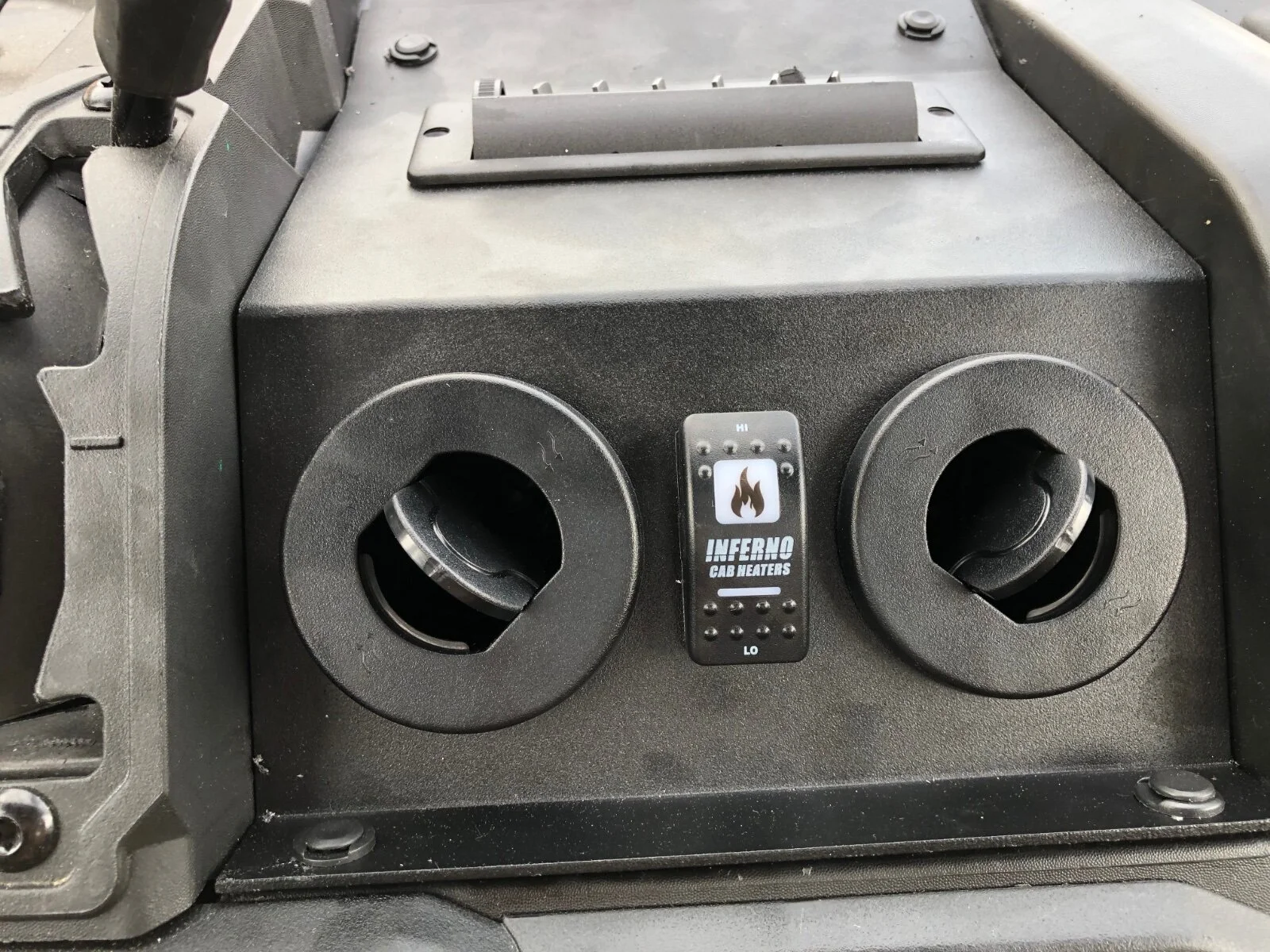

I installed the Inferno Heater with the Seizmik soft doors on my HD8. The installation was super simple. Heats up within minutes with great toasty warm heat.
Plumber802. I pretty much have the same setup installing the inferno hopefully this weekend if it shows up.  Does it actually heat the cab well? The siezmik doors are great but do still have a small draft.  I plow snow a lot.  Just curious how warm it actually gets in the cab?
You're going to want to seal up the front end to stop the drafts. So many spots that air and water get through the front wall.
