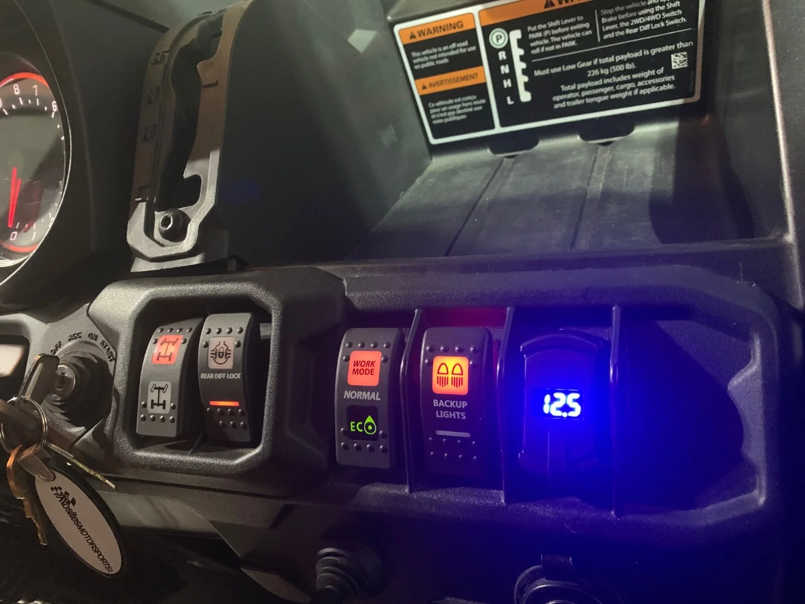

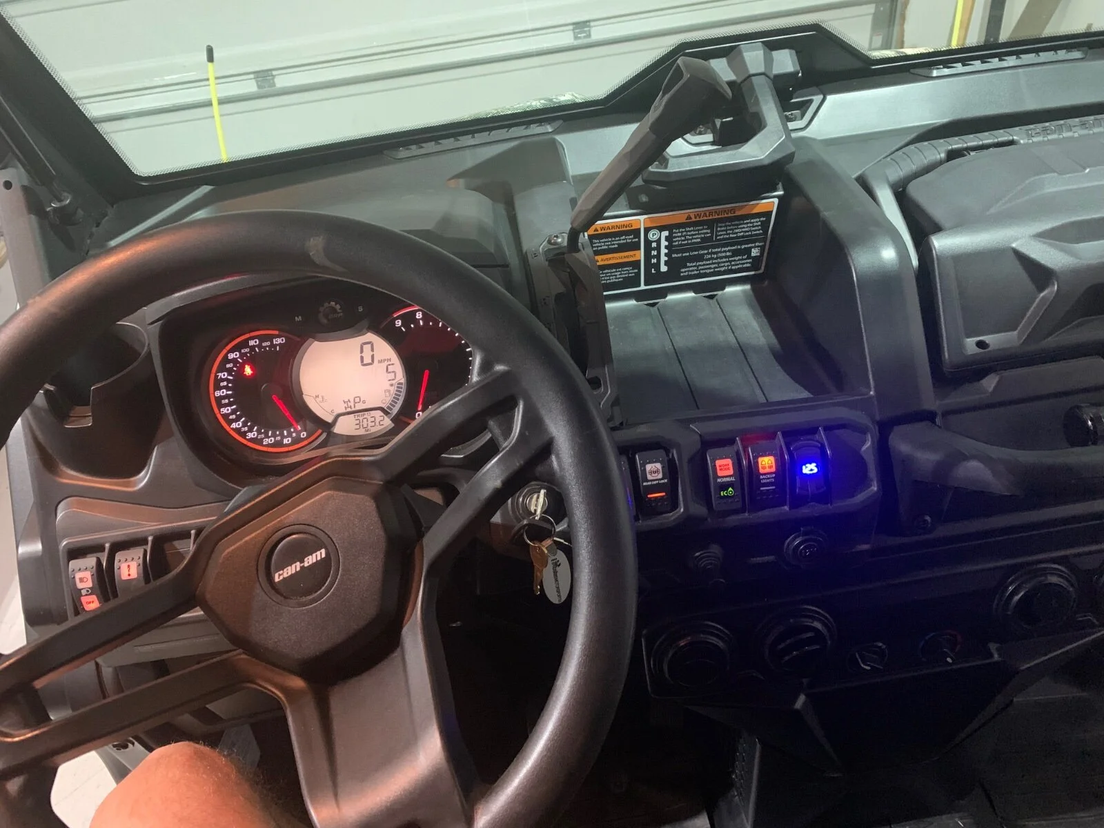

Found this on Amazon for $18.  Looks good, works well, and you can watch voltage levels go up and down as you start the rig and then use things like lights, snow plow, heater…. Easy wire-in: slide the heater out (3 screws and 4 nuts) then wired it directly up to the termination block under the dash to posts 1 and 3 (the “key on” power set up). - Mark
Looks like a handy item, especially for those with big accessory loads. At 12.6 and below you are starting to run on battery so it will show when you are getting back into the charge zone as the engine RPM goes up. Maximum charge RPM is about 4200 and up.
You can see battery voltage when you turn the key on before starting the engine. Thanks🙂
Steelslinger, I know what you mean about burning switch slots… I already had a plow joystick in the spot you refer to.  - Mark
