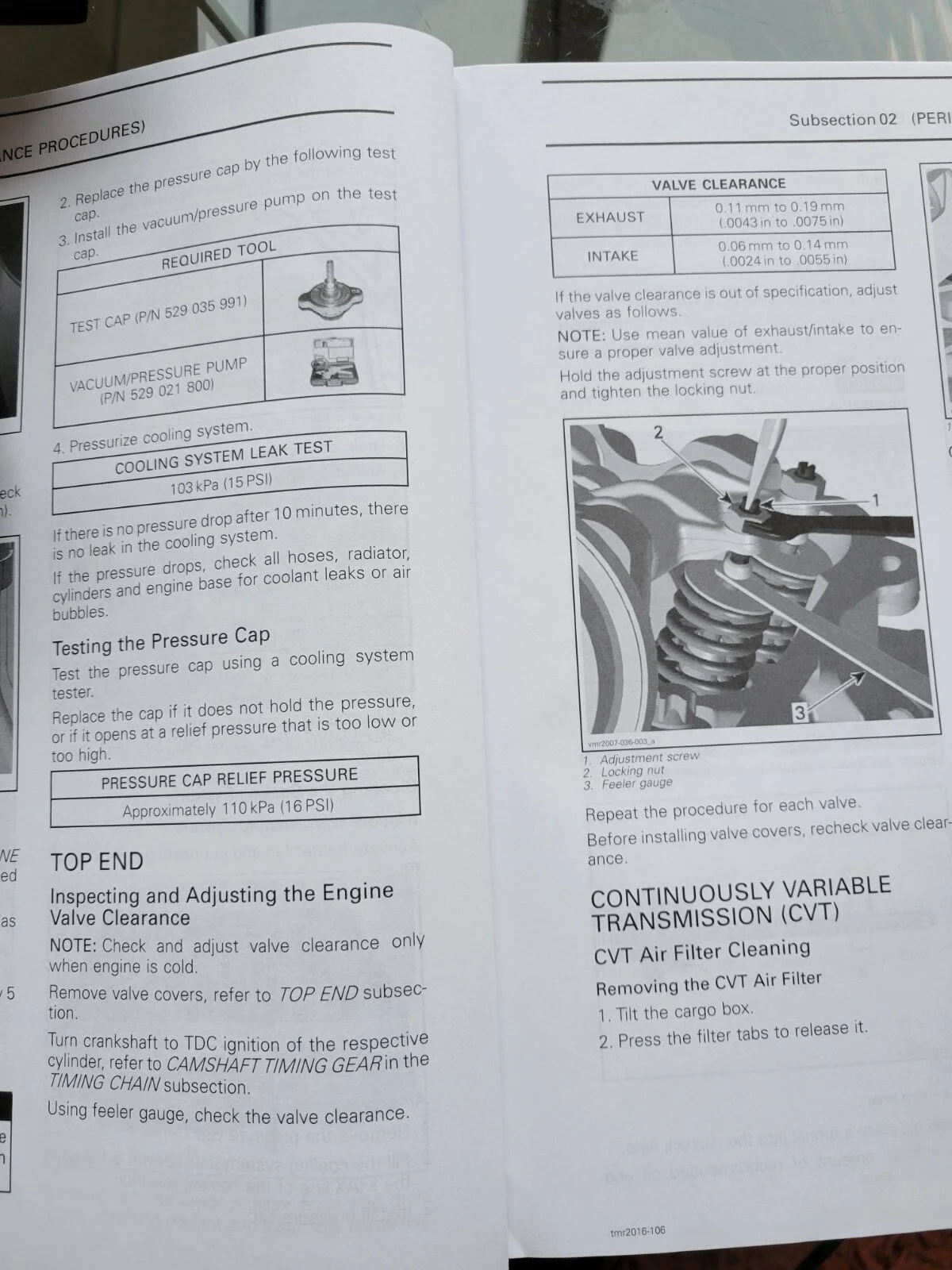

S ScottWV New member Joined Nov 6, 2021 Messages 9 Reaction score 0 Jan 8, 2023 #2 I tried the search with no luck. Anyone have a link to adjust valves in a 21 HD9?
A Andystoy19 Active member Joined Apr 24, 2019 Messages 714 Reaction score 159 Jan 9, 2023 #3 My 2018 shop manual supplement has the following procedure and the specs are the same for the HD10 and HD8, you may want to check with the dealer if the spec is different for the HD9? My SWAG is that it is the same.
