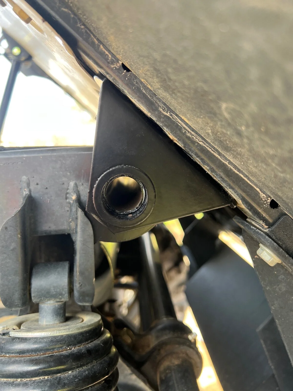

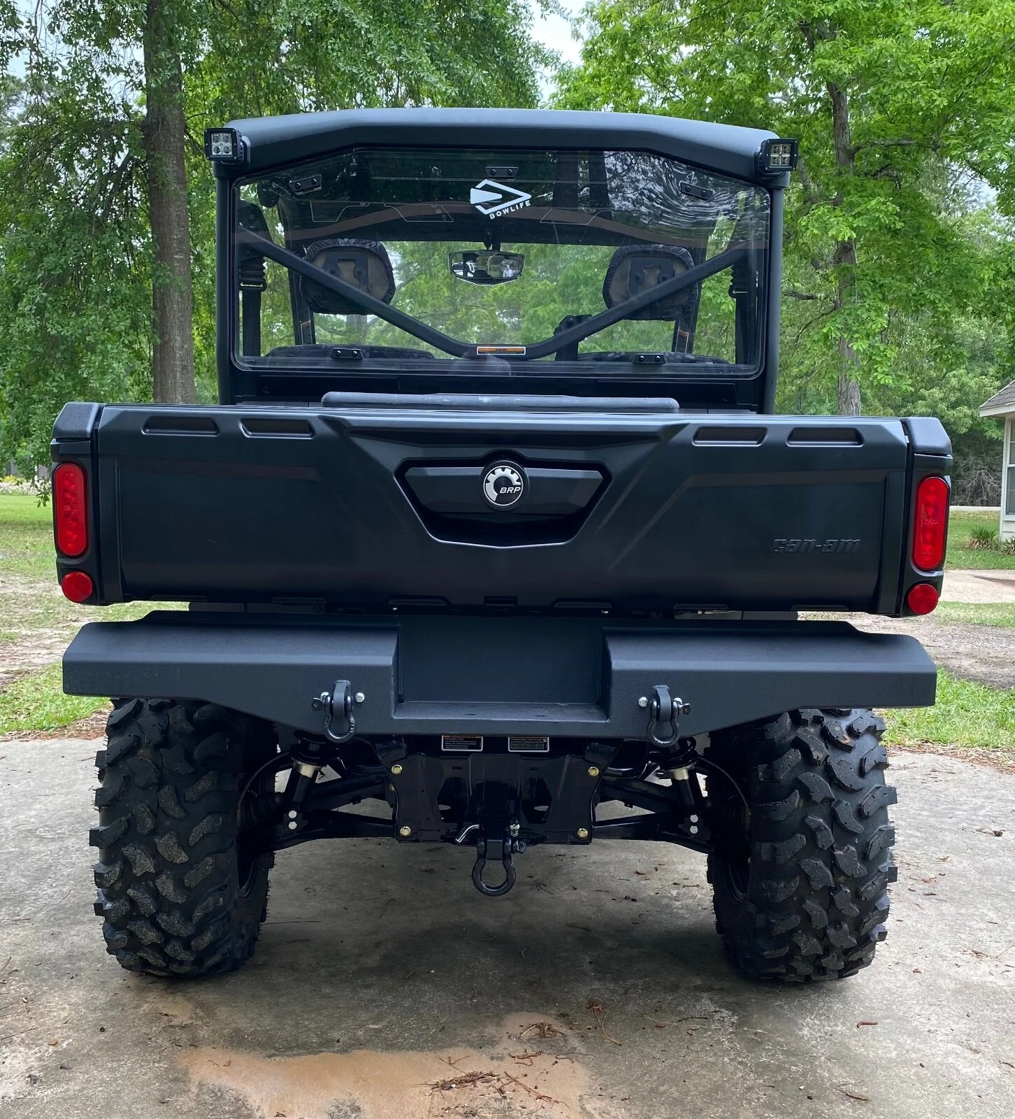

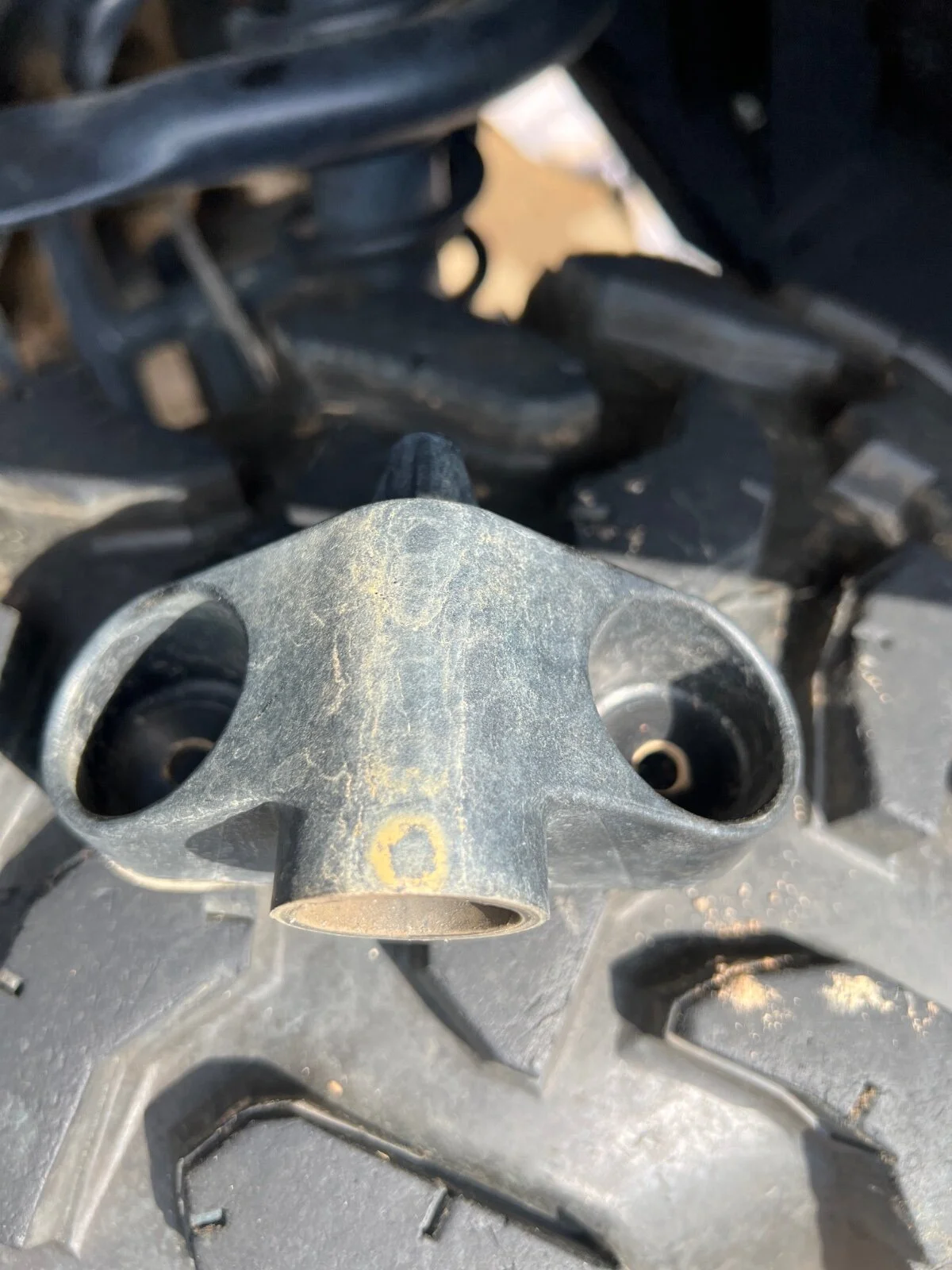

I went with the Super ATV version. Serves for what I needed. Wanted a step up to access cargo bed and hopefully add protection if rear ended or backing into something. Whatever you decide to go with however, replace the factory plastic cargo bed mounts with the aftermarket metal ones. It’s a guarantee that in the unfortunate mishap of backing into something or behind struck from behind, they will break and off goes the cargo bed.
Thanks for the reply and info Vader.  You did the same thing with your rear lights I am planning on doing.
Does your bumper pivot with the bed (do all bumpers pivot with the bed?)?
It does pivot with the cargo bed. Would imagine all do, to be able to open and tilt.  I did lose some of the tilting capability due to the bumper contacting the tires.
