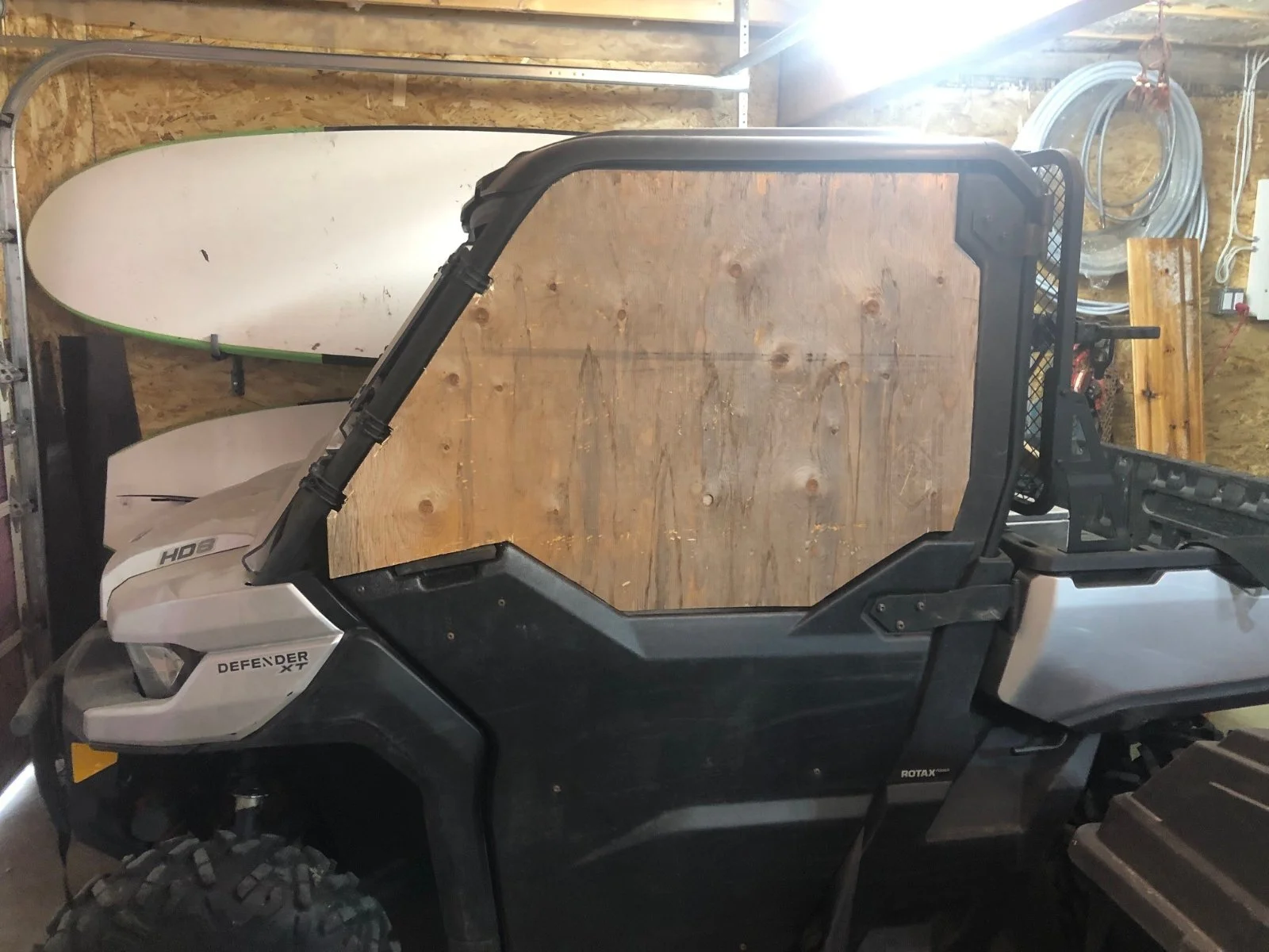

OK, time will tell if this is a bad idea.  I am proceeding with building my own uppers for the can-am half doors to help close in the cab.  I have just build a template for the window and have ordered a sheet of Lexan MR-10 (abrasion resistant polycarbonate).  I will make the frames out of angle iron that will bolt to the half door frames.  I will post the build in the coming weeks once all materials are received and i have time to work on this.  Any advice would be appreciated.

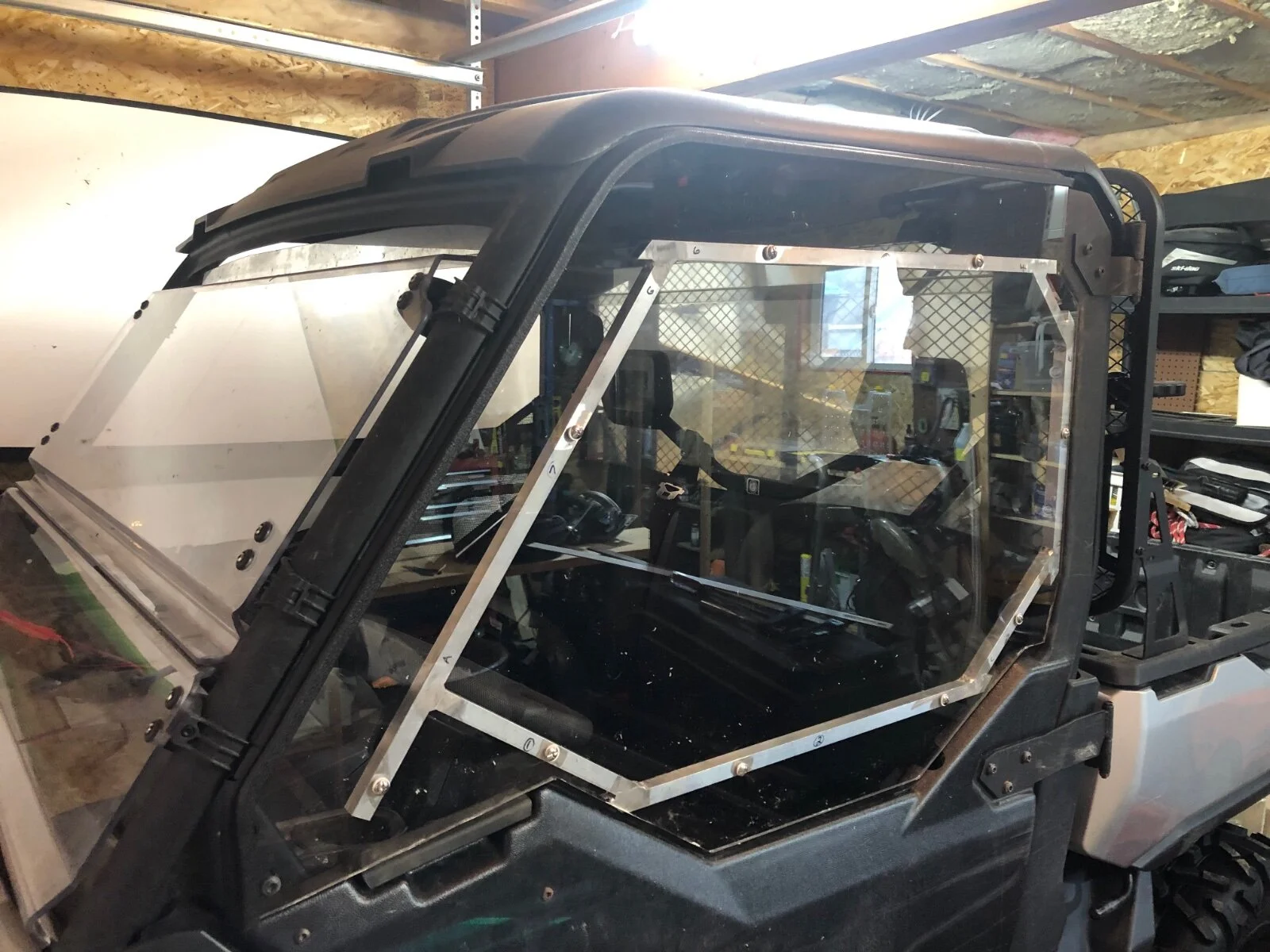

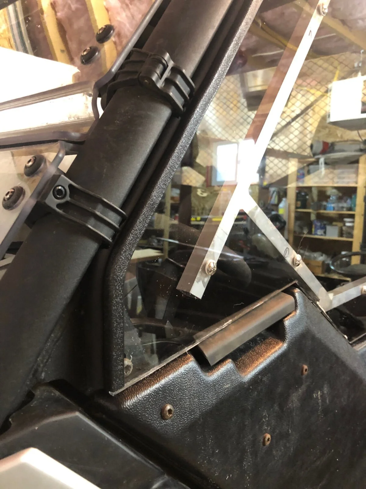

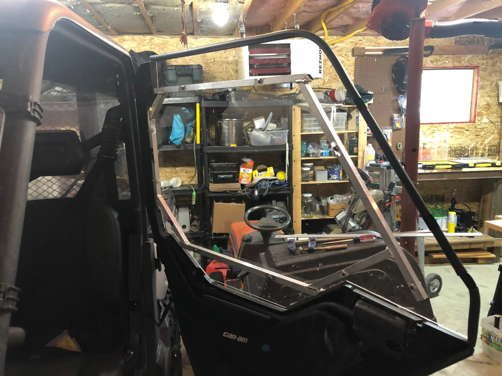

Ok that took longer than hoped. I tried to cold bend the aluminum tube but kept breaking them as the mandrels were too small. I had a local welder weld out the frames. Here they are installed.
I will add an anchor point at the door handle today.  This summer I will get the frames adonized.
