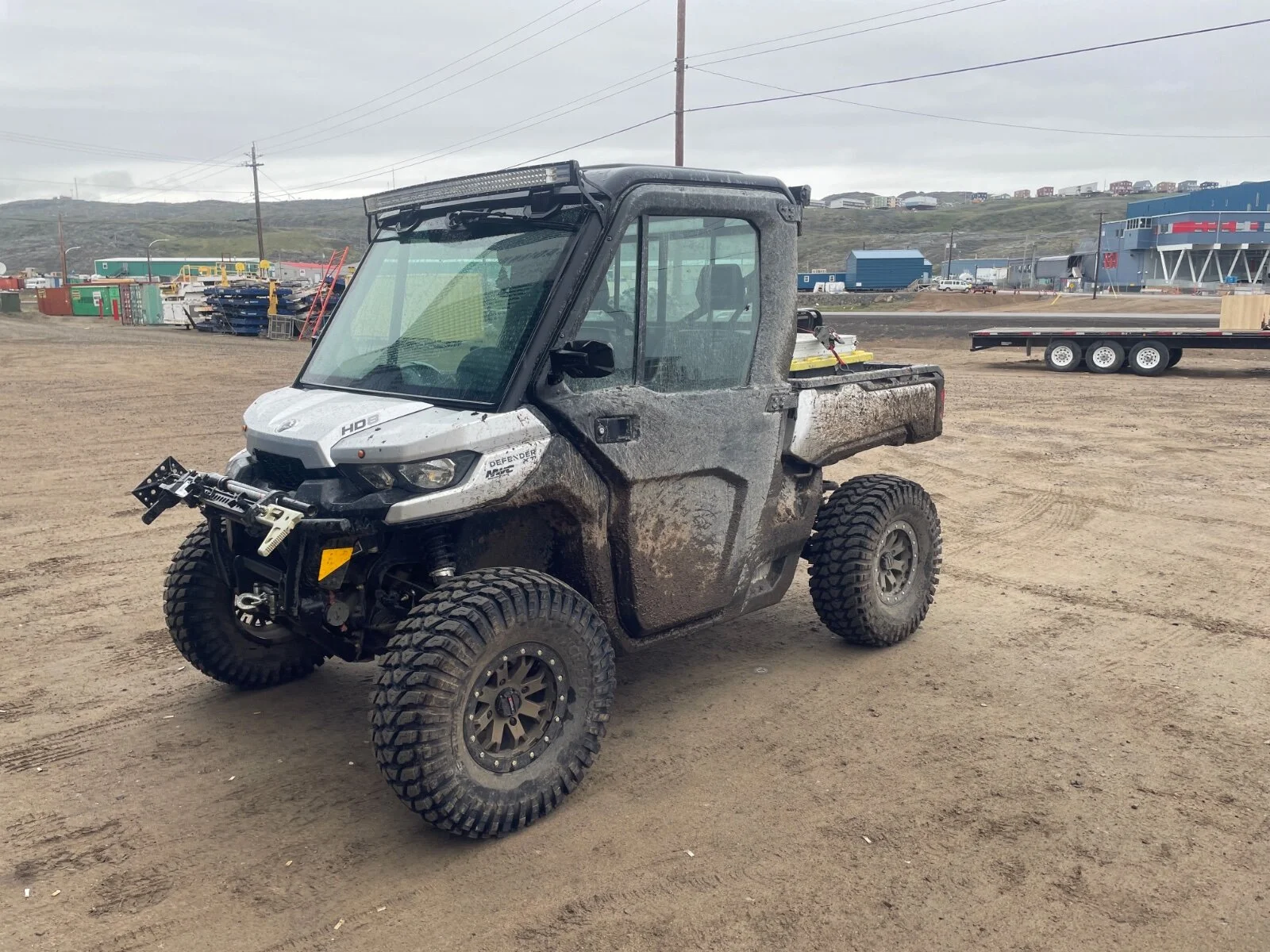

I am running 30" Systems 3s and no need to lift the machine. I have the fronts on the softest pre load, and rears 2 clicks firmer. I used a 1" spacer on the rears so they track with the fronts.

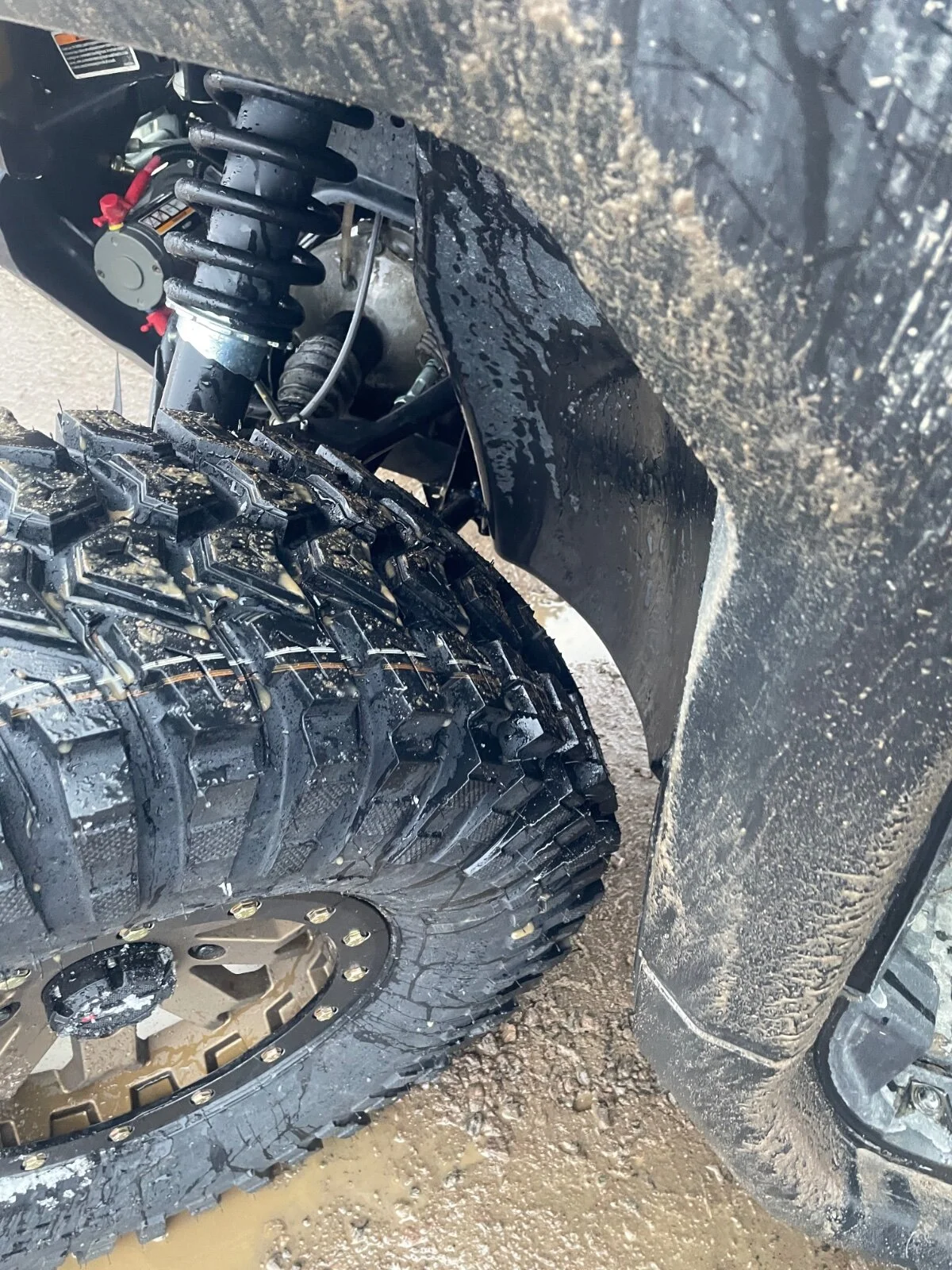

What did you ever end up doing?  I just tried putting 30” BFG KM3’s on my 2018 HD8 today only to find out they would rub really bad when turning since my machine doesn’t have the 2” forward offset A arms… So it was either order those from Super ATV for $450 and then have to get the ball joints out of my existing arms and pressed into the news ones or just settle for 28’s…
Did you crank your shock adjuster up to the maximum height, its free and may help you with the rub issue?🙂
