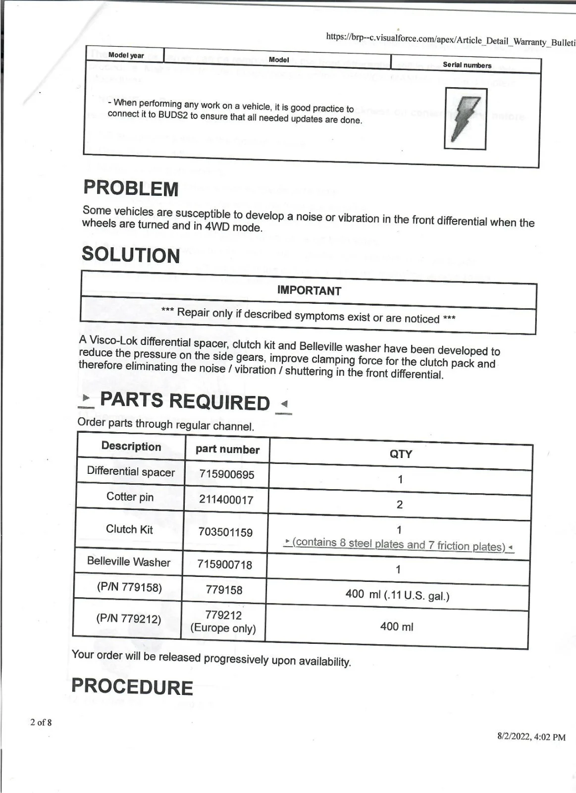

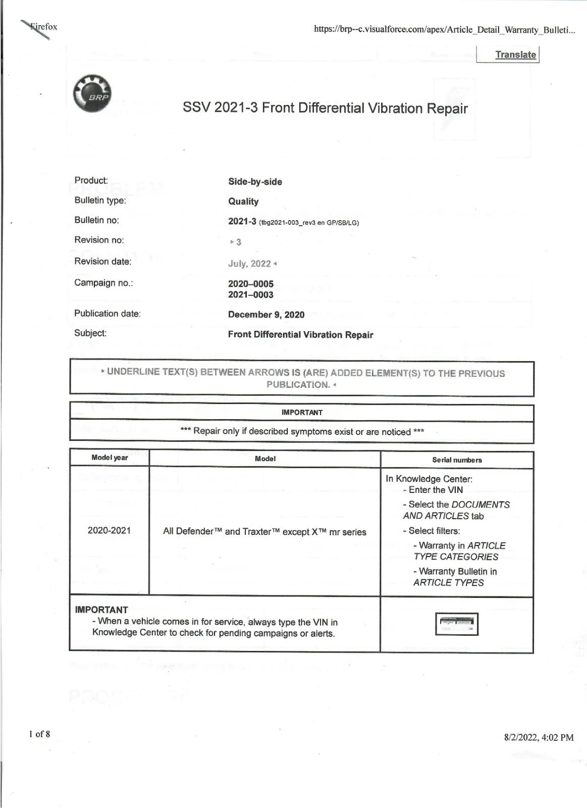

I have same problem when turning right or left. Like a rubbing binding sound. I went to my dealer after work. He said yes a service bulletin came out last month to fix this common problem.  He printed the bulletin out for me. Has a spacer,a cotter pin, a clutch kit, a belleville washer,and new fluid. He is ordering the parts tomorrow for it. Guess I will take mine in next week to try it on mine.says on the bulletin expires Jan 31 2023 if anyone here needs to get this fix.

Ymurph, please post a copy of the bulletin your dealer printed for you.   I'm sure it will help lots of folks on this forum.  I know it will help us with our 2022 HD9 since none of the dealers we've spoken to claim to know anything about this problem, or the bulletin.                   Thanks!
Not exactly a recall. It is a service bulletin. They told me not all the side by sides have this issue so they didnt do a recall. It is offered but only if you ask about it.
