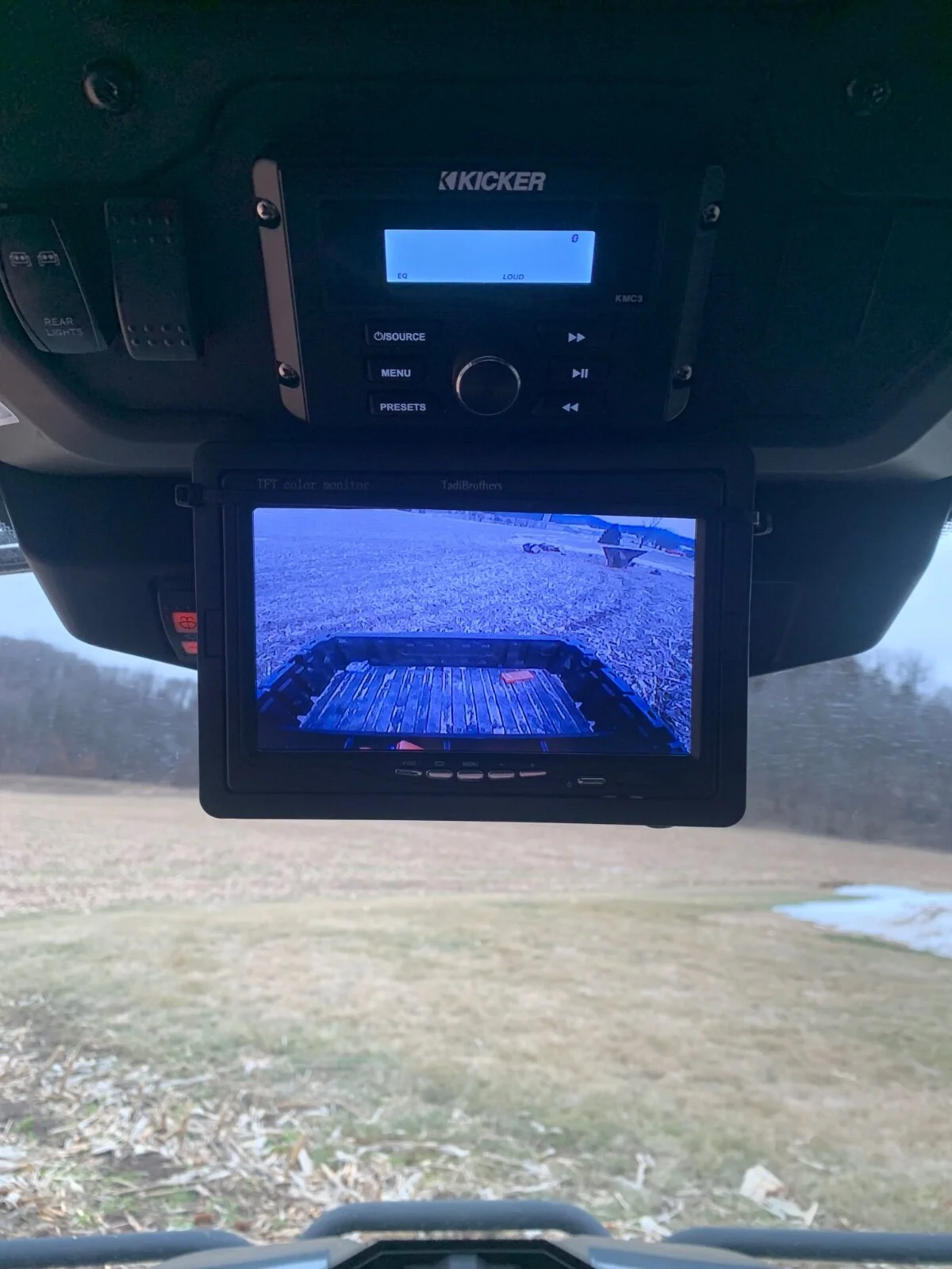

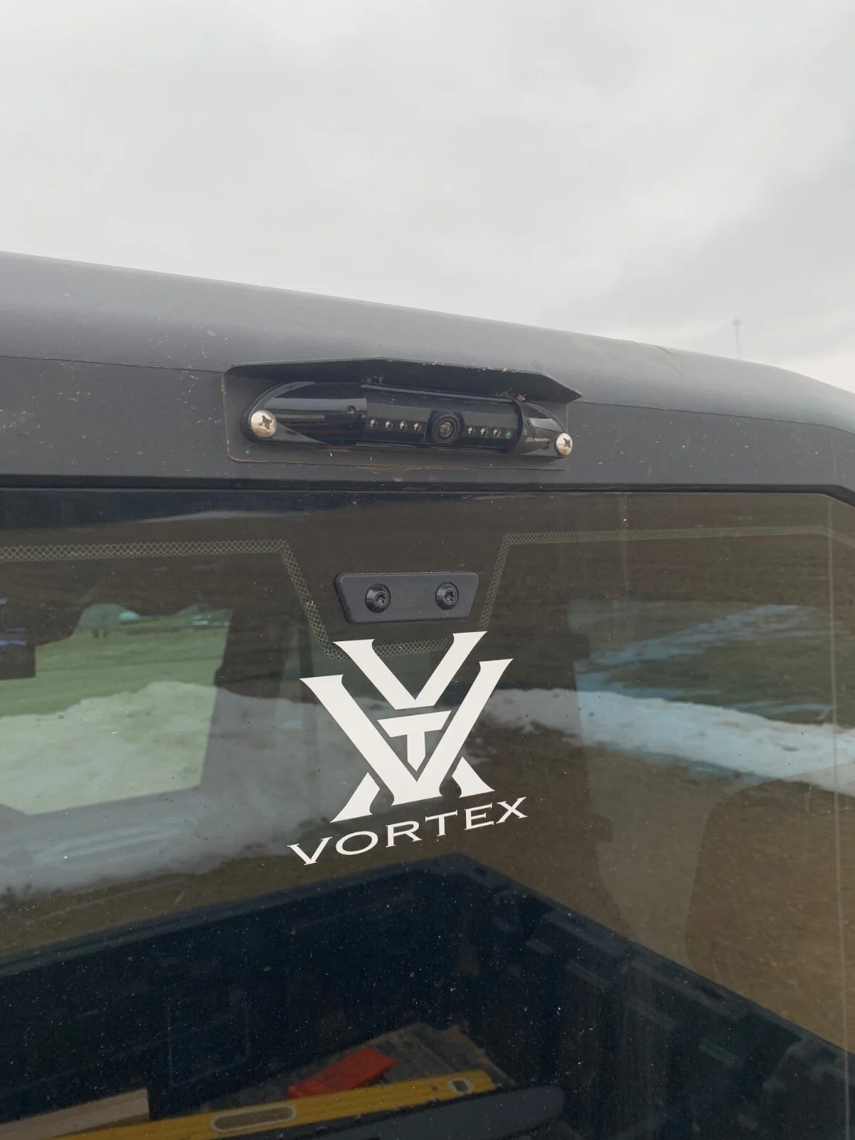

i installed my back up camera to the back of the cab, not on the tailgate (when sprayer tank installed, i remove tailgate) Wires were ran entirely under roof liner and power,wired to power stud installed behind plastic head liner) switch, ( so I can turn off camera at night) and fuse located in headliner.
i also installed back up lights in rear bumper. This was also connected to same power location in roof.  Wire was also run above headliner to rear B pillar. Pillar has a hole to run down to engine and frame then to bumper.  These are two switches you can see in pick with camera.
I like camera on cab. This replaces rear view mirror to see what is following or approaching and helps keep track of anything in bed. I installed with formed metal to protect against any tree branches contacting camera when back up in the woods.
