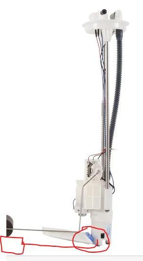

thats a tough one... the easiest thing to do is make sure it is always full but that wont always happen.  id bet that after about 1/2 tank or so the gas can get far enough away from the pickup to starve it for fuel.  as andy said, there may be something tangled but i doubt it.  the pick up does not move around, it is pressed pretty firmly into the base of the tank under the location and has filter on the bottom of it.  that filter doesnt move at all.  about the only thing you could try to do is make a "floater" end that would lock onto the plastic inlet and move around to pick up fuel depending on direction.
the tough part is, this is what the oem pump looks like. the filter is against the bottom of the tank, in about the middle.

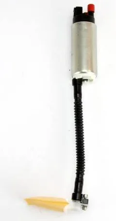

Something like the flexible pick up on the image below would have to go in place of the filer above, you would probably have to shorten the whole pump as well so that it wouldnt crush the hose on the bottom when the retainer screws back down on the tank.
