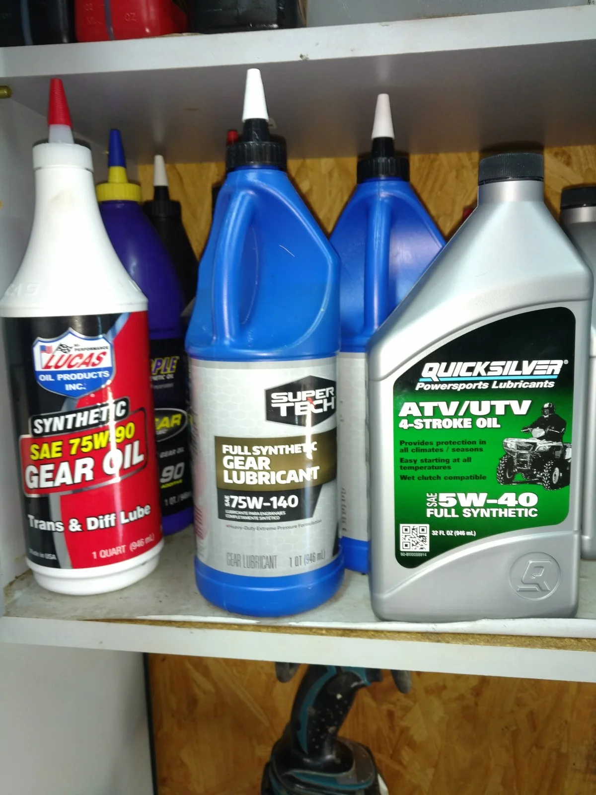

It is not difficult to do yourself.  You need a few parts from can am.  Engine Oil Filter, Oil Filter o Ring, Engine Oil Drainplug Gasket, Gearbox Drainplug Gasket.  Then Front Diff Oil, Engine oil, Gearbox Oil.  Attached is a photo of the three oils I use.  I use the Lucas in the front diff, the Quicksilver in the engine, and the supertech in the gearbox.   You can get all of them on walmart.com.  I ordered the filter and gaskets from cheapcycle parts but if you are near a dealer it may be just as easy to go there for them.   I also removed and cleaned the vehicle speed sensor in the gearbox because it's magnetic and it will pick up some metal particles in the first oil change.  It was a bit hard to remove due to it's location in the back.  I have about 800 miles on these oils and they  still look new but I'm about to change again just cause I want to make it an annual event.
