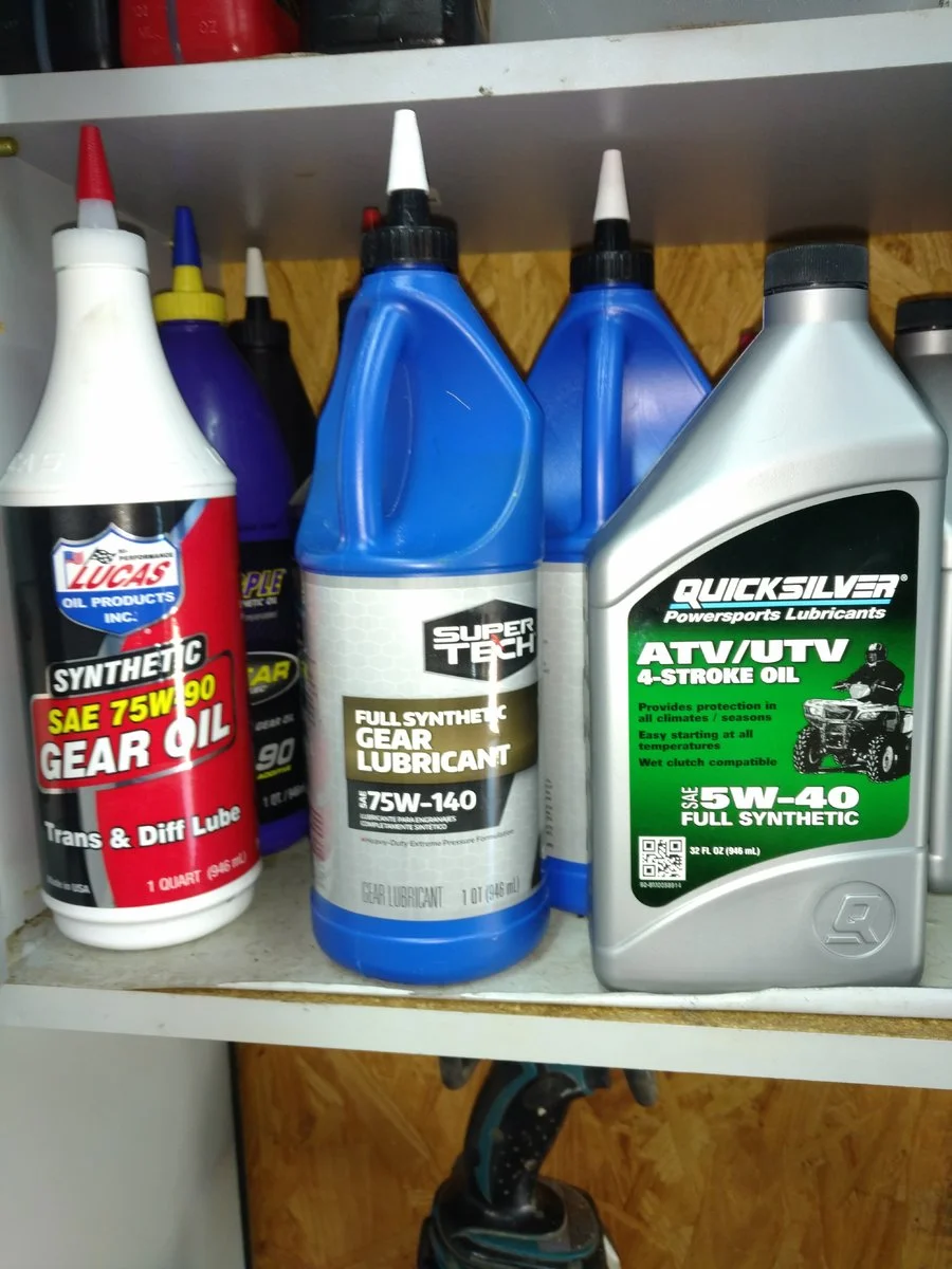

I'm getting close to doing the 1st oil change.  Interesting how much more it is to go with can am oil.  I think I'm going aftermarket but full synthetic.
Aftermarket
Front diff oil 75-90
 $      16.23
Lucas oil oreilly-1qts
gear box oil 75-140
 $      25.37
super tech walmart-2qts
gear box plug o ring
 $        3.30
cheapcycle parts
oil filter
 $        9.99
cheapcycle parts
oil filter o ring
 $        2.49
cheapcycle parts
oil plug o ring
 $        3.30
cheapcycle parts
engine oil 5w-40
 $      23.90
quicksilver UTV walmart-3qts
 $      84.58
OEM
 $      23.99
amazon xps 1 qt
gear box oil 75-140
 $      59.38
amazon xps 2 qts
 $        3.30
cheapcycle parts
oil filter
 $        9.99
cheapcycle parts
oil filter o ring
 $        2.49
cheapcycle parts
oil plug o ring
 $        3.30
cheapcycle parts
engine oil 5w-40
 $      65.70
amazon-xps summer blend 3 qts
 $     168.15

I got the first oil change done.  The front differential looked brand new.  The engine oil looked like it needed a change but not too bad.  Had metal particles on drain plug and oil filter had some as well.  These looked more like they were from it being a new engine as some of them were long and narrow like thread cuttings but there were also flakes in the oil filter.  Gearcase oil looked pretty good but the magnetic drain plug  was completely full of metallic sludge which looked like it was more from wear and tear than being new.  The rear vehicle speed sensor was also recommended to be cleaned so i did.  It had a few metal particles stuck to it but not too bad.  The vehicle speed sensor and the front differential fill plug are very difficult to remove and reinstall.  If you don't have a winch the front diff may not be that bad.  I have 600 miles on mine and about 80 hrs.  After looking at the oil I'm leaning more toward agreeing with the dealer and changing them early, maybe at 40 to 50 hrs to get that metal out of there,  at least for the engine oil and the gear case. The front diff looks like it could have gone longer.
