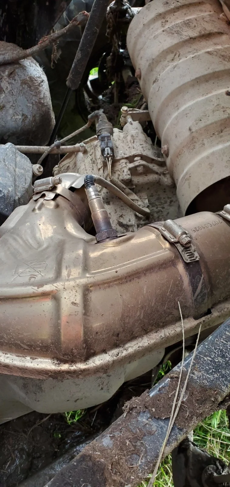

  I believe this is my temperature control sensor. It looks like it is cooked?  What do you think.
The sensor you are looking at is the exhaust temperature sensor and it is probably just fine.

The coolant temp sensor is forward of the area you are looking on the inside of the head nearest you and has 2 wires, if the engine went into  limp mode and stopped it is doing something but may be out of range or fine if the fan doesn't cycle?
