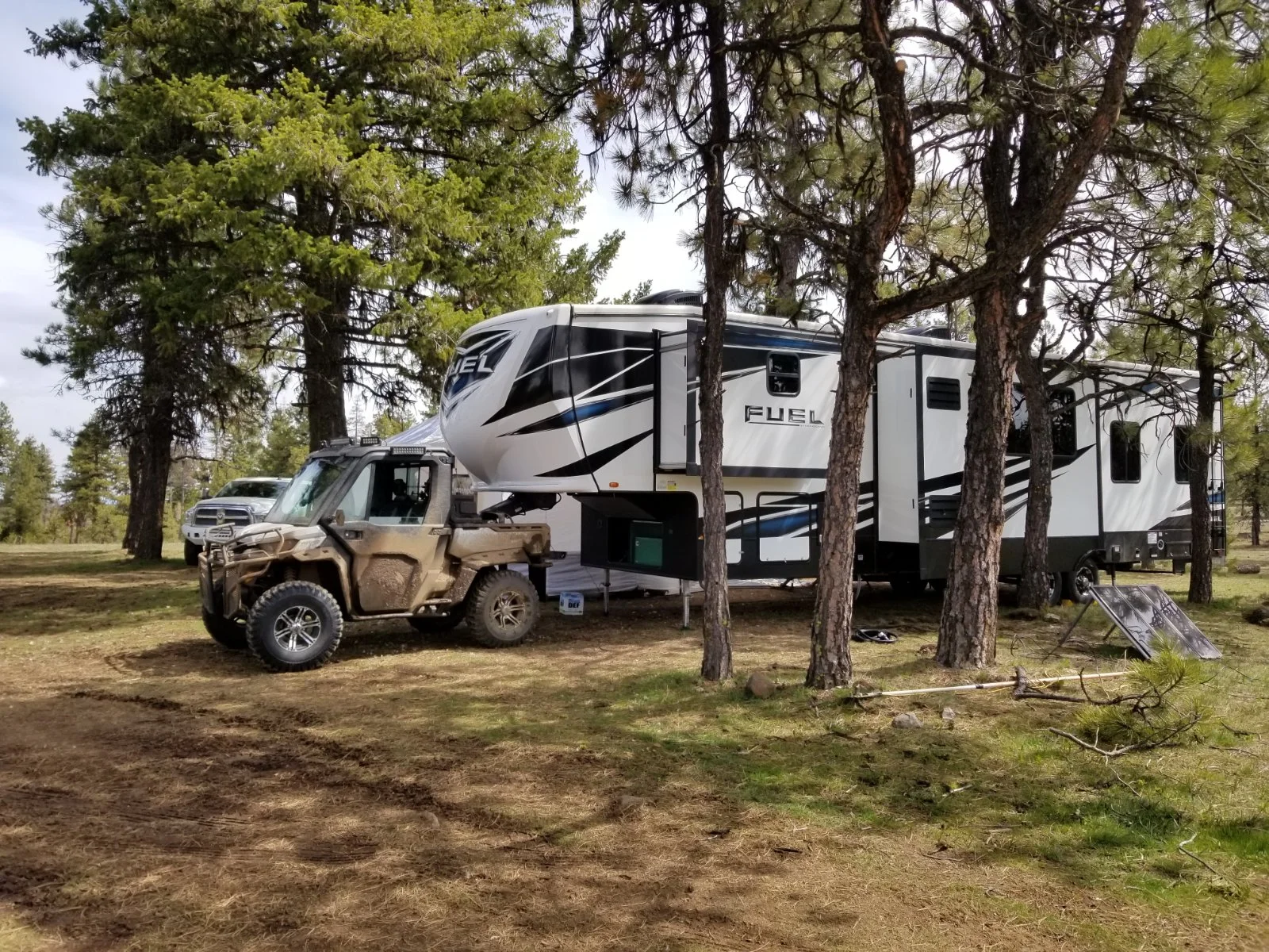

WELCOME to the forum!!! As for the door height??? While a STOCK defender sits around 80". Once you start adding tires taller than 29" and heaven forbid a lift..... a 7' door will be tight..... also, something to keep in mind.... Most doors with a cable system have the spring BELOW the door height. I bought a hauler with an 8' door...... sure it slides right through the door..... but the bunk beds hang below that and rub my rack...
Keep this in mind... You can ALWAYS get a smaller rig through a 8' door.... but you can MEVER  get a bigger rig through a 7'er..... just sayin'

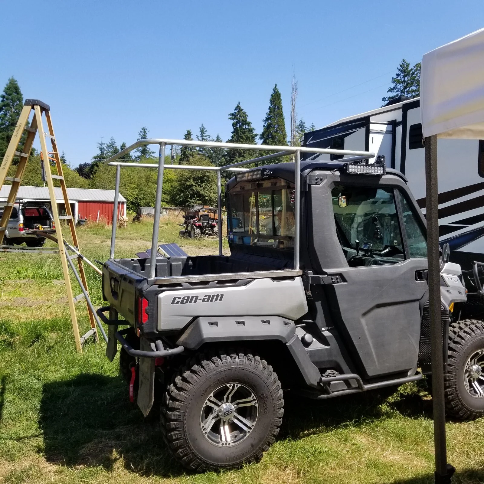

He's still tight in there!! While i strap him down with wheel straps.... I still need to compress the suspension some or he hits the beds above. Only when his rack is on.....

That number is probably taken with the shocks at mid spring adjustment. You could probably make it lower..... Not sure about you.... But i didn't buy a Defender to turn it into a Chica low rider with dingle balls, diamond tucked upholstery, and a chain link steering wheel.... lol... I like yer idea of having it custom made to fit yer beast... I happen to be a CUSTOM kind of guy!!! Just make sure you give yourself some room to GROW!!!

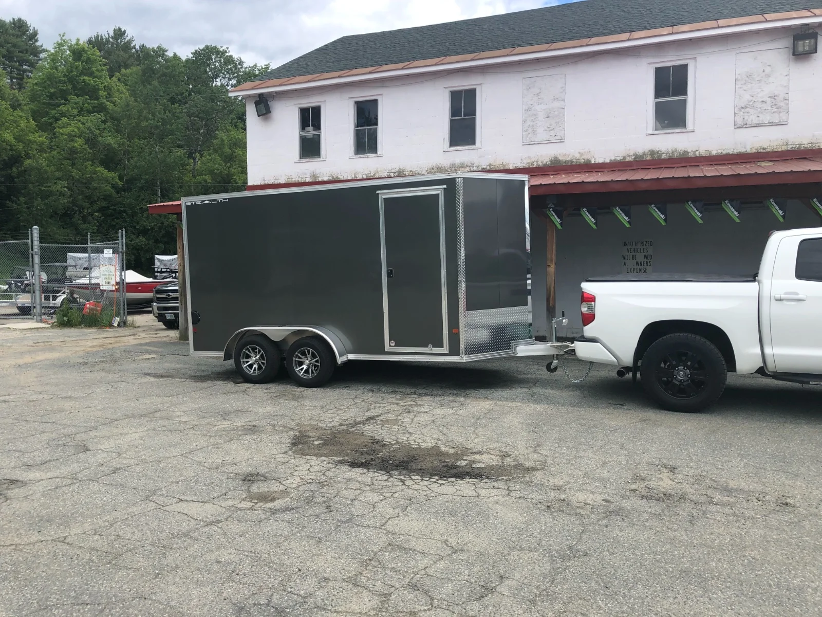

I picked up this 7X14 Alcom Stealth aluminum trailer which has a 84" interior height  for $6200 in April just when Covid was making things hard to get. The price has since jumped to $8500...Ouch!
I have a 2020 limited with tracks and it fits in 84" with 1/2" to spare. I was worried she wouldn't fit after i installed the tracks
