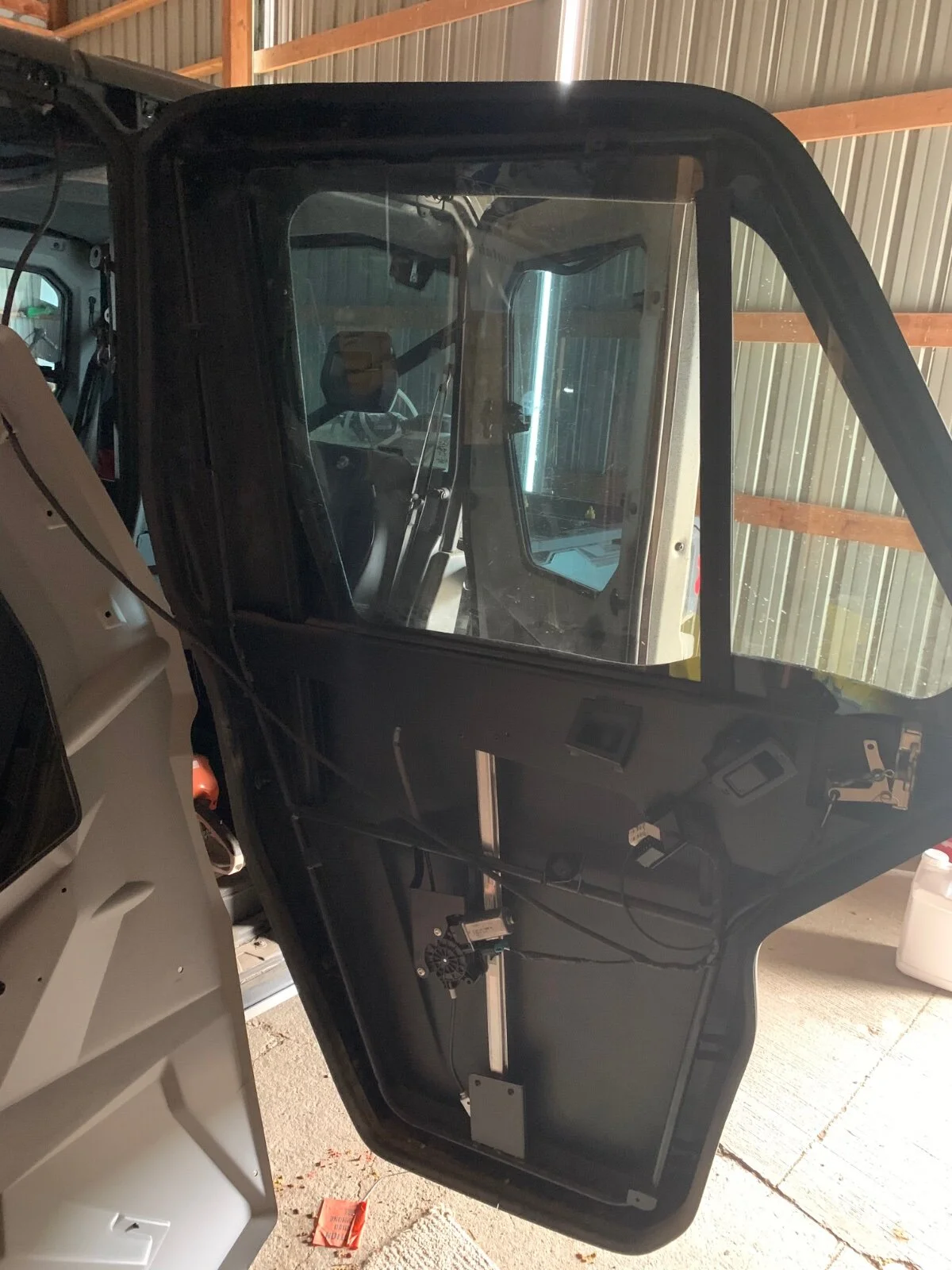

anyone remove the inside door panel to make tinting windows easier  2021 defender hd10 limited
Yep. Very easy to do. Need to remove all plastic push pins around perimeter of door.  A few of the plastic push pins came out harder than the rest. I have a supply to replace damaged ones. I would recommend having proper removal tool for these. Need to carefully remove window switch.  There is a screw to hold door
handle that needs to be removed.  Makes tinting a breeze.
