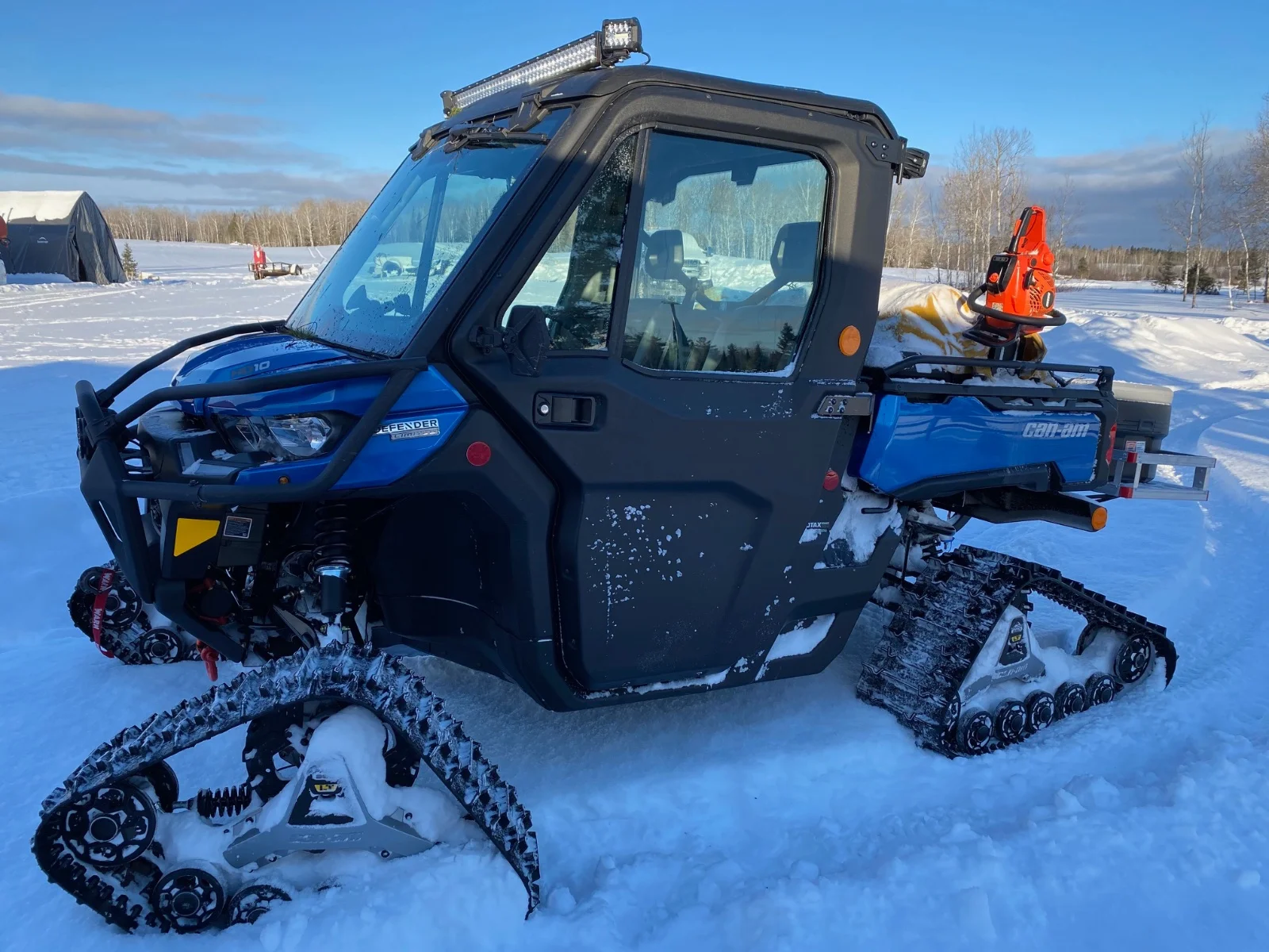

Yo, enjoying the snow in new defender HD10 with tracks and buch of accessories.

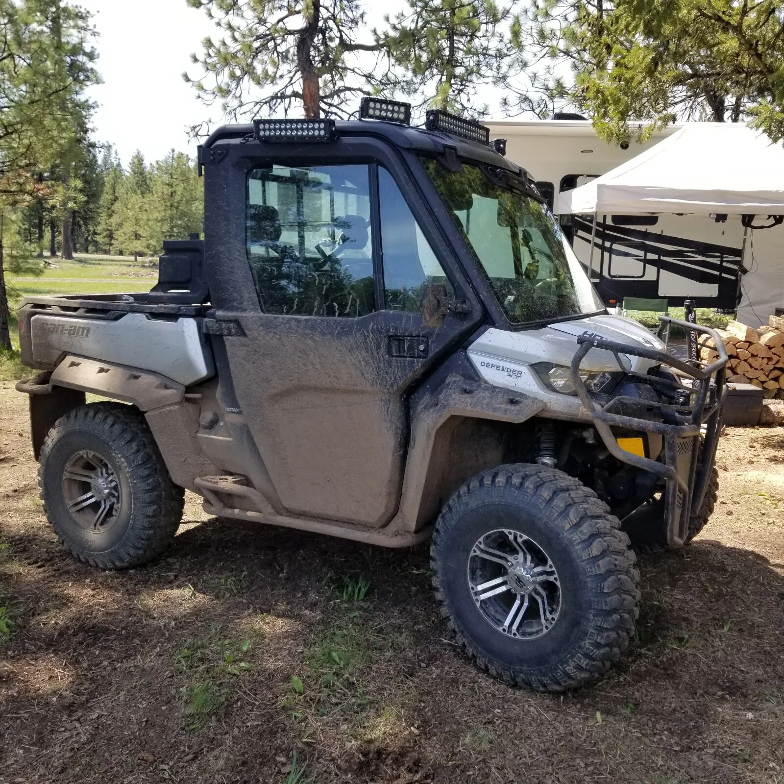

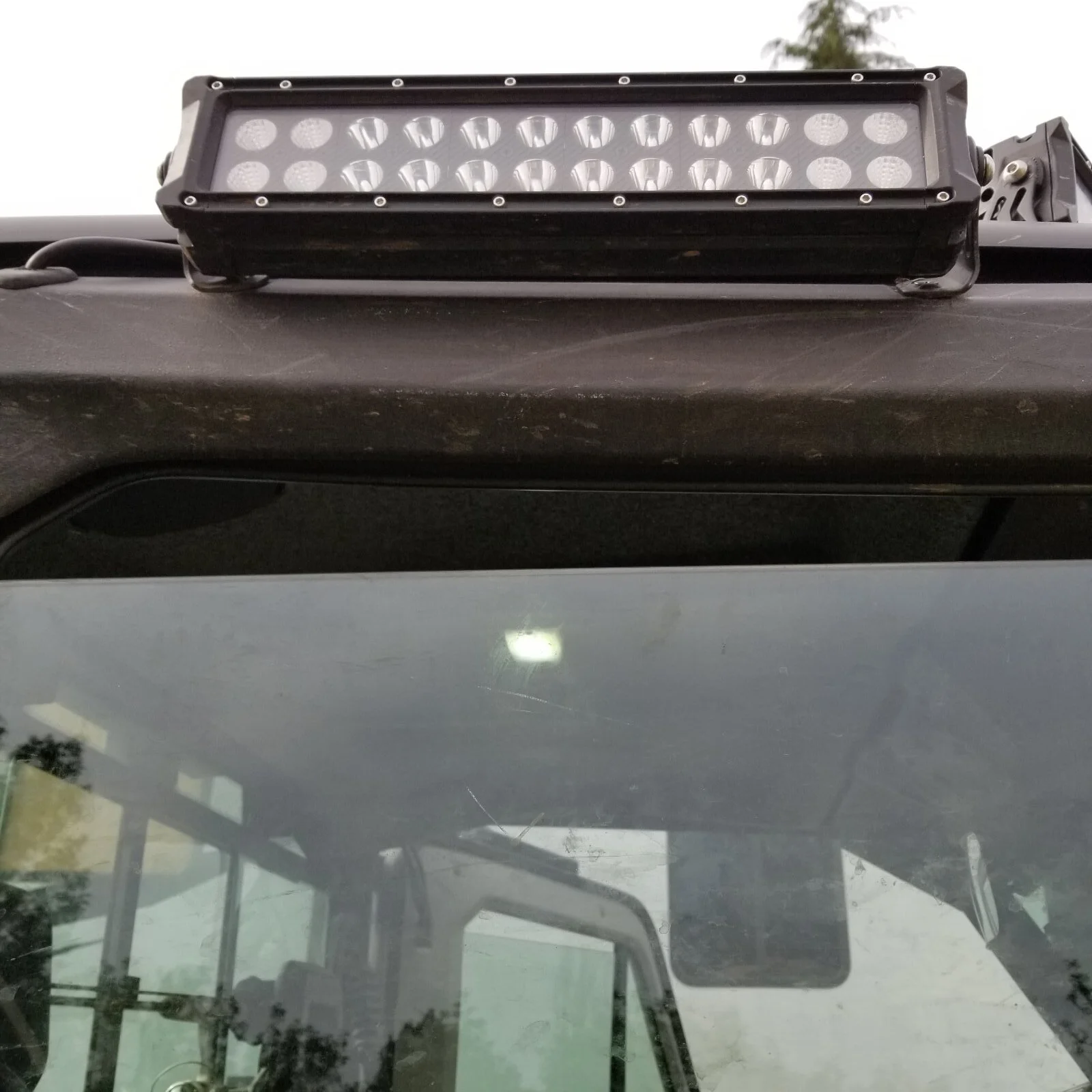

I need to add side lights like you have to illuminate the woods and see game at night.  I was going to mount on top but looks like you mounted just above door?  Can you send a close-up of your mounting?  Thanks!

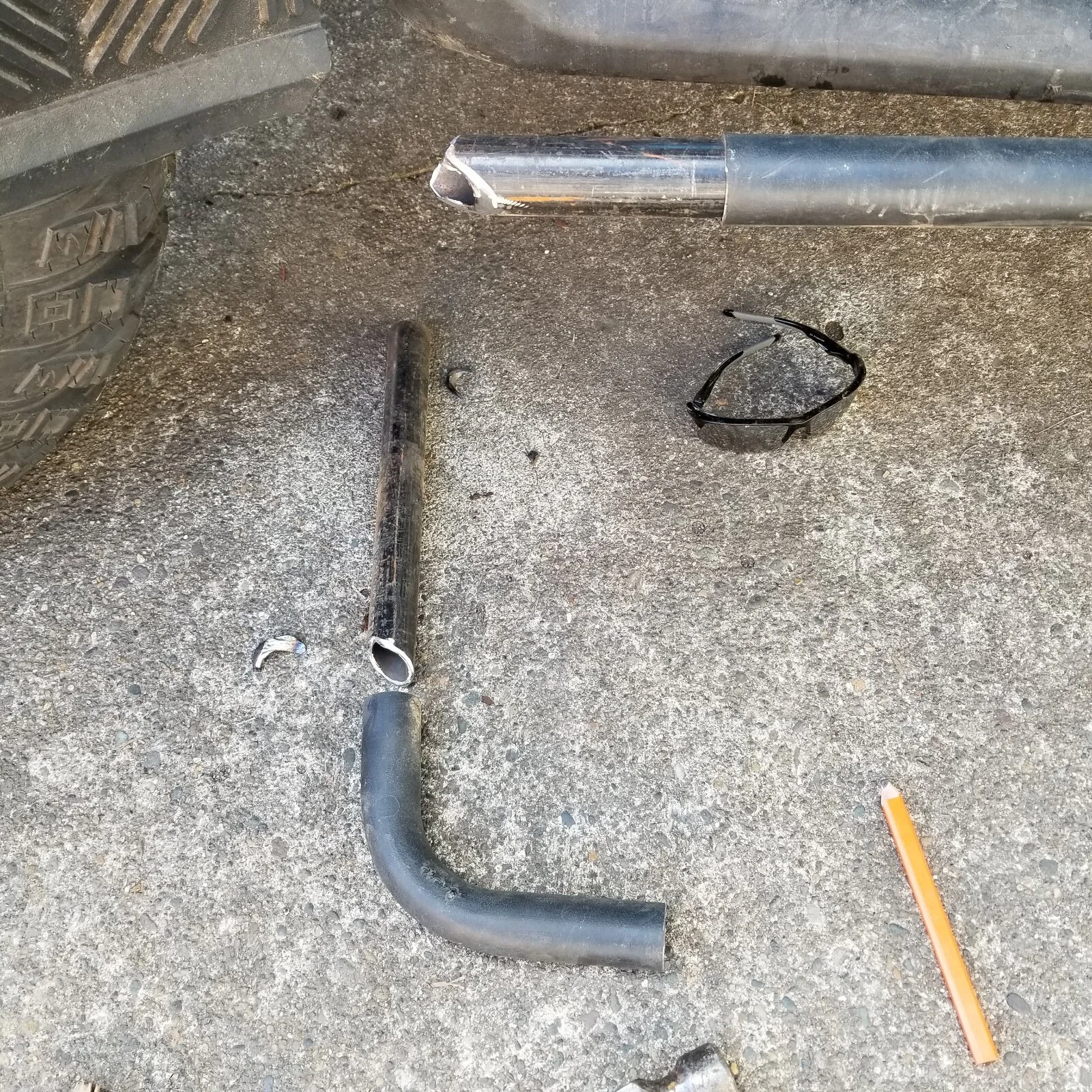

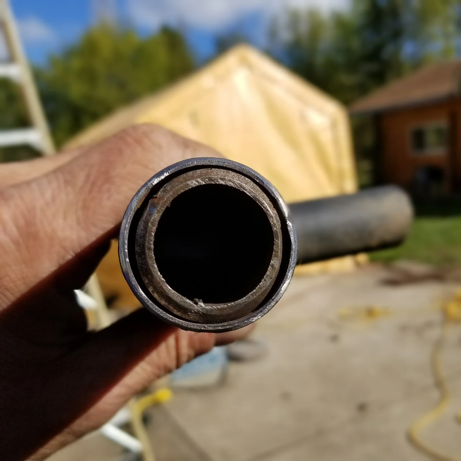

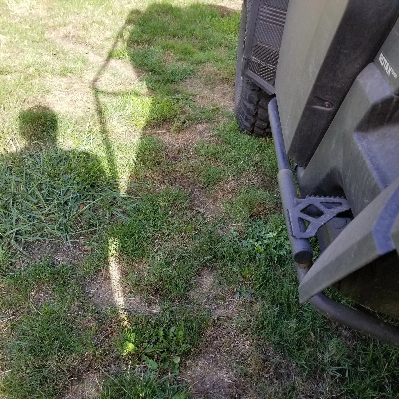

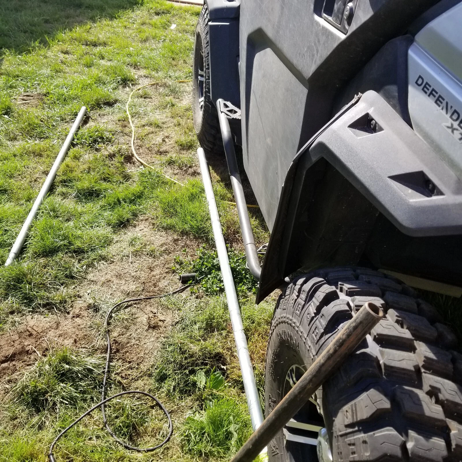

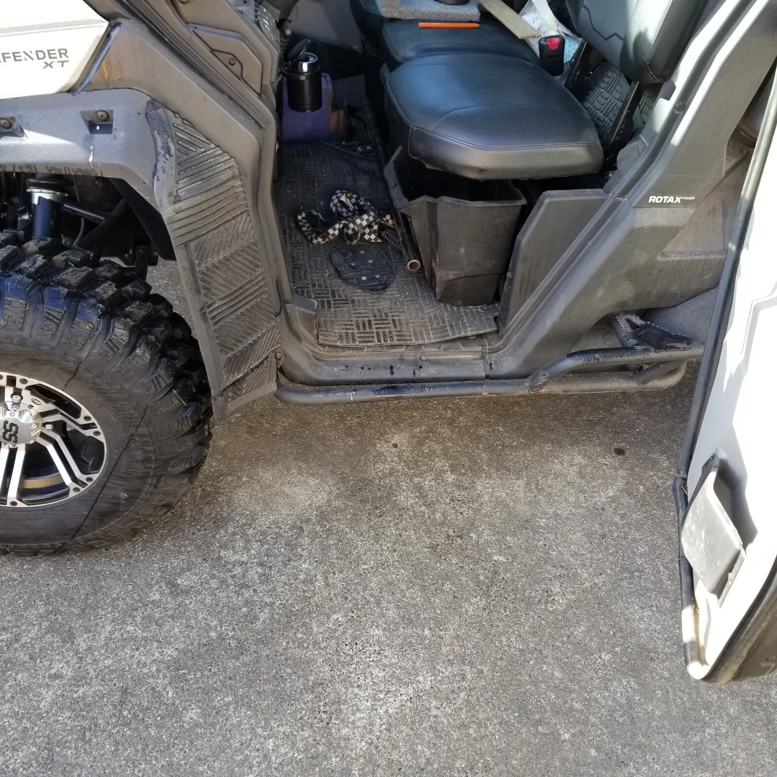

First off, my side lights mount in th same holes as my upper door skin mounts.. (factory position) as for the sliders...... OEM but HEAVILY MODIFIED... Cut apart to widen to match up with the 32x10's on 5+3 rims... and then cut so I could slide a THICK WALL pipe inside the metal conduit they used for the rails...
Hope these pics help....
I also has to add flare extensions for the larger tires... (you can kinda see them in the pics) I used a rear seat carpet cover for a mini van... (all I could find where I was) and it seems to work, and has grown on me... I was shooting for a semitrailer flap to modify for my extension.
Here is a better shot of the flap... and original location of rail. The rail now comes out to the width of the front tires which allows the snow to drop out and not jamb up under the door.
