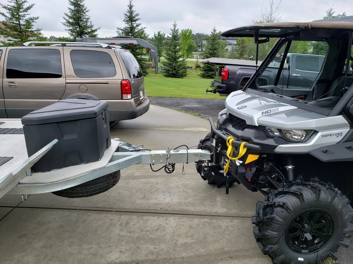

This is a Canam bolt on option 715003109 called the higher front receiver hitch mount, it bolts in as per instructions. I cut the plastic shield that you have to remove for this install and reinstalled it as a two piece so that it still keeps the mud from flying up onto the radiator.
The hitch is a Reese 3 hole adjustable for height, I leave it installed in front and if necessary I can use it in the back for a regular tow hitch as well. The trailer you see is a light tandem and the Defender manuevers it easily and into nice tight places. The front hitch is a  good option for backing a light boat trailer into the lake as well. FYI

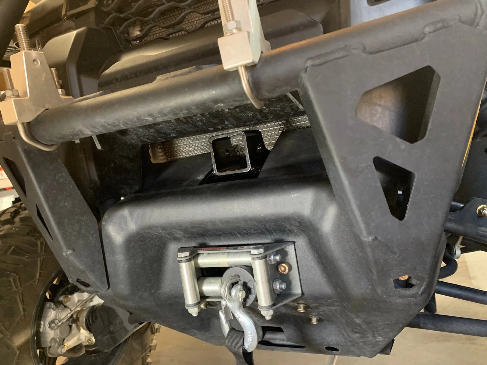

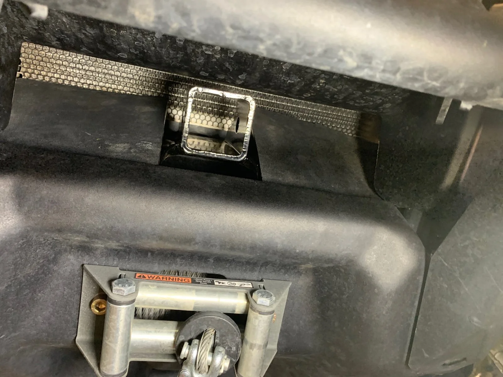

I got my high hitch receiver done this morning. Looks like it reinforces the whole front winch area pretty well too. I took Andy's advice and fabricated the stock radiator shroud to fit around the receiver. Thanks Andy!
Looks good, now you have to put it to work. I used a light adjustable hitch that can be used front or back.☺️
