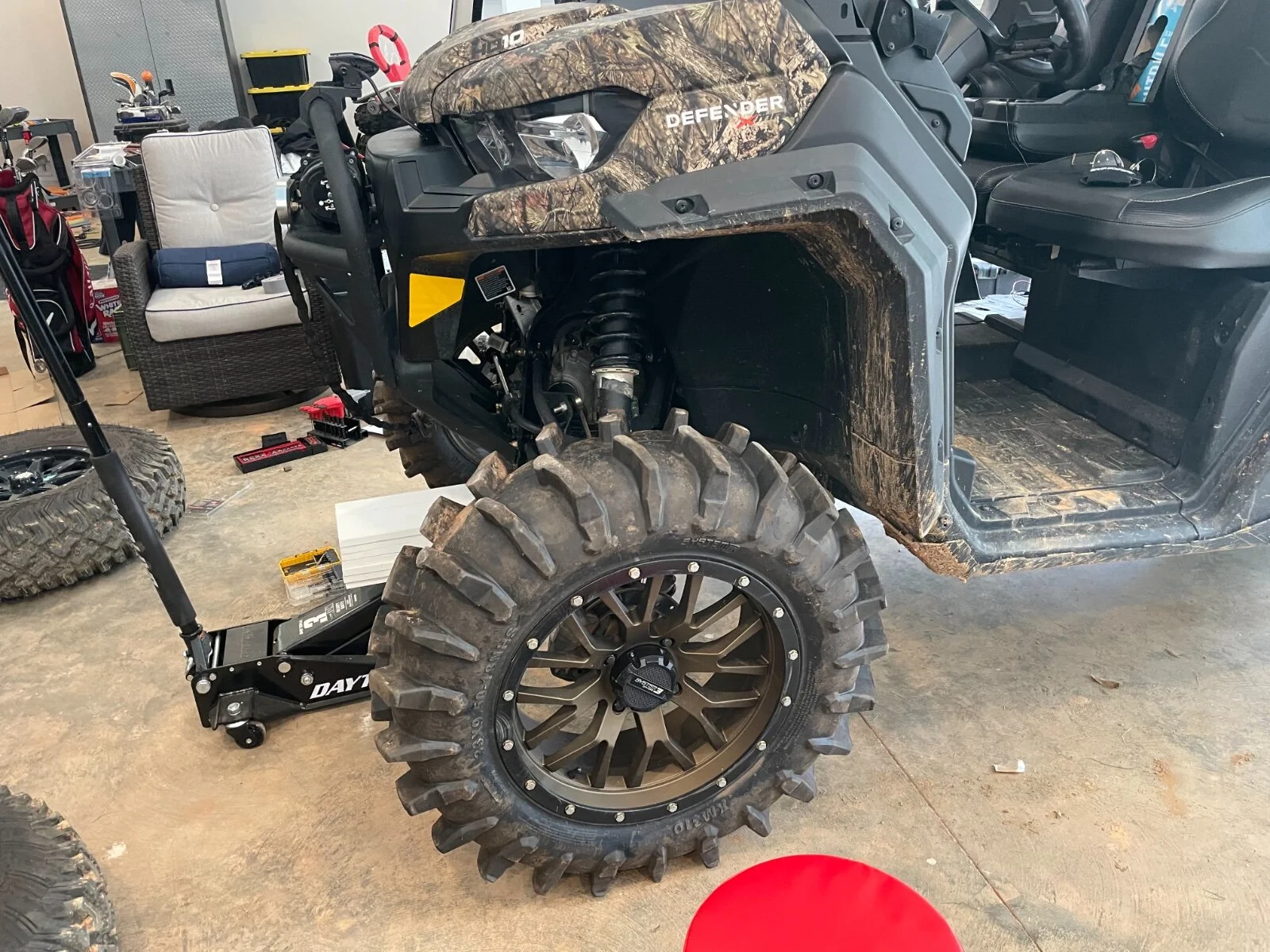

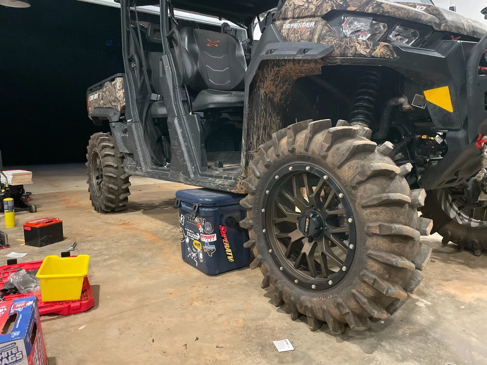

 So, The New Carnivore 32x10x14 tires are on the unit. Installed on Stock Rims. Aprox. 1,000 kms on them now. Highly recommend these. After the Horrible riding Cryptids these are now like driving a machine with Marshmallow wheels! So smooth, no vibrations. They Rock!  Plus 2" free extra inches of ground clearance!!

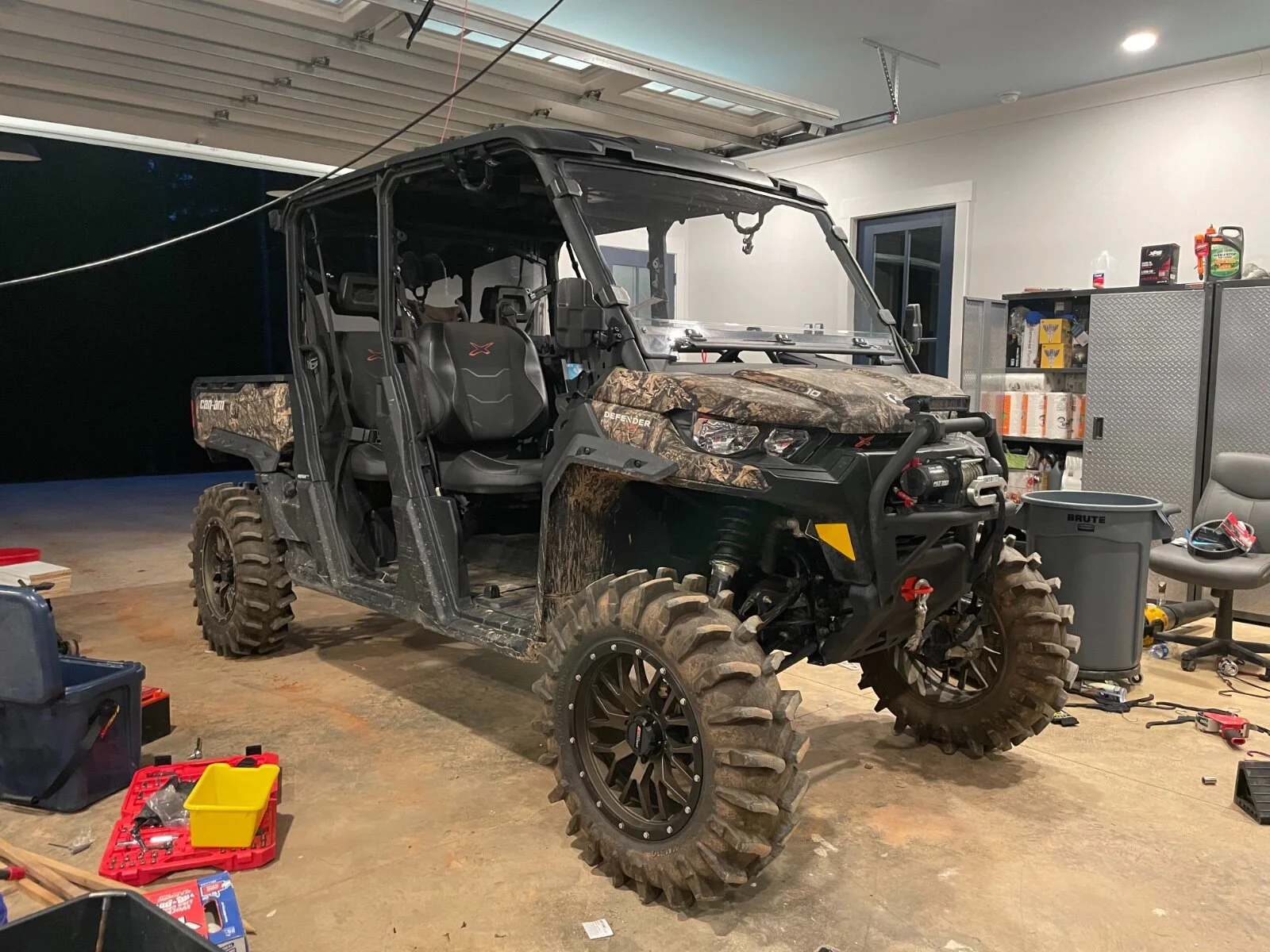

I’m running 33s no scrub. Small bracket lift. I looked at the 6 inch lift to run 35s vs the forward arms. I’d like to be just a little taller
