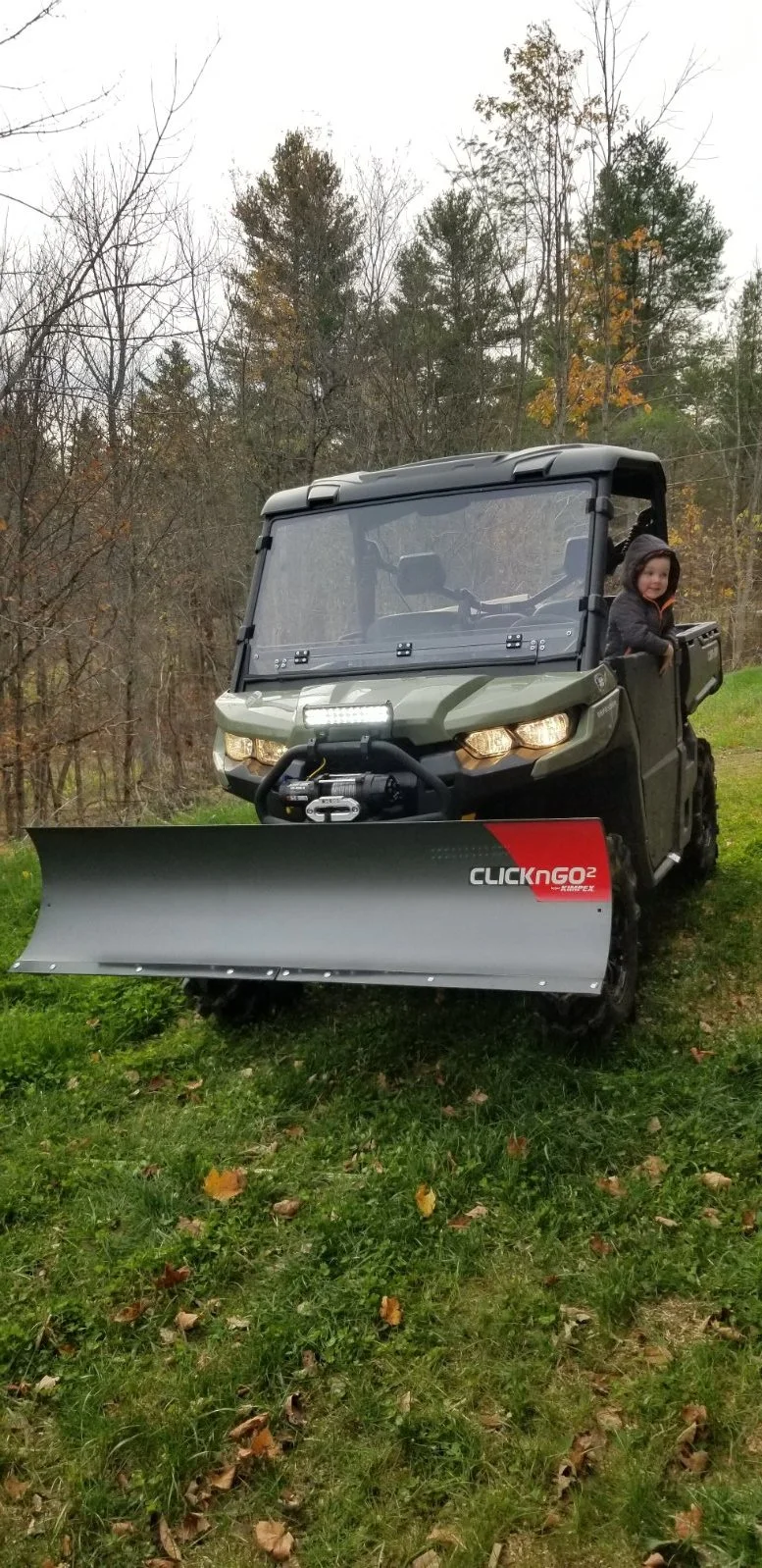

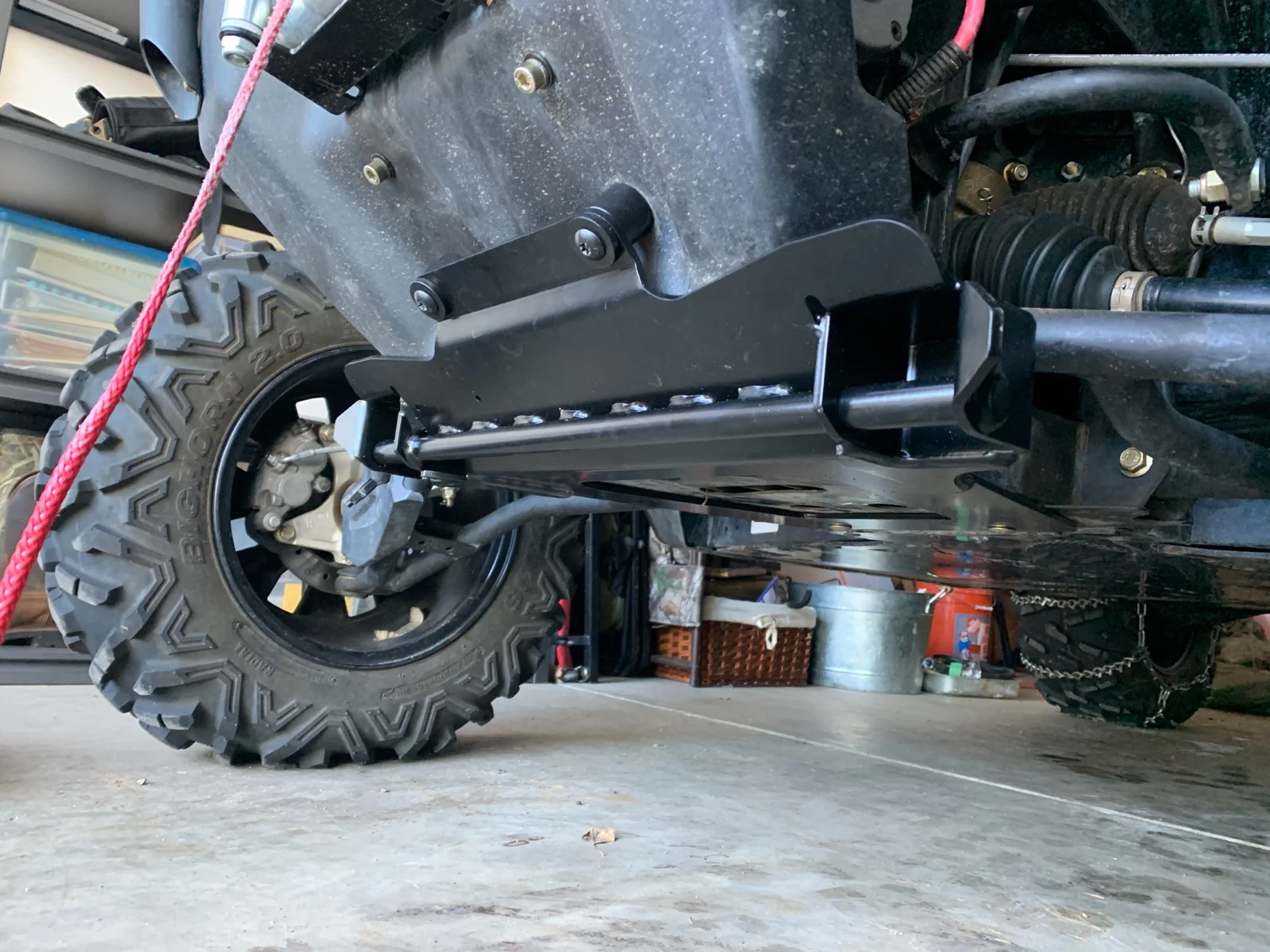

I found a nice used 72" Moose snow plow on Craigslist for cheap money. I then ordered a KFI mounting plate from Amazon for $18 and welded tabs that fit the Moose push arms. My total investment is less than $300.

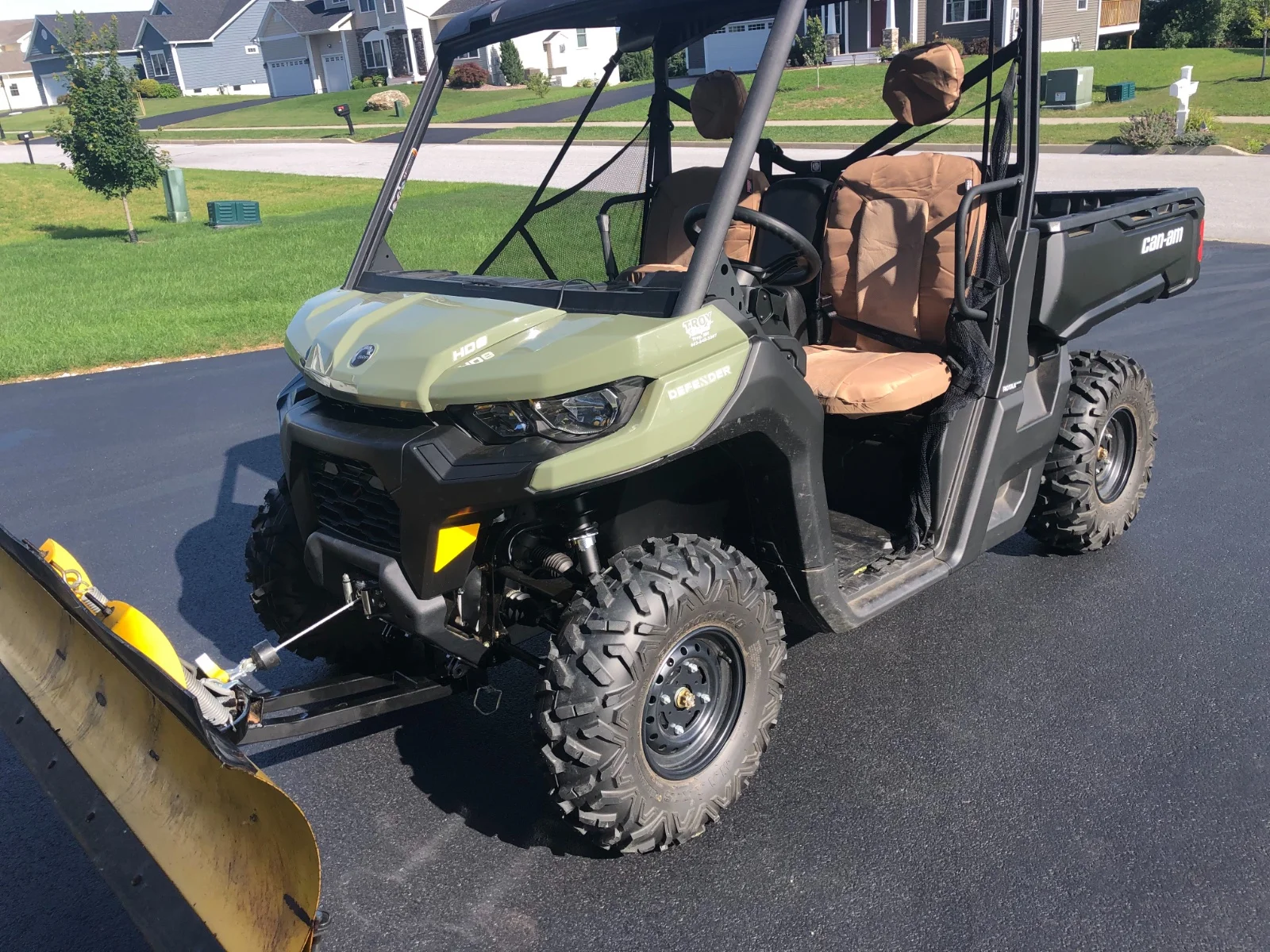

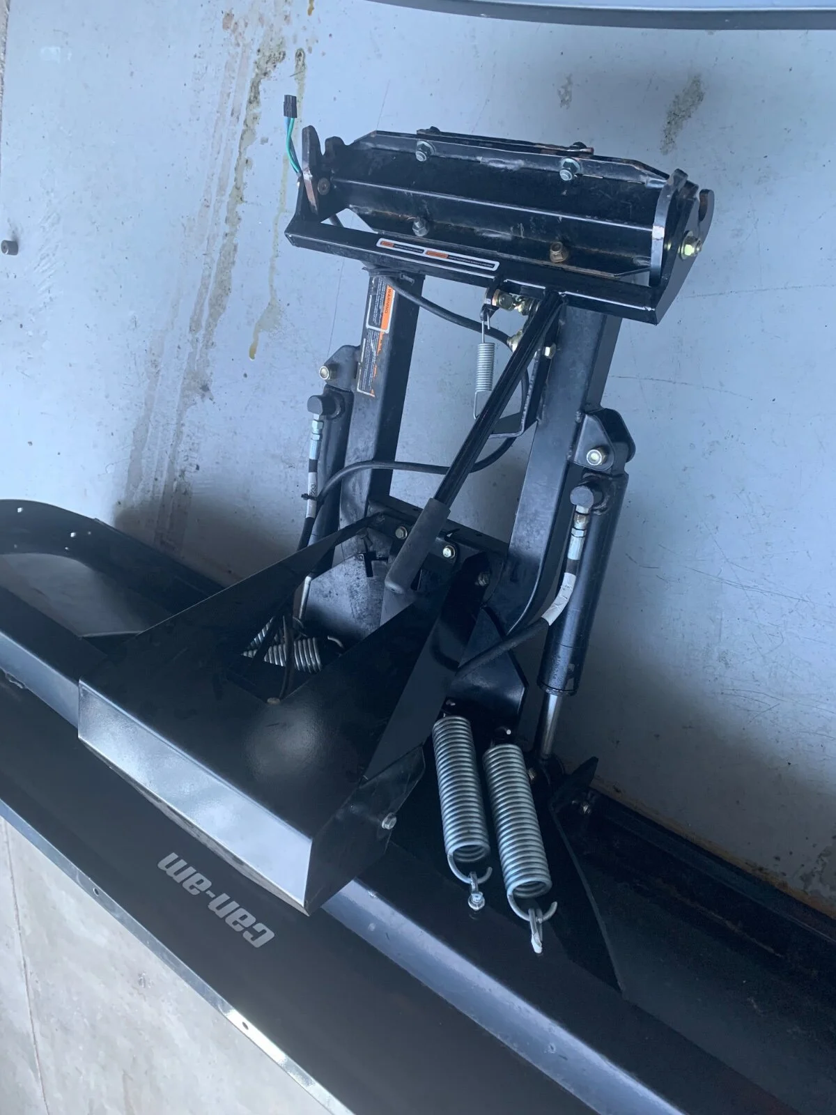

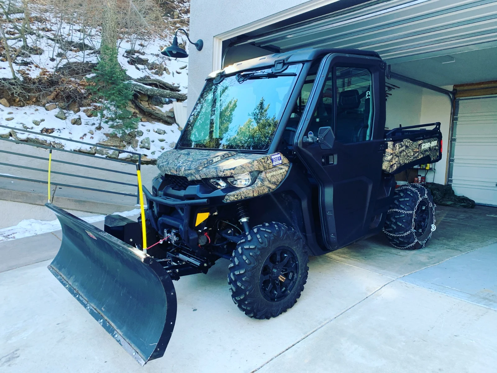

Look no farther than the Can Am Super Duty Plow.  It’s the only one they make that isn’t really a “driveway toy”.  You can actually use it, and use it hard on multiple surfaces.   Mine has a 72” blade, Hydraulic angling, winch lift (I use a SuperWinch 4000 + a fairlead upgrade) and easy cab joystick control.  Parts at your dealership, or on-line.  I run Can Am chains on the rear tires as well.  About $1800 installed.  Get a light bar if you’re running at night, and if you don’t have wiper/defroster, that’s also a good idea.  Good luck.  - Mark
