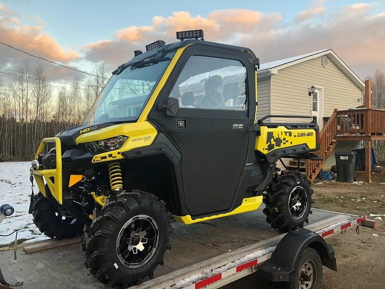

I have a 2019 Defender HD10 XMR and it comes with 30 inch ITP Cryptid tires.  Factory settings are 14 lbs in the front and 26 lbs in the rear, however I too am wondering if the pressure should be changed to a lower value.  Not so much in the front but the rear tires are 26 lbs.  I guess it would depend on whether or not I am loading the box up or not.  So far I have only put a couple of 20 L fuel containers and a chainsaw in the box so lowering the rear a bit might be a good idea.
[SIZE=11pt][/SIZE]
I just tried my Defender XMR  with 12 lbs in front and 18 lbs in rear and it still a bit rough.  I don’t want to go too far below factory since I am not running a bead lock rim.  Anybody running the same rig with lower pressures?

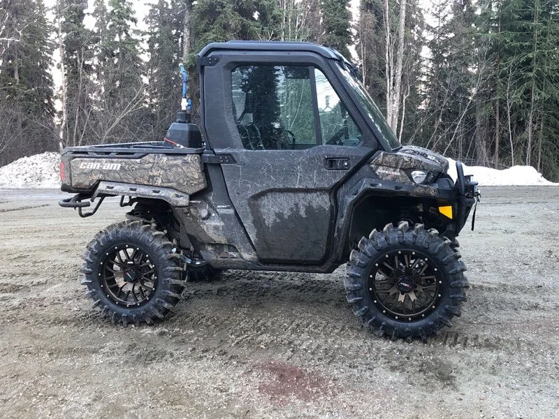

2019 Defender XT Cab HD10, with stock 27" tires the factory recommended tire pressure is 14 psi front and 18 psi rear. I have 30x10x14 front and 30x11x14 rear Cryptid tires on now and am 15 psi front and 18 psi rear with light loads. I might consider going down to 12 psi front and 15 psi rear in the future but no lower. At my current inflation pressures the ride is very nice on hard pack or trail so I don't see the need to lower the inflation unless we do a lot of muskeg riding later in the fall where a bit more sidewall flex might be advantageous.
If you are doing fairly fast trail riding on a rutted trail I would definitely error on the higher side for air pressure to prevent the tire from rolling under when cornering and breaking the bead.
I used to run 4 psi all around on my 1000 Outlander that had 28x12x12 all around but that machine weighed less than 1/2 of the Defender when loaded and I usually rode slowly 10-30 mph, however, I never had any tire problems.🐌 FWIW
