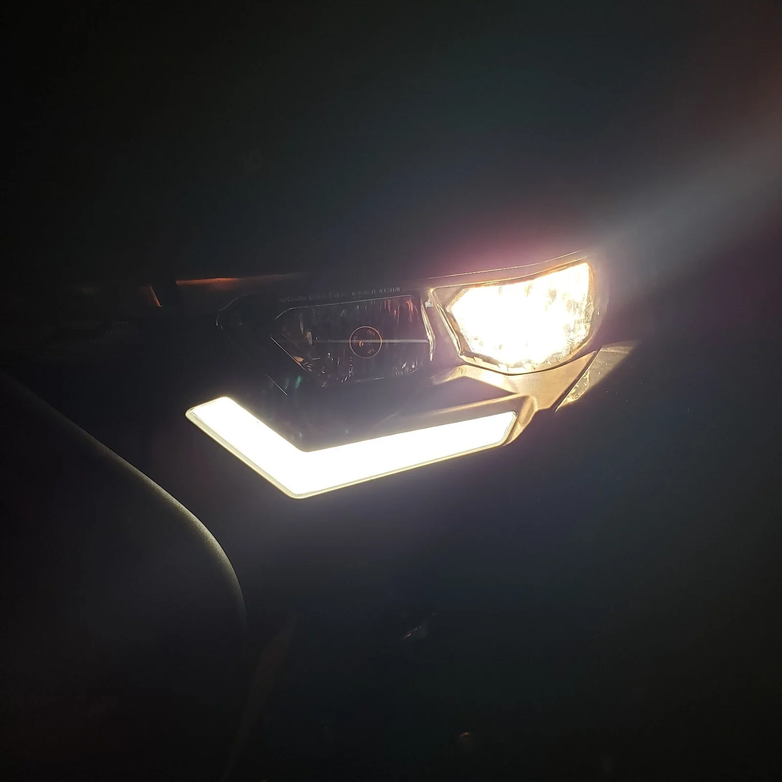

My 2020 lonestar didn't have the signature lights.  I really liked the look on the limited models so I bought some.  Install was super easy and looks great.

Did you have to add another switch for these lights? I just added them to a 2021 and can not get them to turn on.
I have a 2021 Defender and installed signature lights and have the same issue as ejl22boo, they will not turn on.  Has anyone figured this out?  Looking for advice.

I have them on my lonestar. I have to turn my lights on for them to come on. I want to rig them up so when I turn rhe key on they come on.
In MN, we're required to have headlights on at all times during operation of ATVs/SxSs. So I just leave my headlight switch on.
Have the same issue with my 21 defender.  It is not a lone star or limited edition.  What did you guys figure out?
Has anyone come up with a fix? I have the stock wiring but did not have the lights when I got my 2020 defender max. Plugged the stock wiring harness into the signature light and turned the headlights on and still nothing.

I had a bad connection on one of my stock canam driving light plugs. The driver side worked as advertised so I just cut the connector of the bad side and spliced the wires together directly and it worked like a champ!
