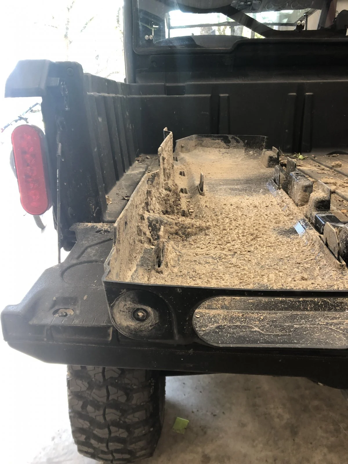

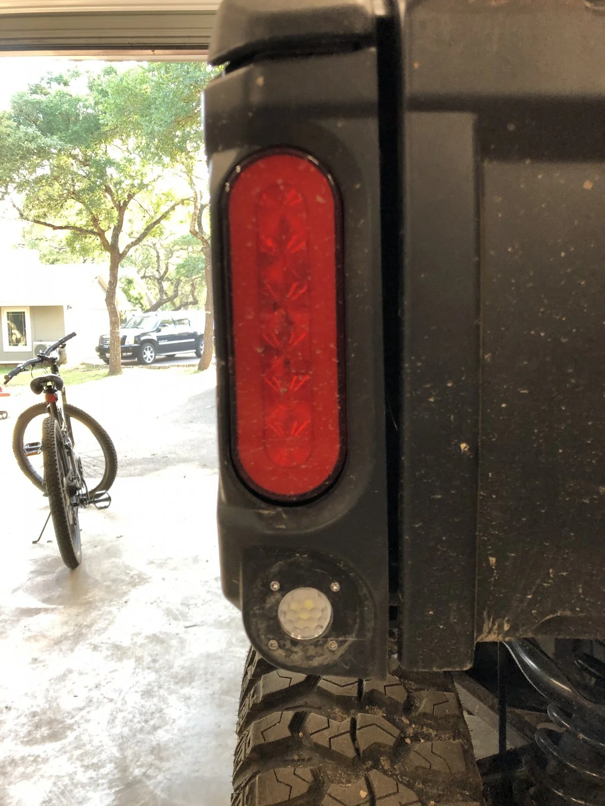

Just finished these rigid backup light in the reflector position. These are 1000 lumens and are very bright for the size of the light. I wanted to go for a factory look and I’m happy with the end result. If anything that I may add is a cover plate to strengthen the mount plate. But the plastic is pretty sturdy.
I am looking to something similar to my 2020 HD8.  Where did you purchase the lights and who makes them? Thanks in advance...
These are ignite backup lights Made by rigid. I got them on amazon.
