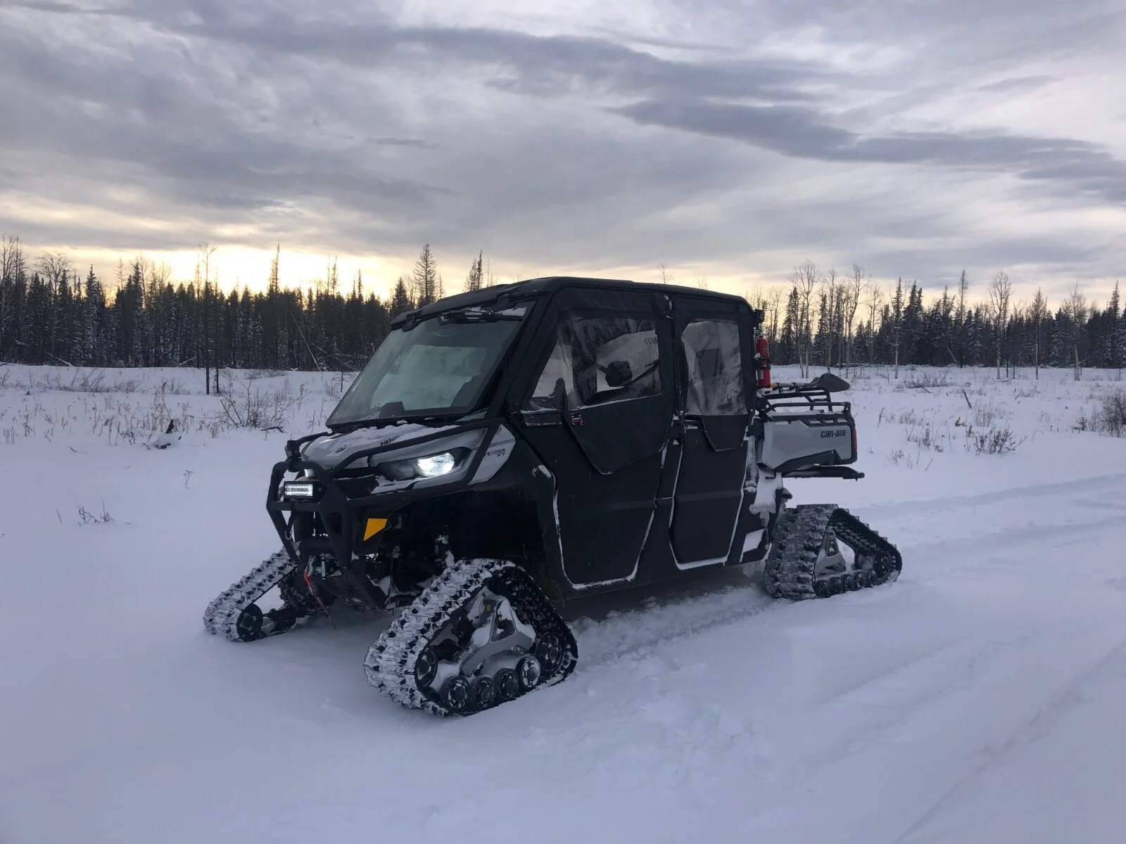

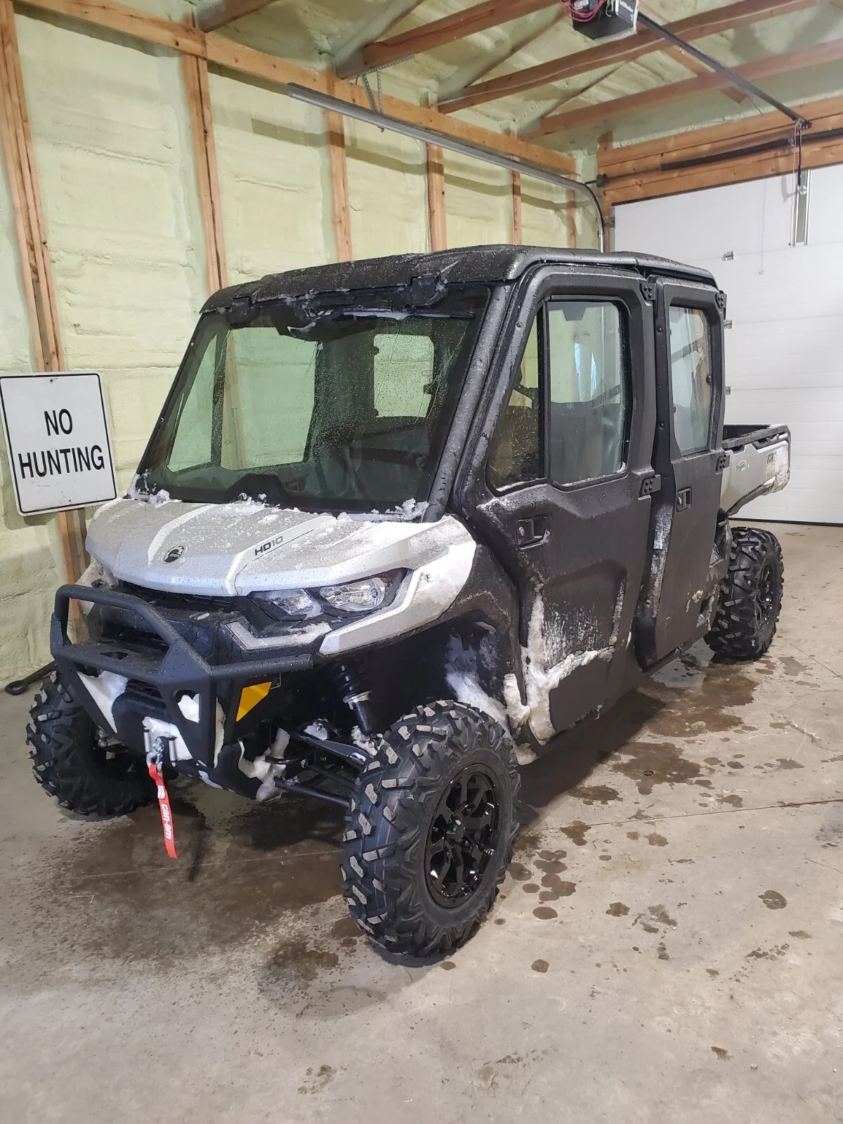

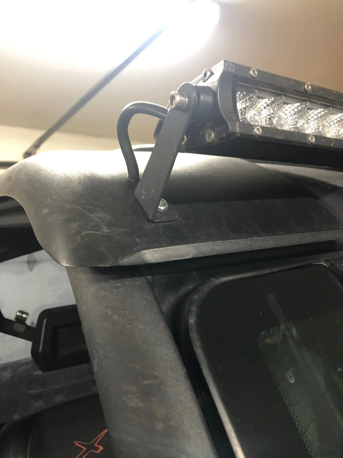

Rigid 10”
Rigid Dually Diffused put back
chainsaw mount
fire extinguisher mount
shovel/axe mount
front hitch
remote for winch useful when plowing mounted to gear selector
plow and mount
bed net tiedown
heated seats
front racks
rear rack in box with cooler and one below box
led headlights
tracks 360LT   wanted backcountry but haven’t got stuck yet, lol
belt and removal kit
next up is insulation.
Hence the name, DeFunder

Nice rig, do you have any additional pictures of your chainsaw mount, shovel etc... Thanks

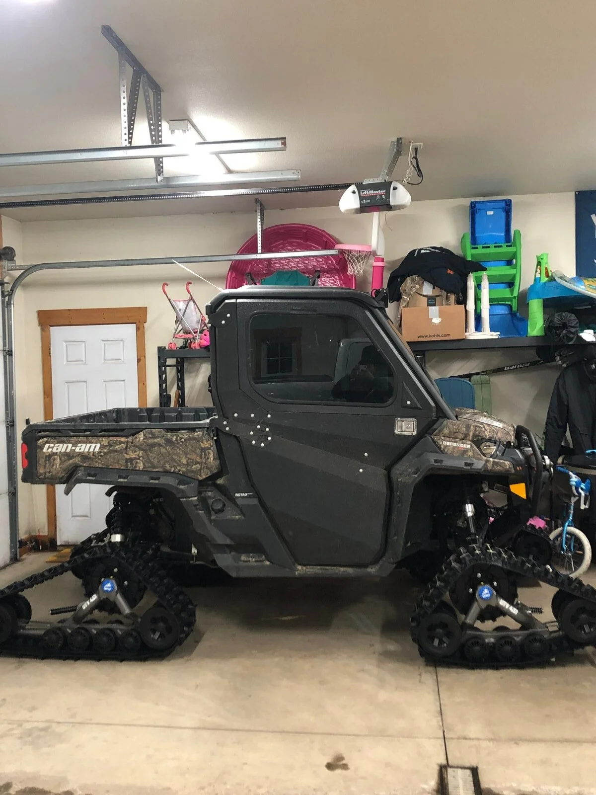

I'm running an Xmr, so a lot of stuff I added yours already came with haha, but:

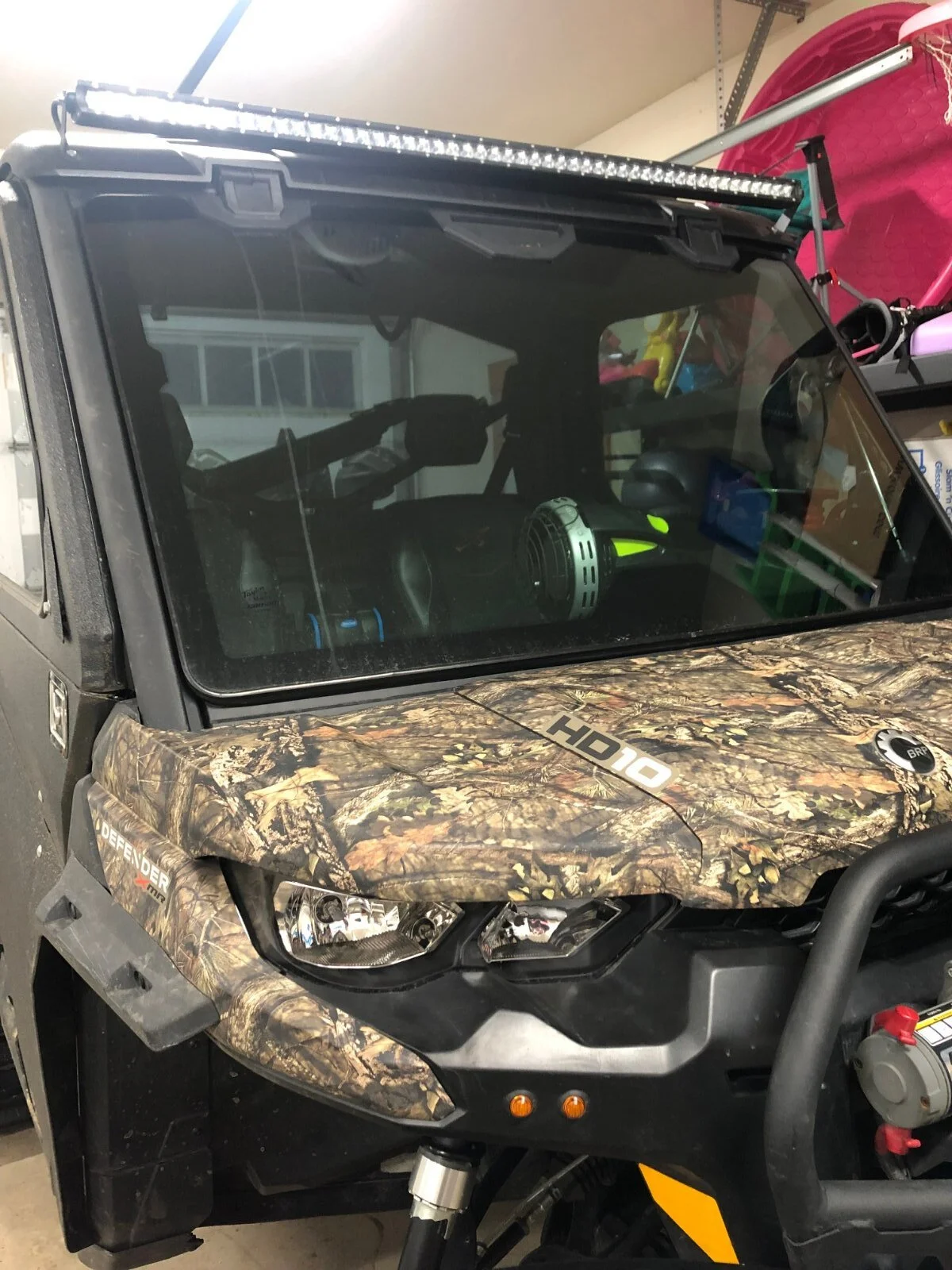

I went with a 50in single row LED light bar above the windshield and a little 6in LED light bar in the back of the cab for a work light.  Both lights work very well and I have yet to wish for more light.
I installed the spring spacers in mine.  Gave it a 3in lift, allows more travel in the stock shocks and it doesn't allow the geometry of the a-arms and axles to travel past OEM dimensions since you are still using the stock shock and not adding length to either end of the shock.

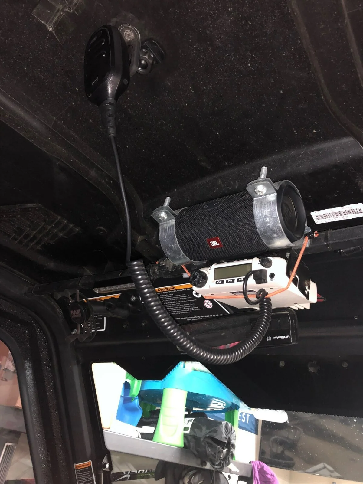

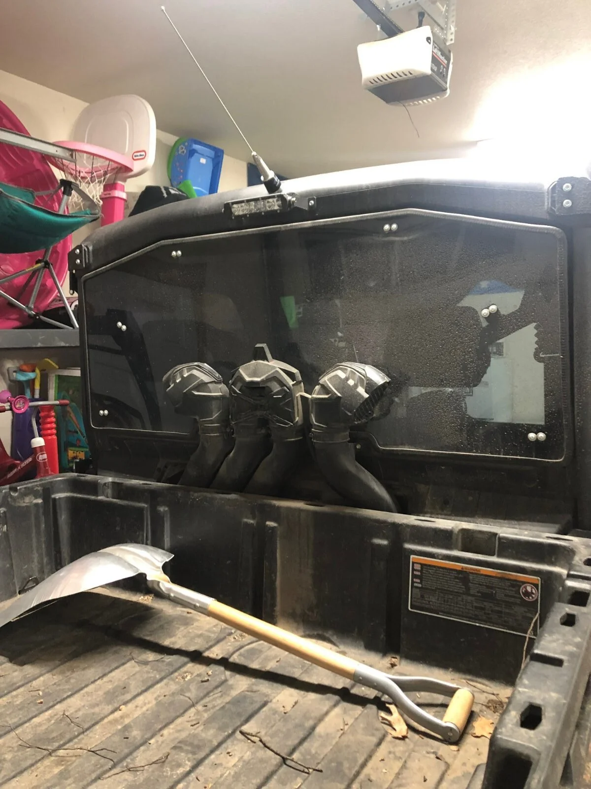

I installed a rugged radios 60 watt VHF radio that might be a little over kill.  I've tested the distance of communication to about 19 miles in the woods, but that was me talking to the cabin that has a bigger fiberglass antenna.  Haven't tested the distance from machine to machine yet, but I have not had an issue communicating with other machines a few miles away.

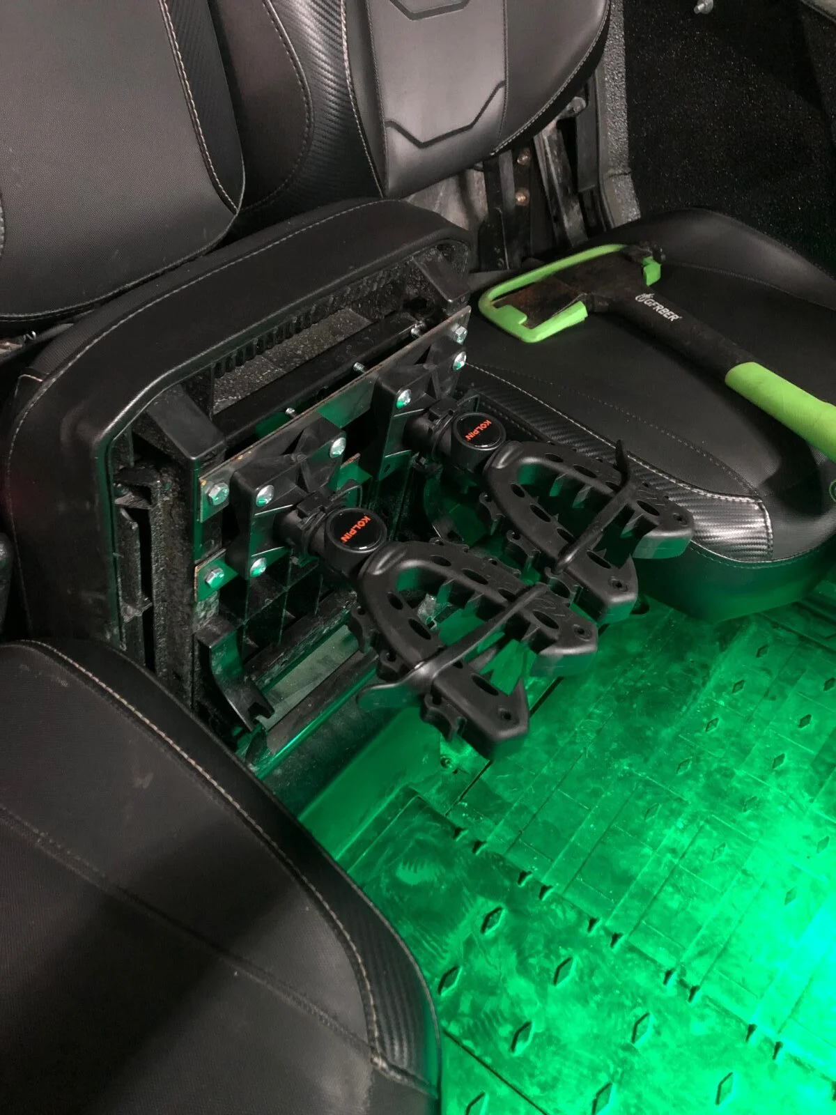

I installed Koplin gun holders under the middle seat.  They work way better than the foam mounts that just get seat belted in.  I think they are Seizmik brand...  a friend has that in his ranger premium and they are a nuisance to use and store.
I installed the Corbin turn signal kit witch was a breeze.  Everything was plug and play just as they advertised.
For tires I'm running 31x10x14 with zero issues.
As far as tracks go, I've only had Camso tracks and have had zero issues with them.  I've heard from friends with the 360 tracks that hey also have had zero issues.

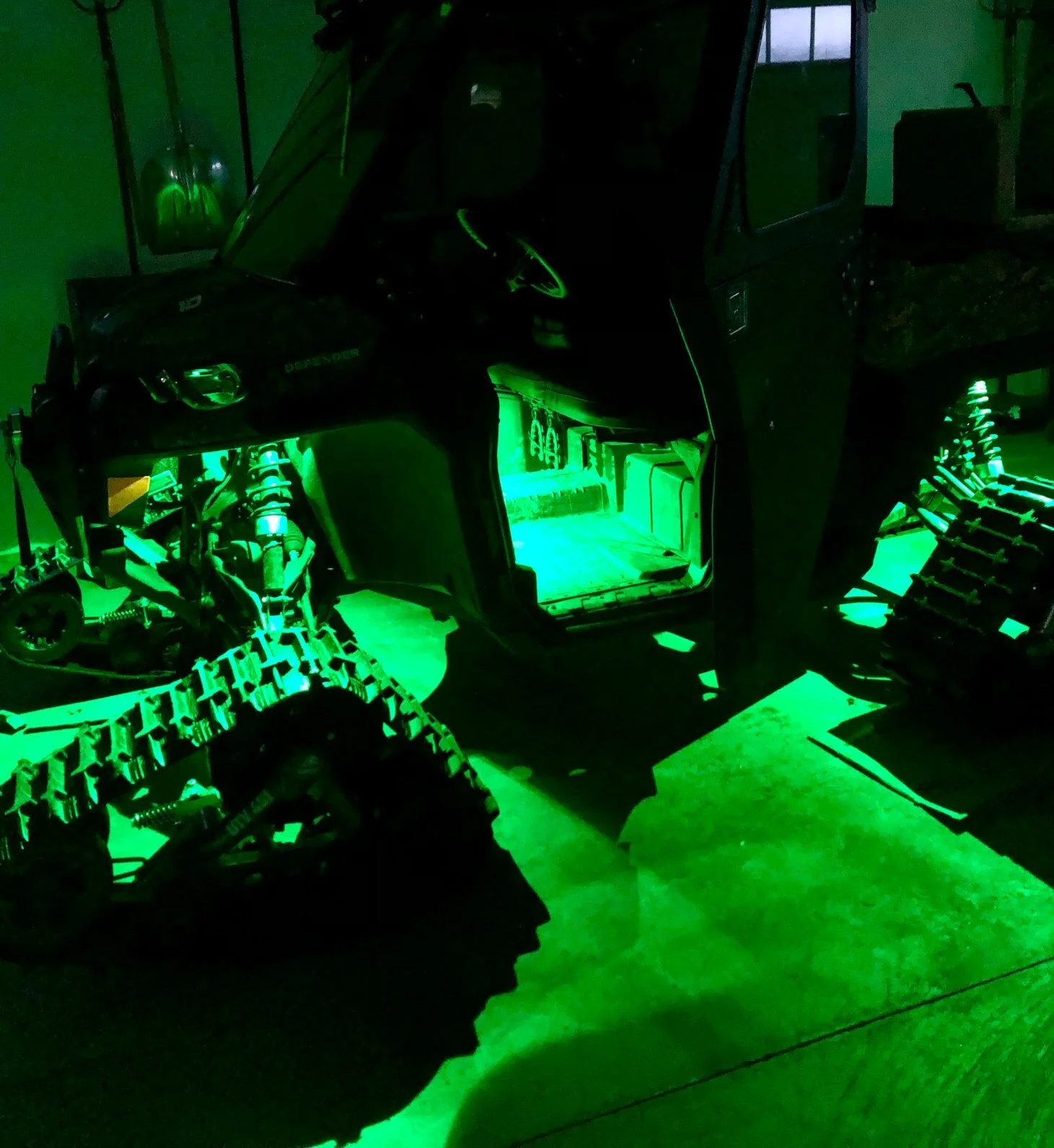

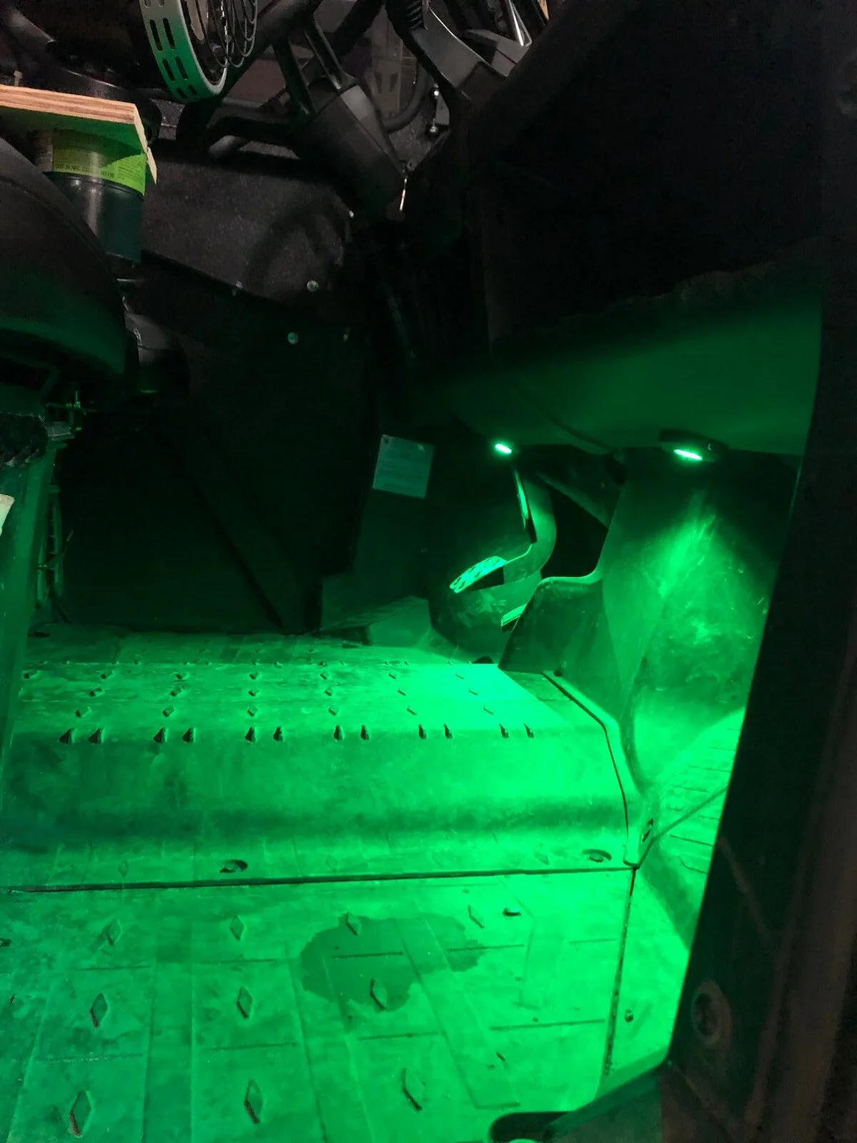

And for fun I installed cheapo LED color changing rock lights from amazon.  I went with 6 lights and put 1 in each fender and 2 in the cab so the lights match when the doors are open, and its kind of nice have a little light in the cab while driving without having to turn on the dome light.

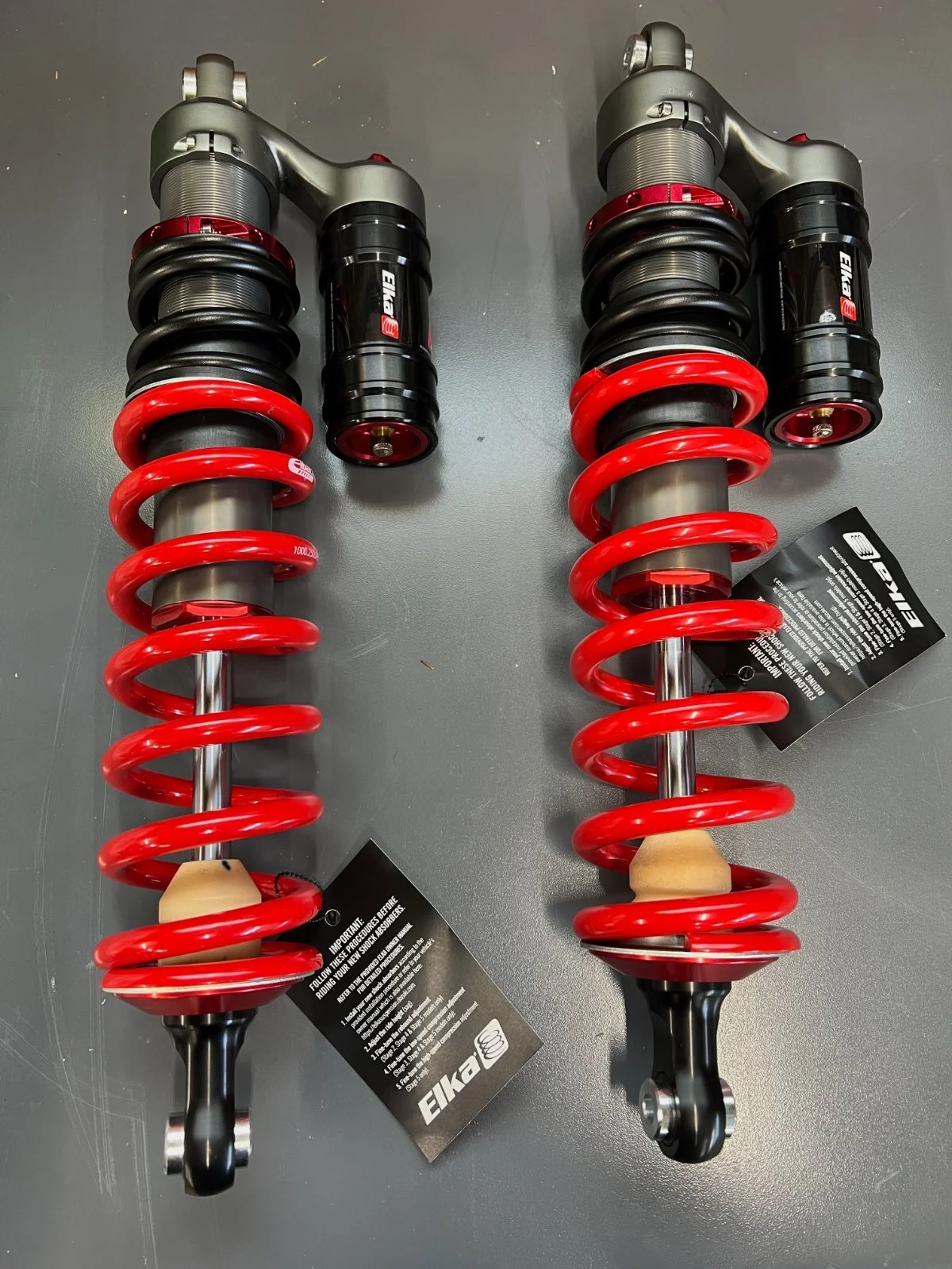

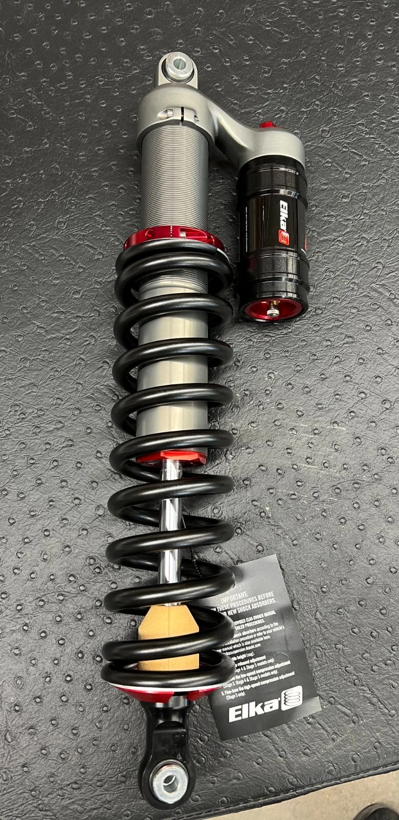

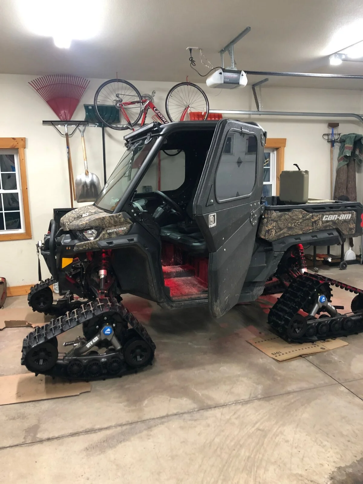

Super happy with Elka Suspension upgrade I did to my 2021 Defender Limited (not Max). After buying the machine I upgraded the springs to S3 to handle a Western V plow which is a pretty hefty 400lbs. While the ride with the S3 springs is "ok" they are too stiff to go hard over rough terrain. Decided to get a set of piggyback shocks for summertime trail riding and landed on the Elka Stage 3 shocks. I've had them on for a couple of weeks now and they are fantastic. Soaking up some really rough terrain now.

I had Elkas on my Outlander, they worked well.
You’ll get more range out of that VHF antenna, if it’s used when vertical.
Did you put in a special request to get dual rate springs on those or did they just come that way? And was that for the front or back (it looks like you got single and dual rates)?
I’m trying to order the Stage 5’s for my 2022 Limited and want to get dual rates all around if it’s an option. The Elka part numbers that I’m looking for are 30629 and 30634.
If anyone else has had experience with Elka’s on their Defender, I would appreciate any input, reviews, etc. I’ve found some information out there, but it’s quite limited. Thanks.
I just put Elka stage 3 on my 2021 XT HD10 yesterday. Just driving around the yard I can tell a difference. The only thing is that the back seems to be lower than the front now. I might have to crank up the pre load on the back a little to level it. Did you notice that with yours?
I ordered the stage 5’s a little over a month ago, but haven’t received them yet. From what I’ve heard, I may need to crank up the preload from their settings if I don’t want to lose ground clearance.
I’ll have to do some testing to see if 1-2” lower noticeably improves the ride. If not, I’ll take the ground clearance (likely where I’ll end up).
