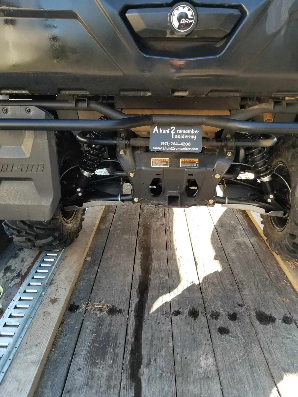

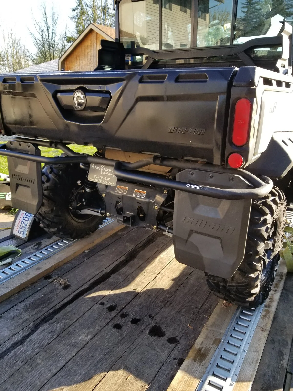

Welcome to the forum. Have you looked at www.superatv.com ? I have a 19 and will be getting their deluxe kit. I'll let you know how it goes. As for a plate bracket/light. While I haven't added a light to it, I will go take a picture of what I did.

Just took a piece of sheet metal and cut a piece large enough for what I wanted plus a tab upward to mount it to the back side of the bumper with two self tapping screws... Hope this helps. As for a light? You could get a plate light from most any auto parts house and mount it..... Hold on.... revamp on sheet metal... if you add say 4" above the plate you need to show and bend it at a 90* angle 1.25" above the plate. You will end up with 1.5" +/- to mount the plate light to.
