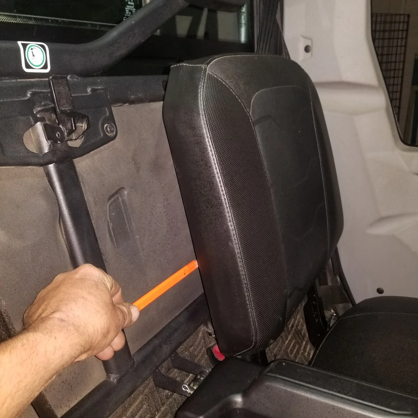

New to the forum and just  bought a 2020 Defender HD8.  Hope someone can help me out. Wife made camo seat covers for my defender bottom seat and they look great.  However, I was going to remove the seat back rest and cannot figure out how to get the seat pulled off.  I cannot ever find where the bolt attach the back rest?  Anyone know how to remove the back of the seat?

The seat backs are held in place by two rubber grommets, pull forward (towards yourself) and they should pop off.🙂

Not the driver back... two torx within the square tubing about mid way. (A couple inches above crossbar) One per side...middle has pins.... passenger as noted above....

ok i see the torx for the back seat on the drivers side but how does the drivers bottom seat come off? i am putting seat covers on also. i see that it has bolts in it but it almost looks like the whole seat frame comes out?
4 bolts hold the whole drivers seat in. take them out then the whole seat comes out then you can easily take the torx screws out. it takes a little bit to get the back 2 bolts out of the bottom seat but not bad.
