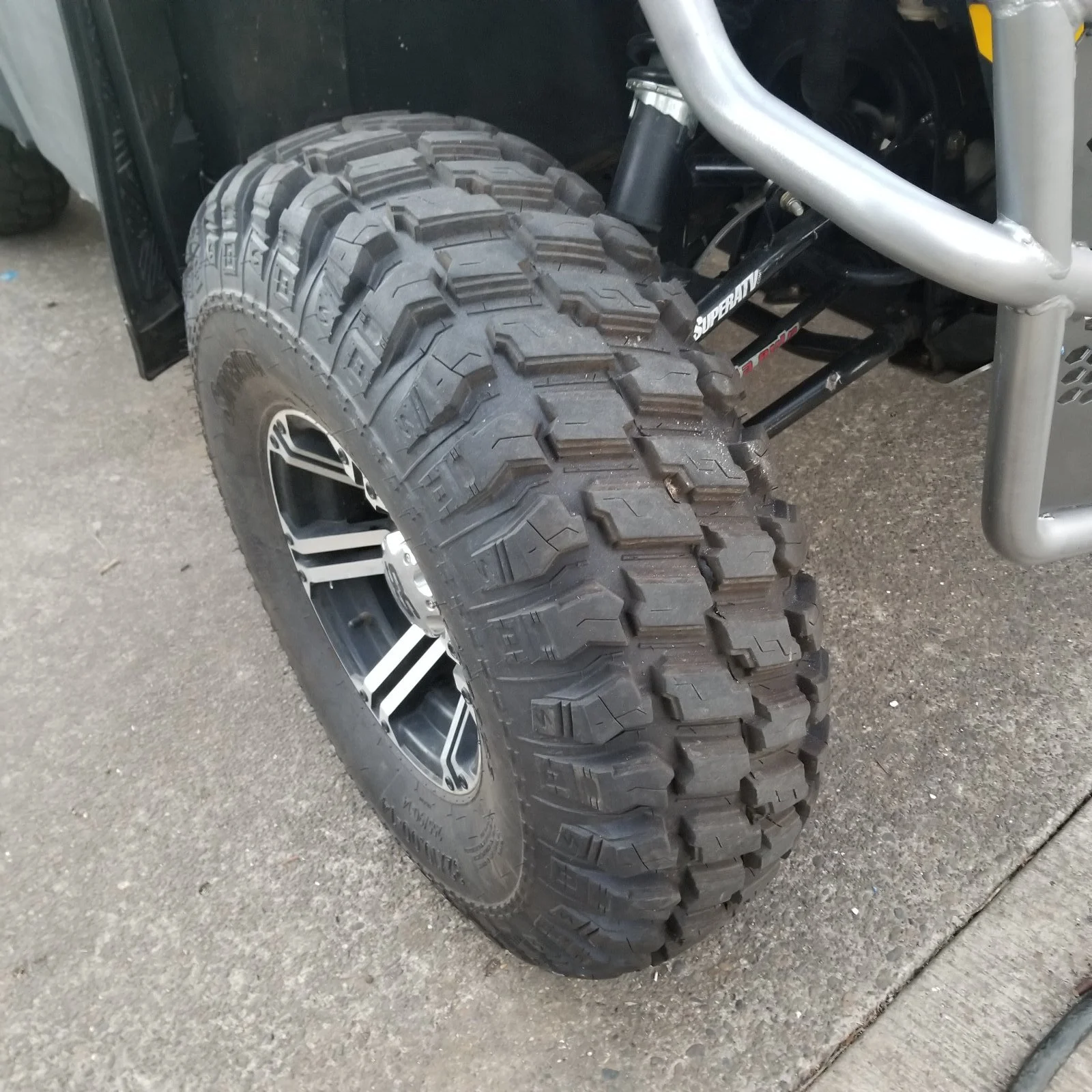

Not sure about a 6x6.... but I put a 2" battle armor lift on my 2019 4x4 and with the addition of 2" forward A-arms I got 32"ers under Bear.... Not sure what the rear wheel spacing will allow, but my A/T Warriors are DOT rated and drive VERY NICE in the mud. With the stepped lug they do well in ALL CONDITIONS...
