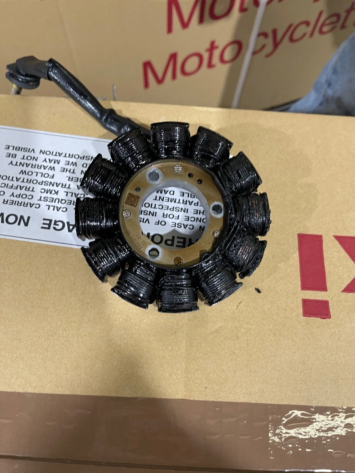

When using the old battery, I put the display on ‘battery’ to determine if it was charging…no dice. Seems the stator not charging the battery.

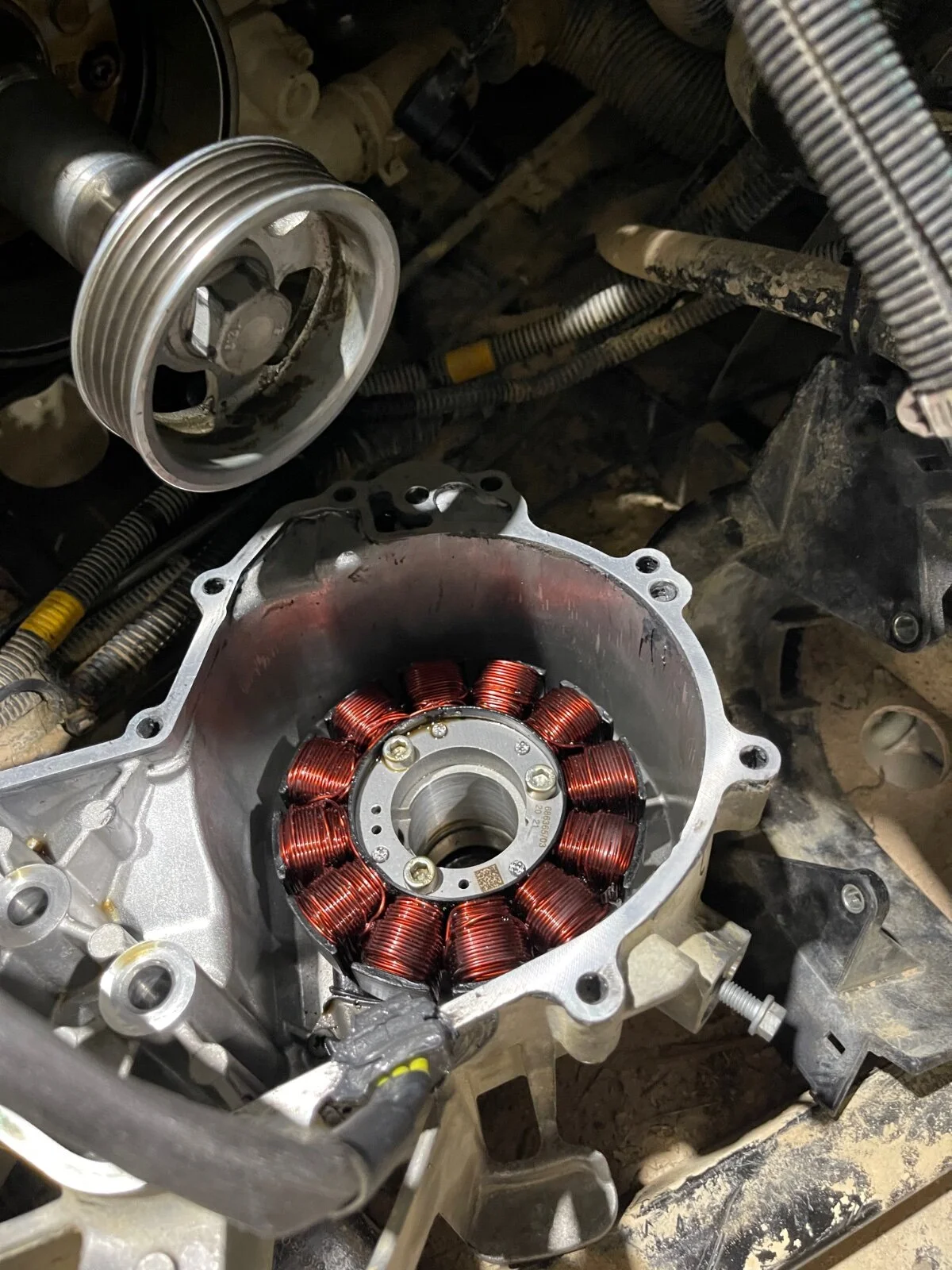

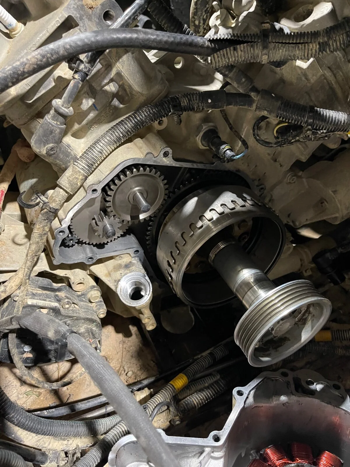

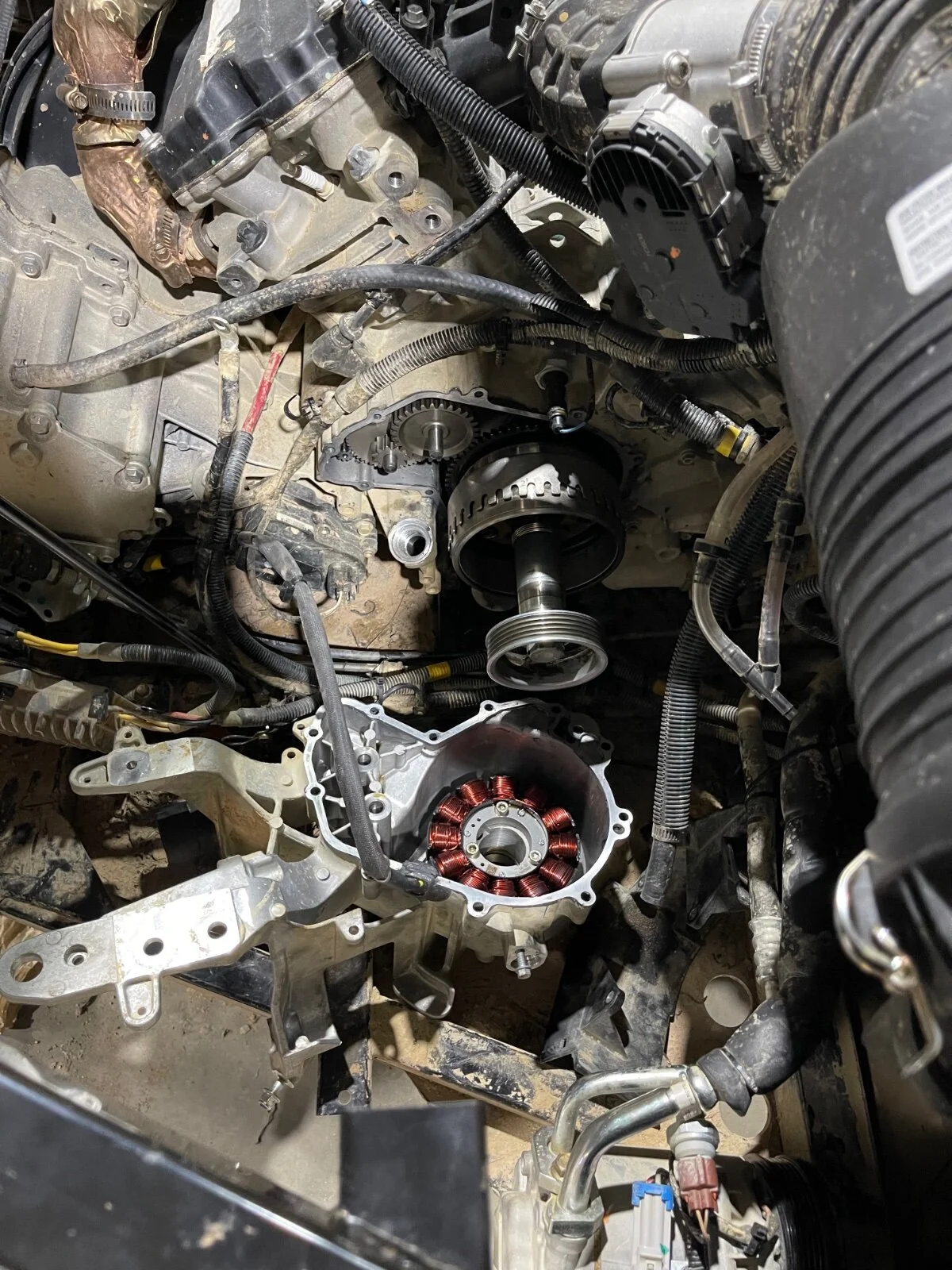

Brought buggy to dealership on Saturday to verify (and for them to troubleshoot) electrical system. Yes, they determined the stator was junk (visibly burnt and smelled) so they ordered a stator. Stator came in a few days later. After they put in the stator, the starter wouldn’t turn over the engine. Quit working…Hmmm. Worked when I brought it in.
They ordered a new starter but Can Am didn’t bless it yet. Shop bench tested and yes, it’s bad. Shop took it apart. It seem the glue came off the starter housing and the magnet jammed the windings/motor. Can Am ok’d the replacement. Shop put in the new starter and everything back together, still won’t start. Really?!?!!!.
I was at shop at every stated milestone above and the tech explained what he was doing (he was also in contact with Can Am support). Now, I wasn’t upset or micro managing, I just wanted to see why I have a 27K (paid cash) boat anchor that only has 383 miles on it. When I came to shop, I brought pizza and breakfast-every one appreciates a thank you like that.
Ok…It’s Saturday now an the new starter won’t turn. More calls to tech line and….bingo. Seems the tech used his normal approach to sealing the case-used Locktite SI 5910. Note
almost all other motorcycle companies use their version of this, i.e. Yamabond, Hondabond) Well, Can Am doesn’t. They use a gasket. So by not using the factory gasket, the tolerance was too tight and the case-when using sealant, will bind the stator shaft.
