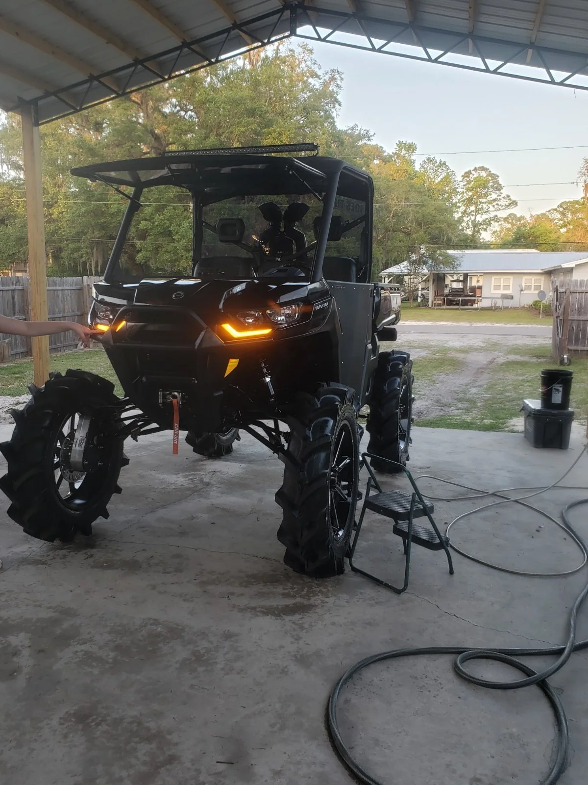

Just ordered some daytime running lights for my 2022 max DPS. Wondering if anyone here as added the DRL to their DPS? Wondering if wiring will be there for plug and play? Also what’s the best way to cut out for the new lights?
thanks
Some of the bumpers has the cut outs for em and some don't. You'll need that bumper for them to mount properly,  headlight adjustments bolt into them as well. My 21 xt didn't have them, but had the cut out for em, simple, unbolt covers, bolt lights in and plug up. Wiring was there on my xt.
