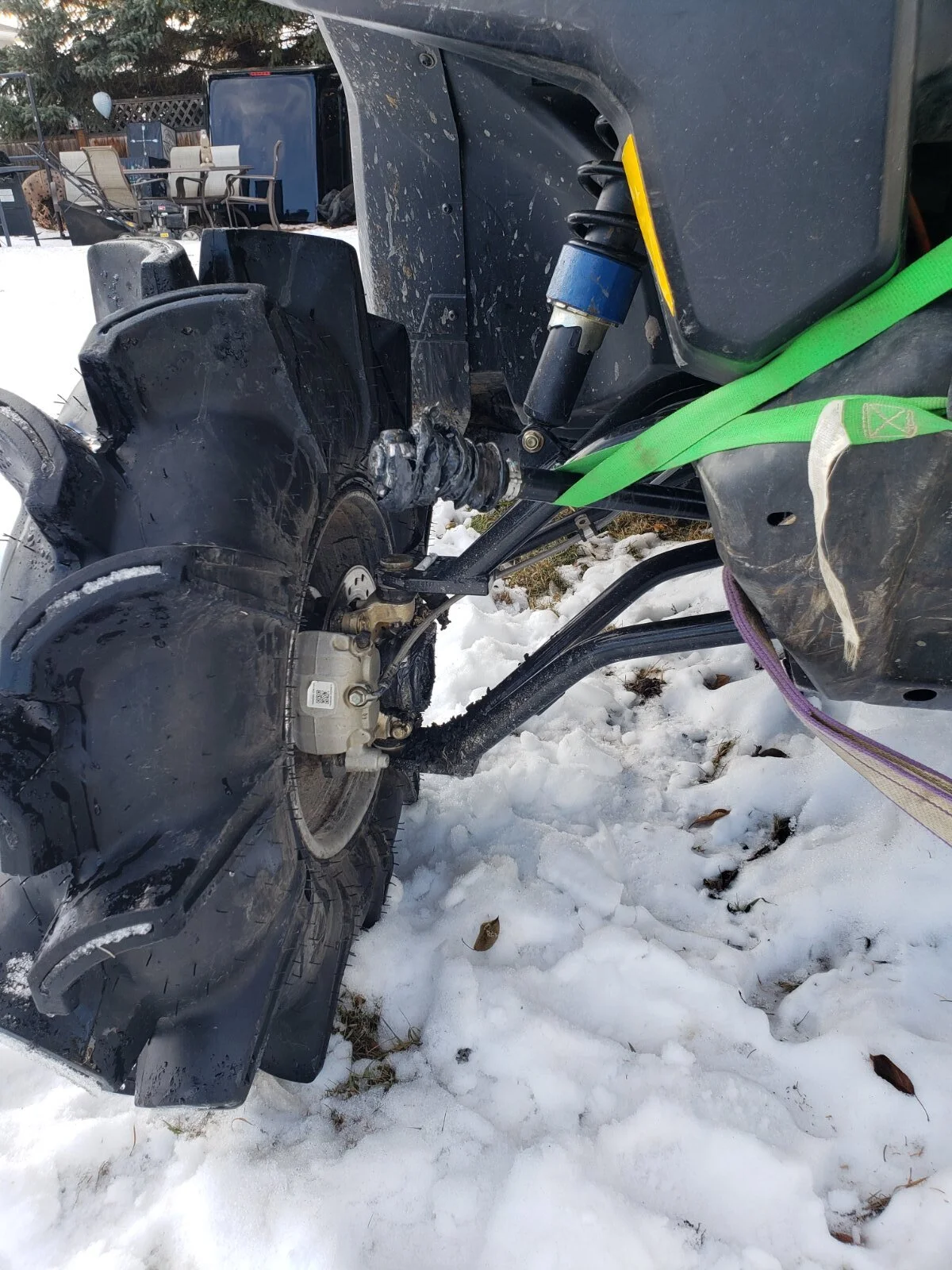

so I put forward offset a arms on my 2017 dps hd10 and now my axles pop apart when I go full lock I heard the xmr had longer axles if so how much longer are they gorilla told me I need to get 3/8" longer axles
The 2019 HD10 Cab XT has different axles than other defenders that might work but I would contact the company you bought the arms from and ask them for their recommendation, hopefully someone like Damon or SATV Rhino 2 will fit without having to go to the expense of the gorillas?😉
The only axles are rhino axles. They are almost 700 bucks each. They have slip cups at both ends, hence the hefty price. I too cannot find any aftermarket axles other then them. I have a 2019 limited, with cab. And even the 2020 2021 models do not have aftermarket axles available, even tho superatv has the forward a arms. No rhino 2.0 axles for the front.
