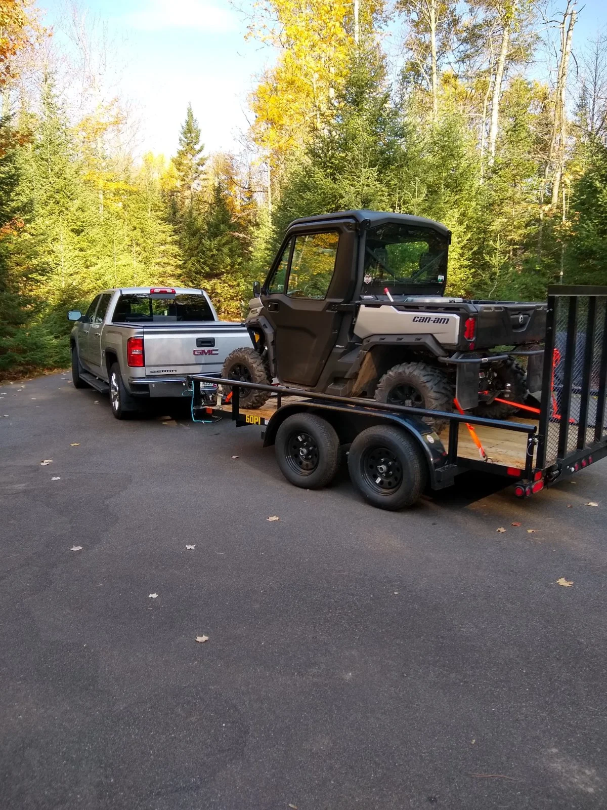

Hello from the Wisconsin Northwoods.
Purchased my 2021 Defender Limited in Oct of 20 Still have my Gator 590 which has been rugged and reliable. I use the machine for yard work and groomed trail riding.
So far so good.  But for 27k I should be more wowed. Not as quiet as I had hoped.  Also a big blind spot to the left caused by the windshield pillar.  The heat gets hot but doesn’t really keep a consistent temperature.  It’s either hot or cold and the only way to regulate it is to turn it off and on.  Had one warm day and used the air for about 10 min. All I can say is that it did work and got cold.
Machine is now in the shop for a recall.  I was told some to] type of programming. Have about 700 miles so I am having all the 1000 mi maintenance done. Oil change etc. Also have power steering issue that needs to be addressed. It binds and when not moving it seem like it won’t turn at all.
And they still owe me front receiver hitch that wasn’t available at the time of delivery. The service tech called and said because of the ac they can’t install the receiver.  Does anyone have a front receiver on your Limited? Did you have to move the winch? Is it oem or aftermarket?
