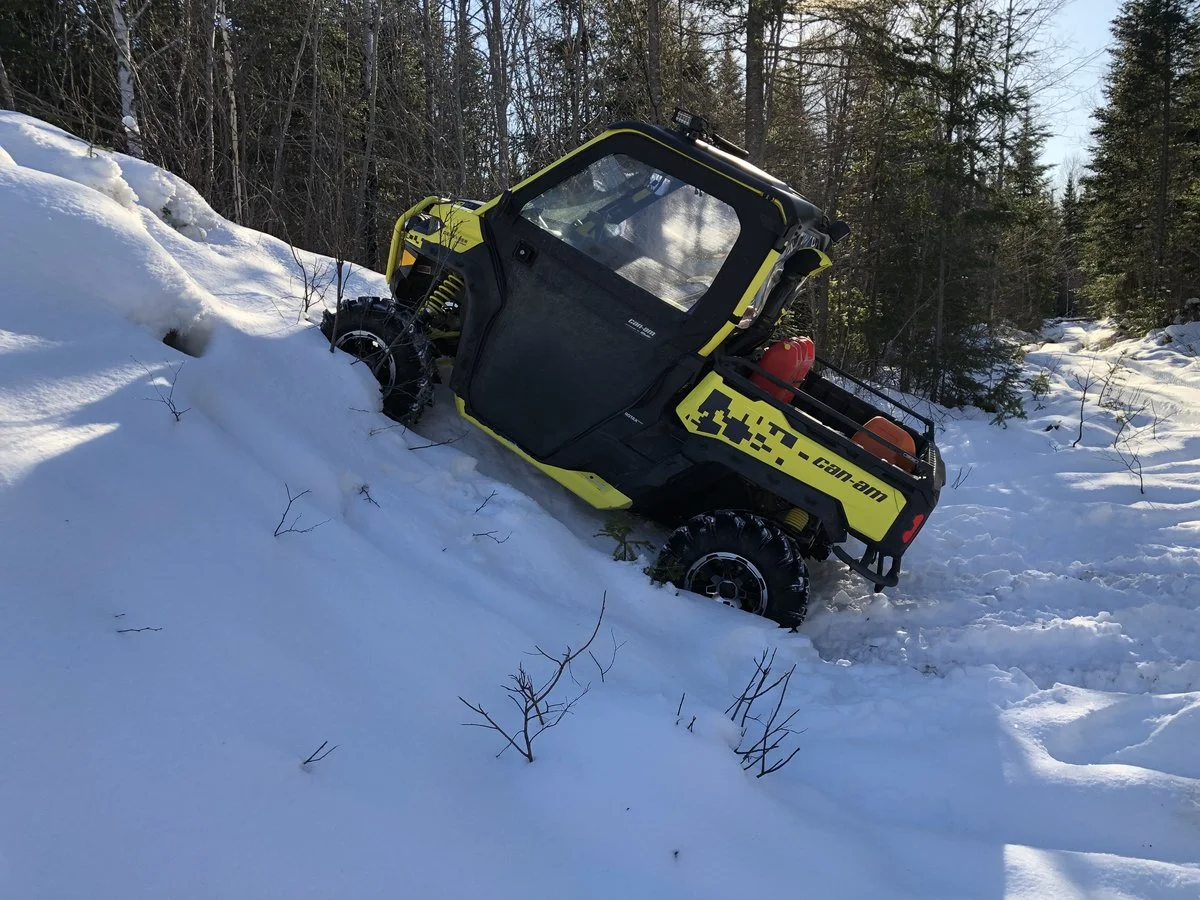

I went out for a ride and half way through the trip I shut the defender off and had lunch.  When I started it back up the Check Engine light was on and a message saying  Check DPS.  My bike is a 2019 HD10 Xmr and it only has about 550 km on it.  The steering was stiff for only a few seconds and then the Check Engine light disappeared along with the message.  It seemed to work fine for the rest of the trip but it sure doesn’t give me a feeling of confidence in this bike.  Especially when I am usually out alone or just with a passenger...no other bikes. It would be a hard walk out of the bush in the snow.  Anybody else have a similar problem with a Defender?
