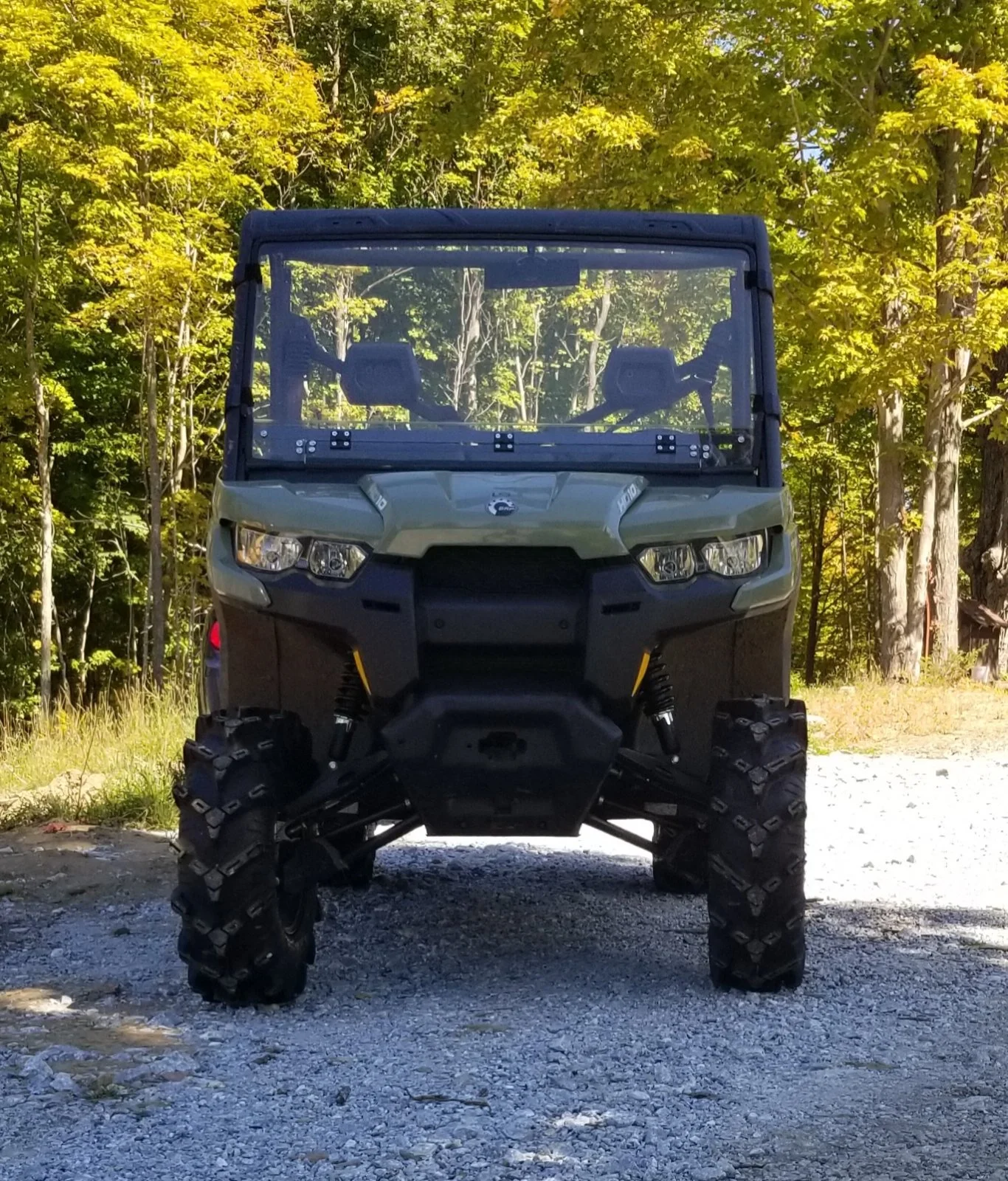

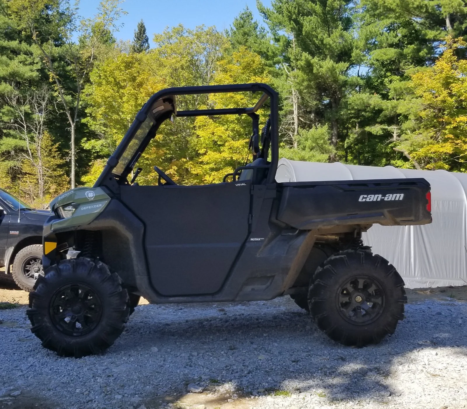

Put the S3 springs on my HD10 I run 30" Cryptids on it with no rubbing. The ride is definitely a bit stiffer but still pretty good.
