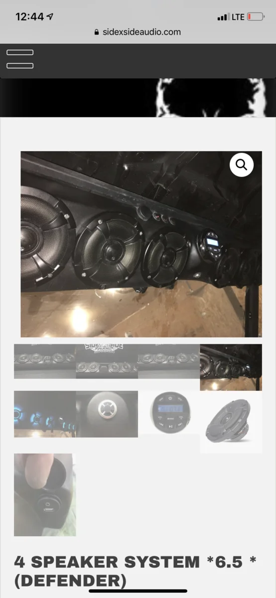

SidexSideAudio also makes some pretty cool stuff, ordered the overhead 4 speaker system with RGB , Bluetooth and such. Ordered it and had it within 2 weeks... also makes a SUB unit and a 6 speaker version
picture attached

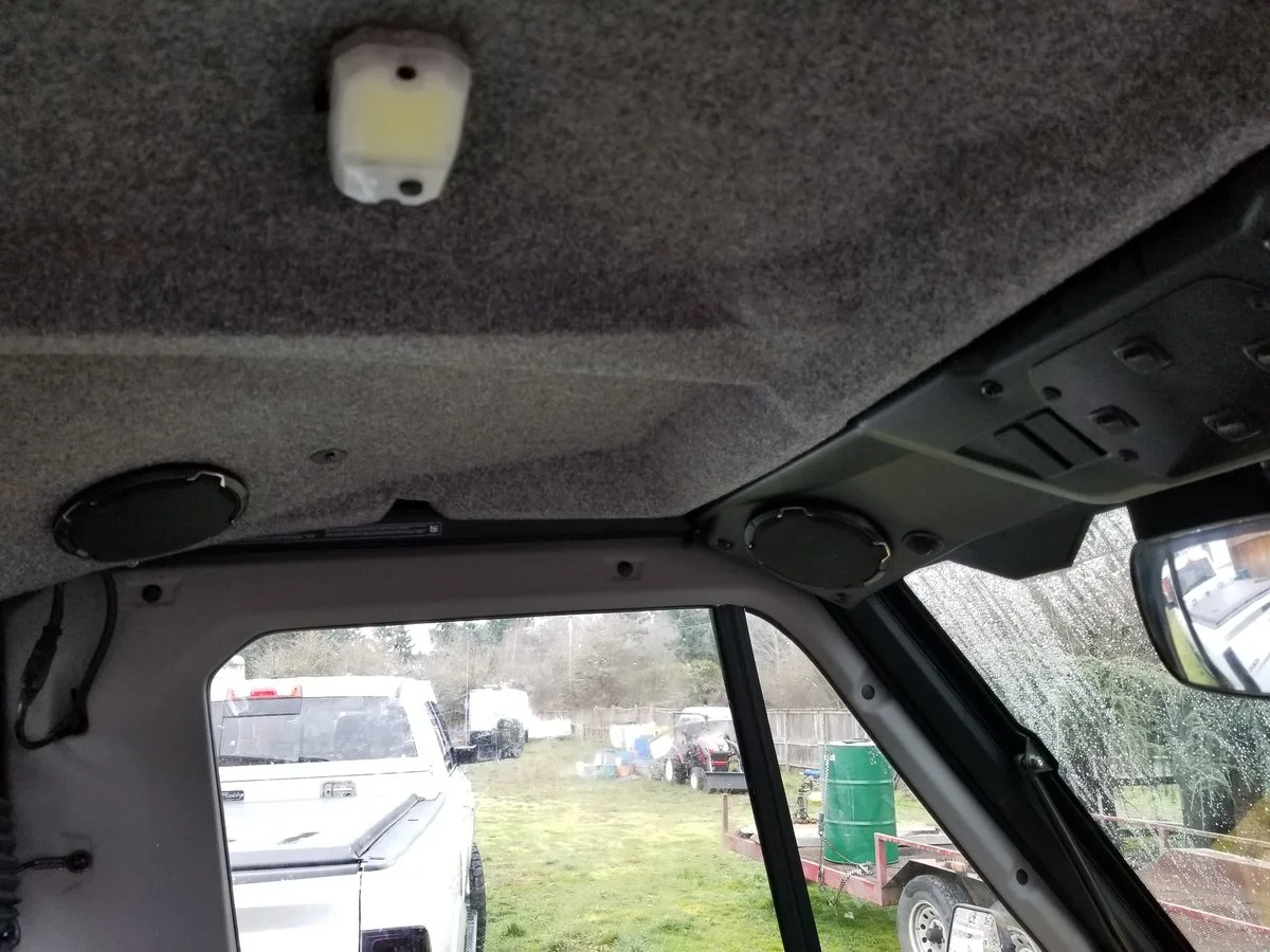

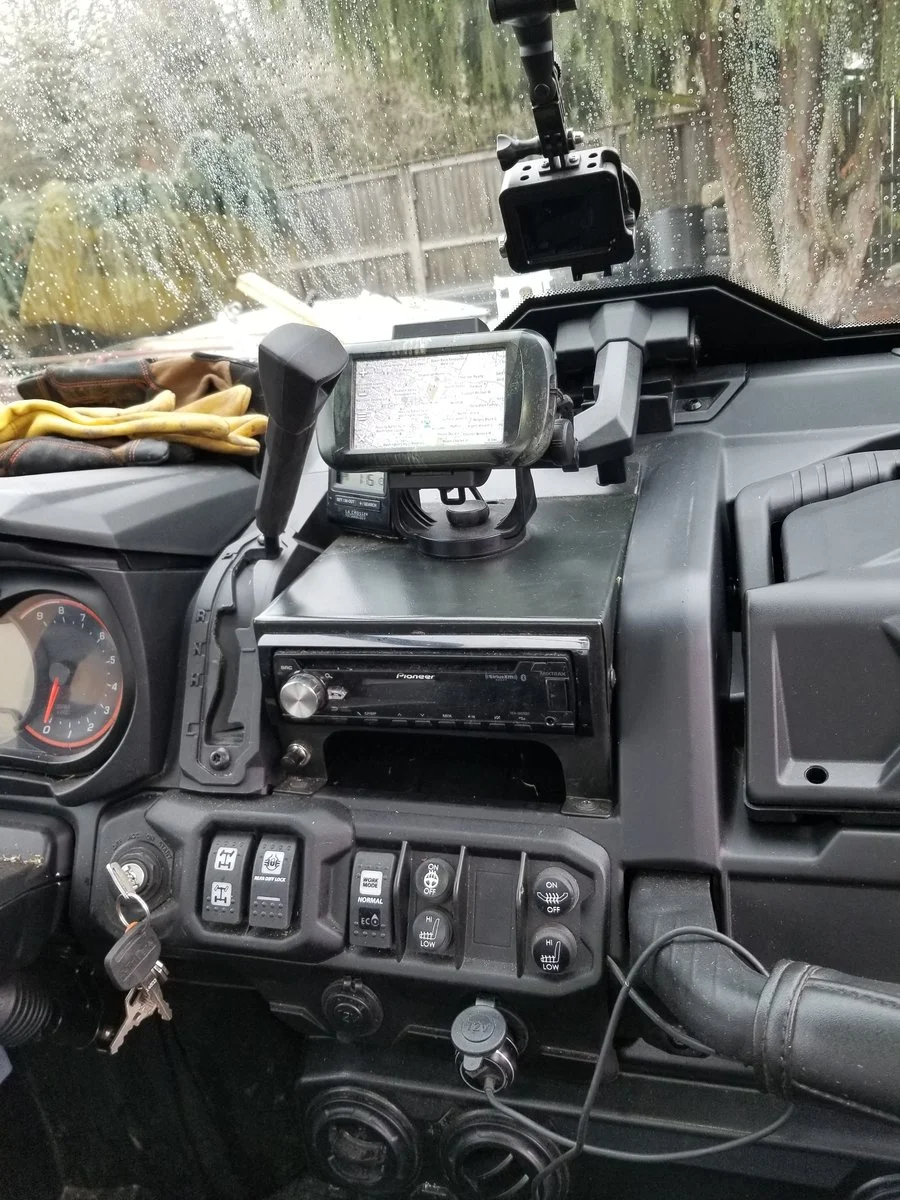

I put a single din in the dash drop just too the side of the shifter. Added 2x 5.25 and tweets in original location. Also put two in the headliner itself. Sounds GREAT!!!!
The button too the lower left is a shutoff switch when I have it stored. I have it wired to a constant hotwire to the auxiliary (30ah) battery setup. But think I may be headed to a group 27. Having issues when stereo, heater/seats/wheel/grab bar, gps, and lights + led bars (4×8" & 1×24") and occasionally 2×18" bars.... after a bit the stereo starts to blink out and the dome light also goes.... going to try and reconfigure the system an see what happens....
