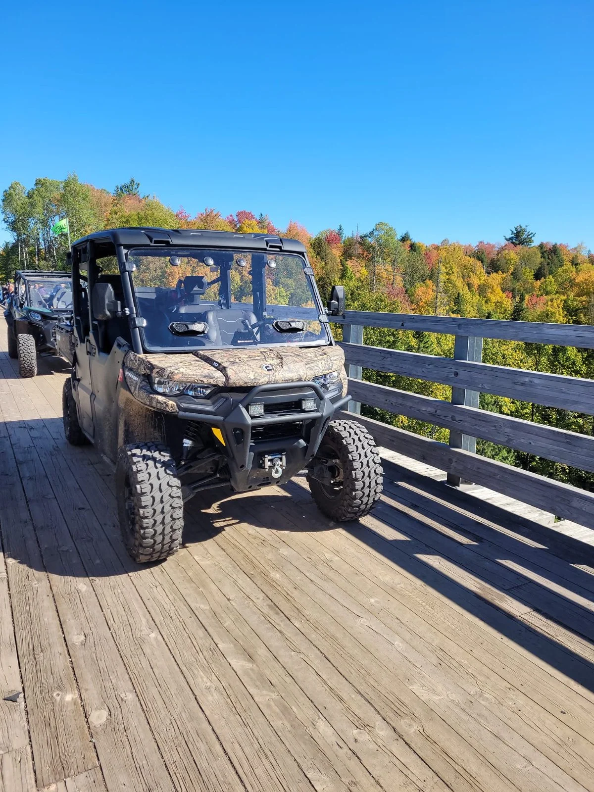

i have a hard coat poly one that is a nice windshield but i added vents and such to help keep air moving through instead of swirling.  it helps but it still sucks dust in behind us.
Honda 400, on the swirling dust behind, do you run a full rear windshield? I’ve had the chance to use the versa shield. Not having a wiper is a pain. Leaning now towards glass tip out. Besides mine got dropped in shipping. Has some corner chipping in it and some gouges. Working with warranty now.
i do run a full rear windshield as well.  it probably helps a little but it still swirls in.  best bet would be a flip that you can open any time you can.
i have 4 round 2" vents evenly spaced across the top and 2 larger kemimoto vents on the bottom that are centered with the driver and passenger seats and still get some dust.  nothing except a full sealed cab with an air conditioner or heater will keep enough pressure in it to keep it from sucking dirt in but so far, the more vents the better.  the flip will be my next one if something happens to my poly.  get an electric one, then you can adjust in as high as you want.
