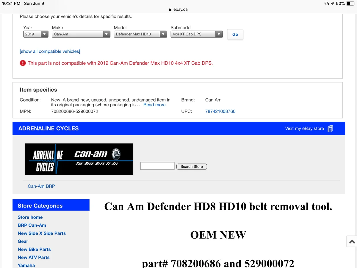

Hi,
 I checked those two part numbers on eBay and they say it don’t fit a 2019 Defender H10 Max Cab XT ?
Any idea why it might be different than 2016 ?  Did Can am change the secondary clutch ?
Thanks
TB
Found out why it don’t fit . You need 708200686  & 529036352
