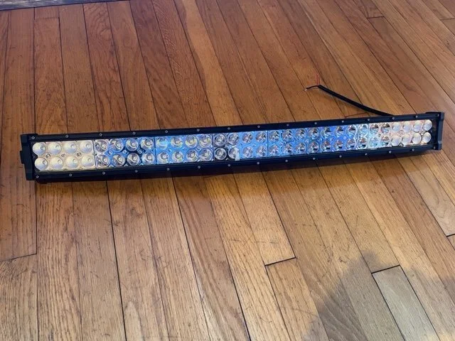

I just received two of these by FEDEX from Walmart:
YITAMOTOR 32INCH 420W LED LIGHT BAR Spot Flood Combo Fits Ford Offroad Truck SUV ATV 30"in
They were $22 each, free shipping to NH.

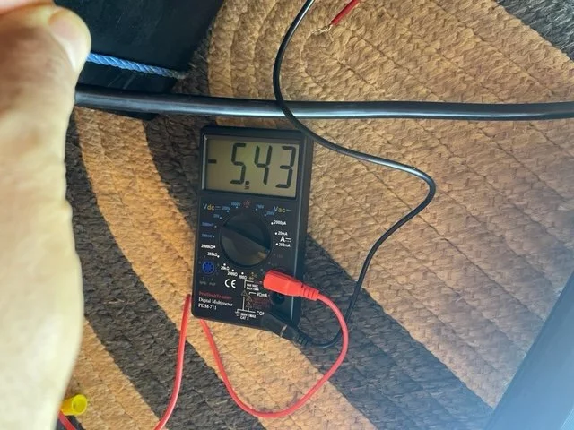

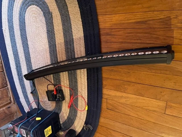

In order to select the correct wire gauge and fuse, I needed to know the actual amp draw. I thought that I would share this info in case someone wanted a cheap light bar and wouldn't need to do the amp test for themselves.
Advertised Capability: 420W Halogen = 5400 lumens
Test Results:
Battery Level: 12.21V
Draw Amps: 5.43A
Implied Watts: 65W
Conclusion:
65W LED = 5850 lumens
I used this "watts to lumens" calculator.
