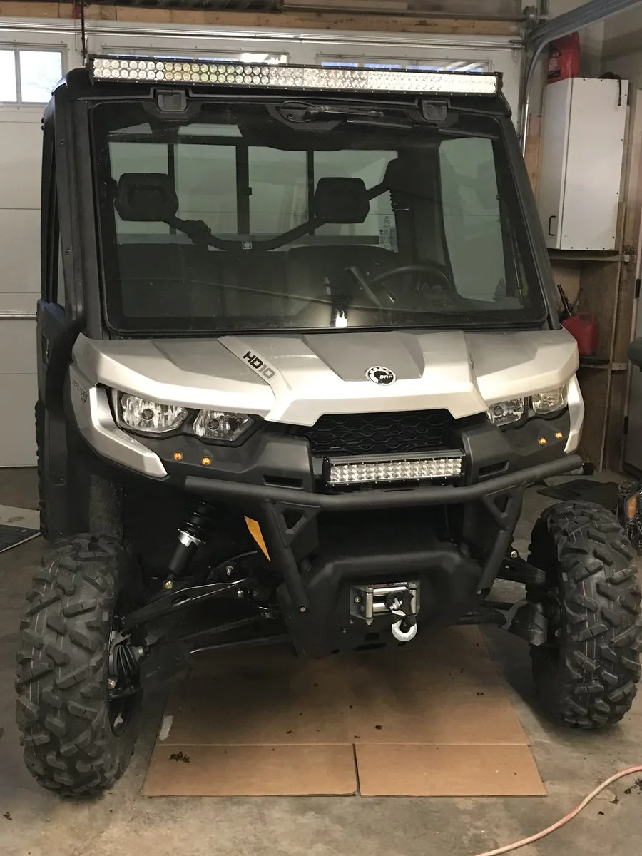

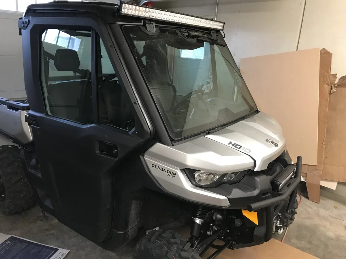

This 52” light bar had a 90 degree angle bracket and worked to dril through plastic roof and through metal cross member. Used rubber grommet/gasket that came with light to seal. Turn the bracket under light bar to hide bolt.

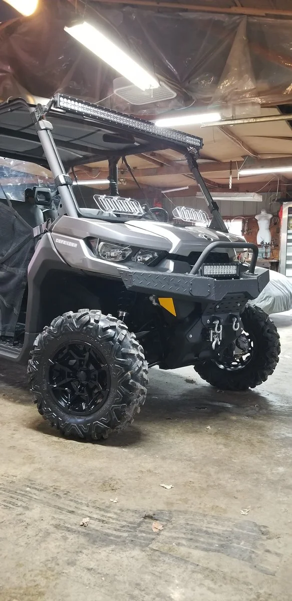

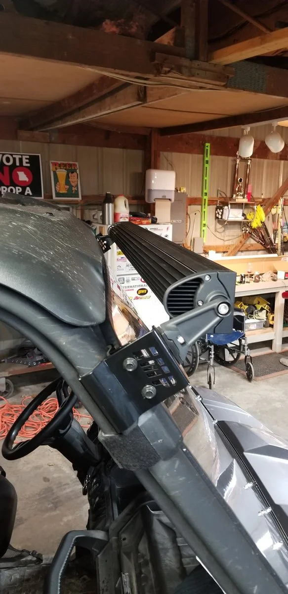

If u havent bought it yet a 50 or 52" will have more bracket options for just above the windsheild ... I couldn't get my self to drill into my roll bar for a pop rivet bracket... so I did some looking around and found EMP squeeze light bar brackets for a polaris profit cage .. I had a hunch that it would work on the defenders so i drove mine to my cousins who has a ranger xp900 crew inspected both cages side buy side and ordered them off ebay for about 55 bucks it works awesome if I want to take it off I can and never have to worry about holes in the 500 dollar roof or cage ! It just squeezes the roll cage and utilizes the light bar brackets that come with ur light and if u have a windshield it slides right down next to it ... I mounted mine as high
as I could get it in the windshield indention of the defender pro fit cage and it works awesome rock solid for sure

  Thank you so much. I’m new to the forums and new to cam-am but them brackets you posted will work perfectly for my needs. Like you, I didn’t want to drill holes just yet on my new 2019 defender max xt just yet.;) may I ask what size light bar you can use with these? I wanted to use a 52” curved but open to suggestions. Thanks!
Any confirmation on what size (50 or 52 inch) light bar to use with those brackets?
