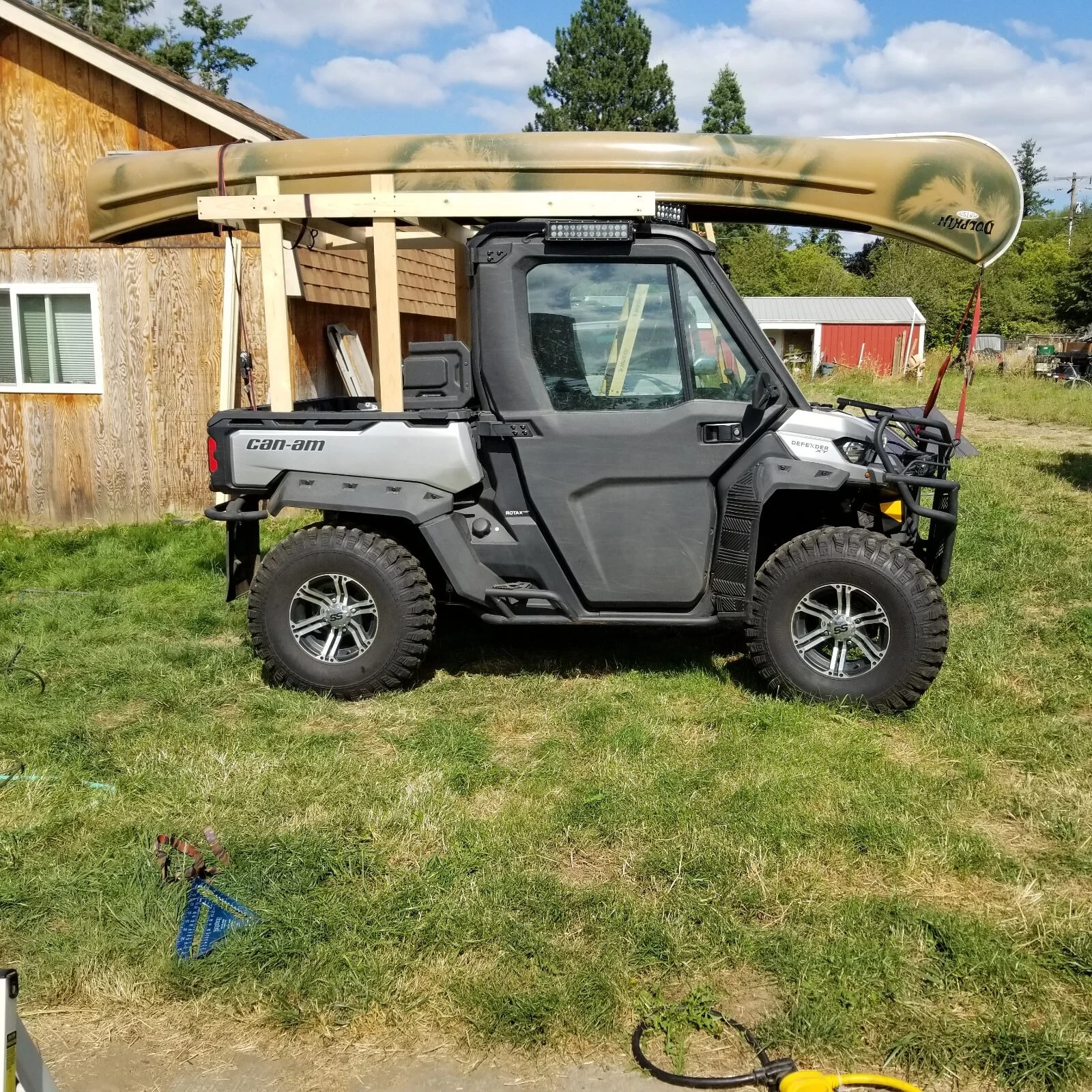

This is Bear with his mach up lumber rack. I welded up a tube rack now... made it out of cyclone fence piping. Chopped up a gate for the radius corners and welded it together. Held down with the anchors that came with the game winch kit...

Great looking rig. I’ve seen a number of attachments and racks made by owners here. Maybe on top of hunting, fishing, riding etc, I’ll need to take up welding!
