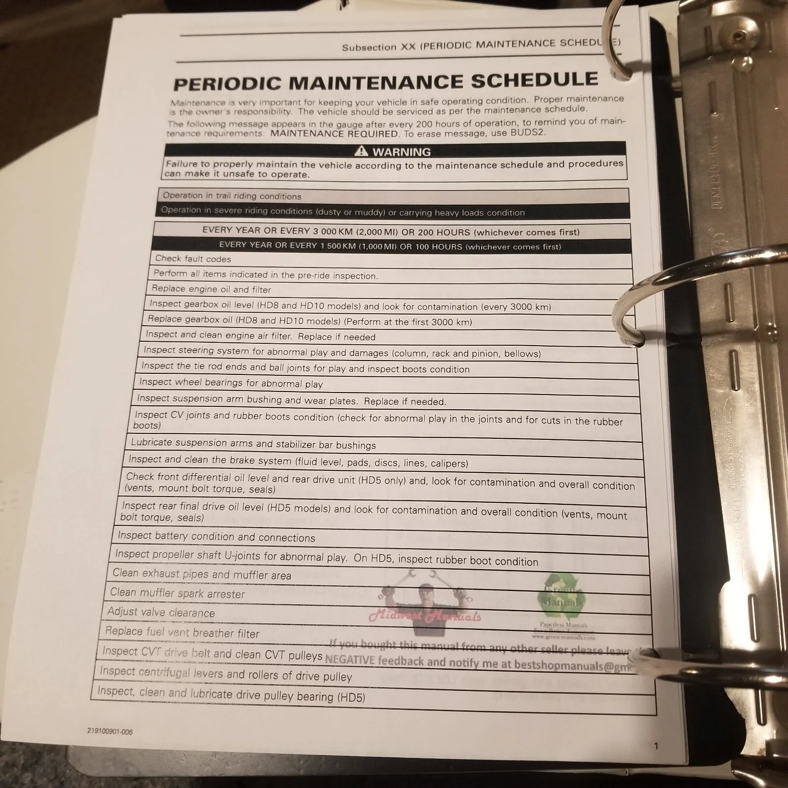

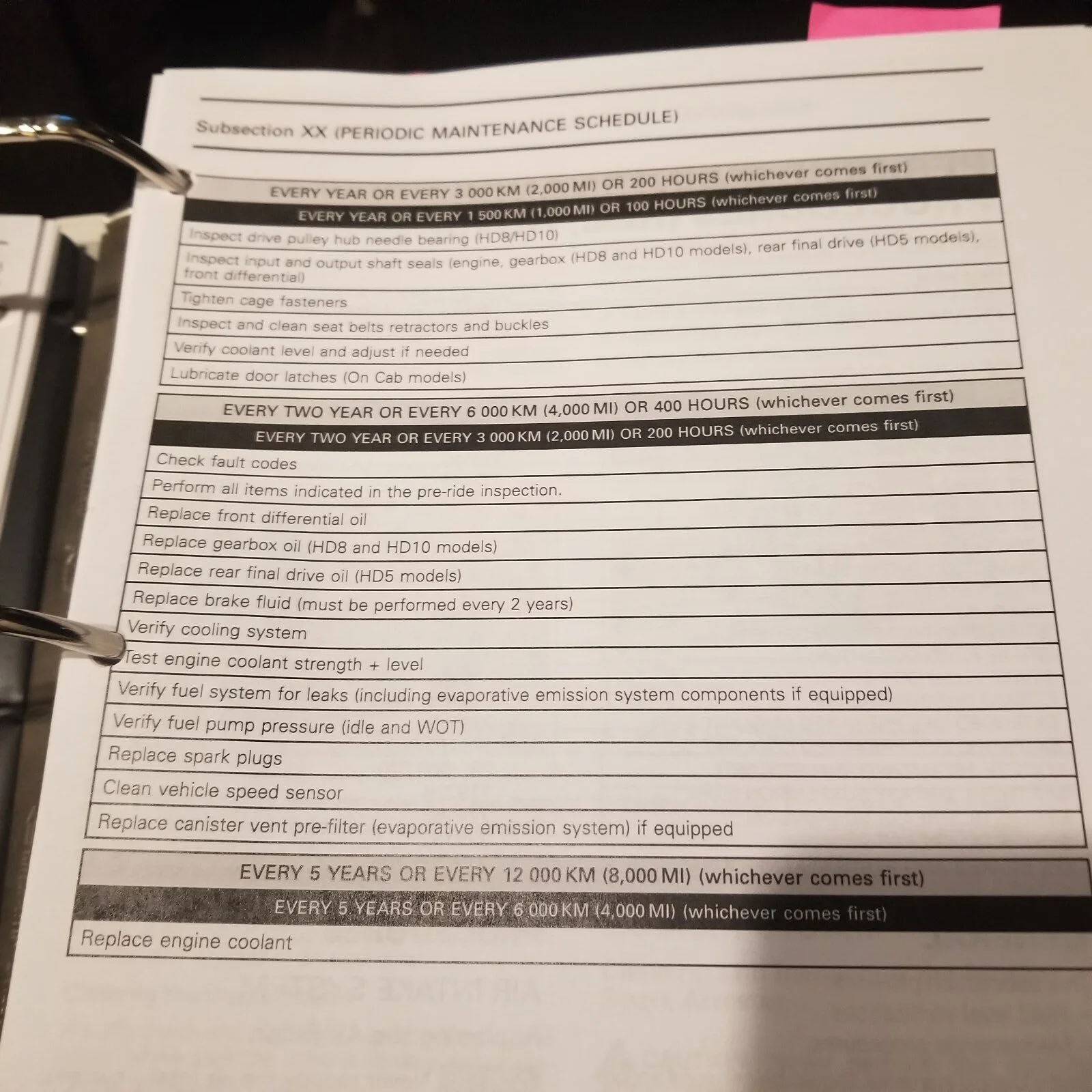

These are out of the 2019 defender shop/service manual. Hope this sheds some light on your situation.
Joe
The diffs are not run dry, Front is 14oz. 75W-90 and Rear on HD8 and HD10 is 1.5 quarts of 75w-140.
